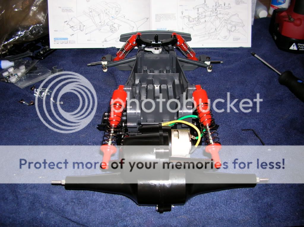

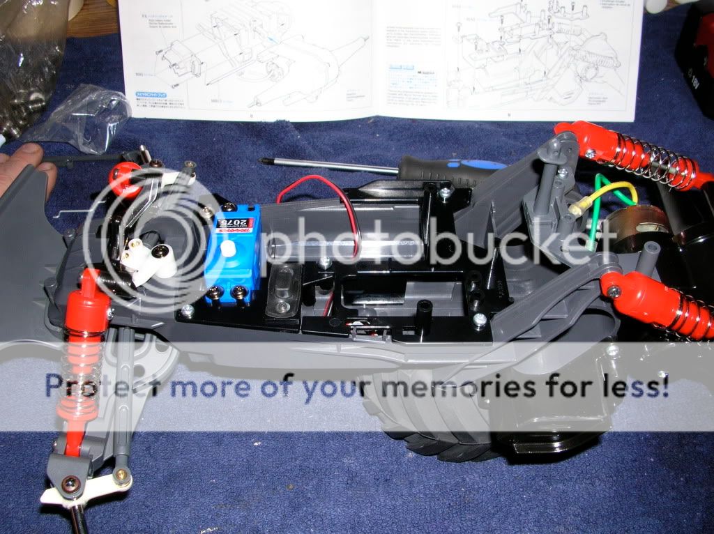

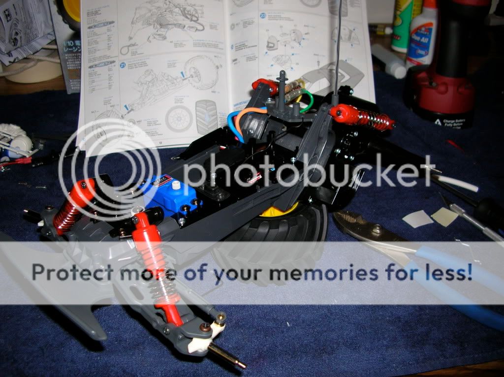

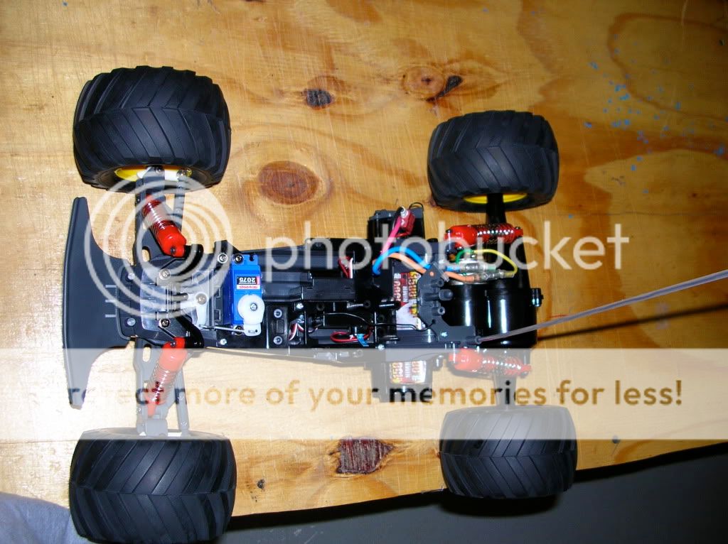

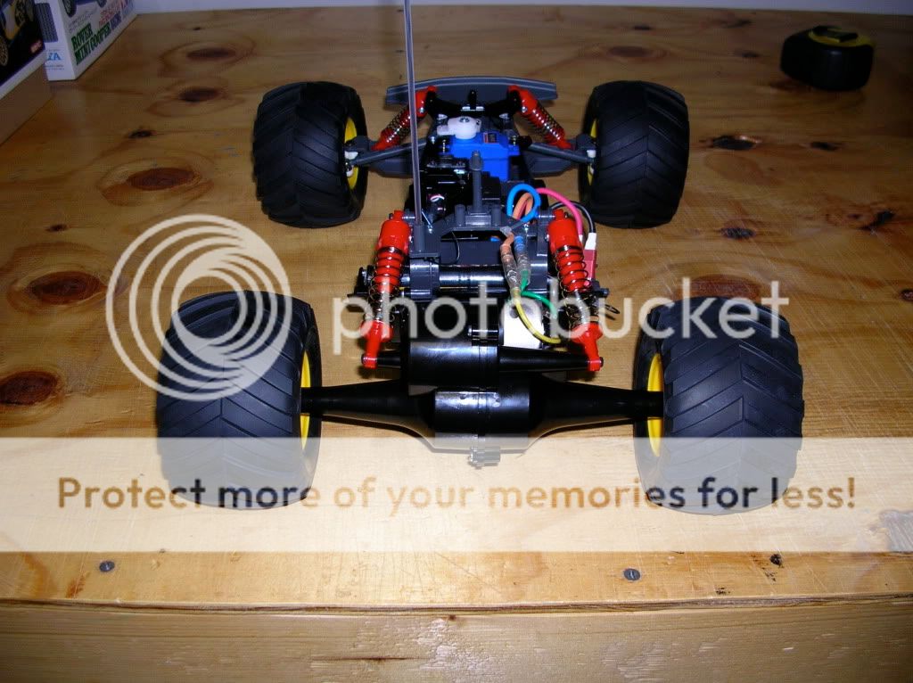

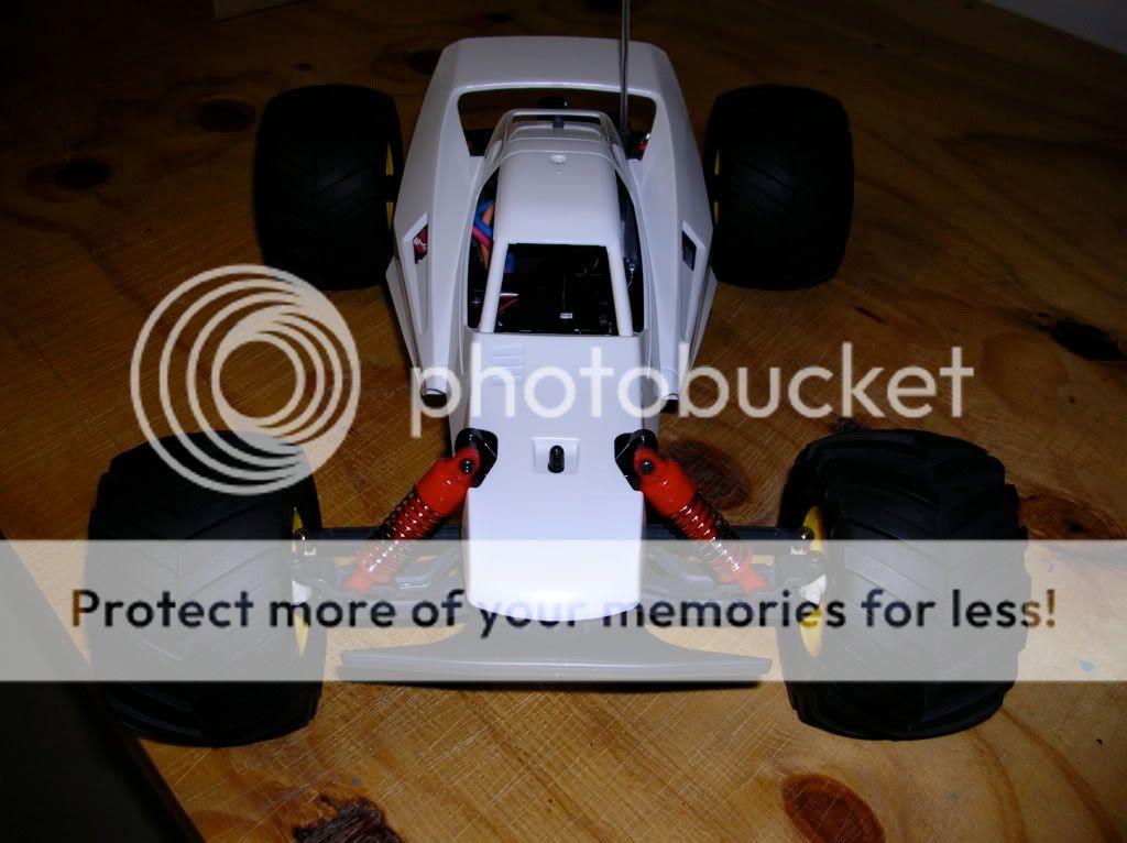

Well guys we're getting pretty close to the end of this build. Like I said from the beginning there's just not many parts to this kit. Last night we made it through the end of the build and all that's really left is putting on the decals.
Here's what we did last night.
We picked up the build with attaching the rear shocks to the chassis. Like the fronts these are simply held on with 4 shoulder screws. The screw holes for the shocks are a little larger than they should be and it allows the shock to flop around on the screw. Also, like the fronts I tried to avoid using grease on the shock shafts and hoped the shocks would move freely. This does not happen. Without grease on the shaft the entire rearend binds up and sticks. Once greased they move pretty well and seem to work even at the odd angle.
In this pic you'll see the rear body mount attached along with all of the servo trays etc. It's clear that this model was designed for a second servo and MSC and they changed nothing when they switched to the ESC. I had to use all 3 pieces becise of the way they screw together. I'll need to find a better way of holding to steering servo in place so I can get rid of these trays and mount the electronics lower in the chassis later. Also note the Traxxas 2075 waterproof servo. Just a hint of what i'm planning for later.

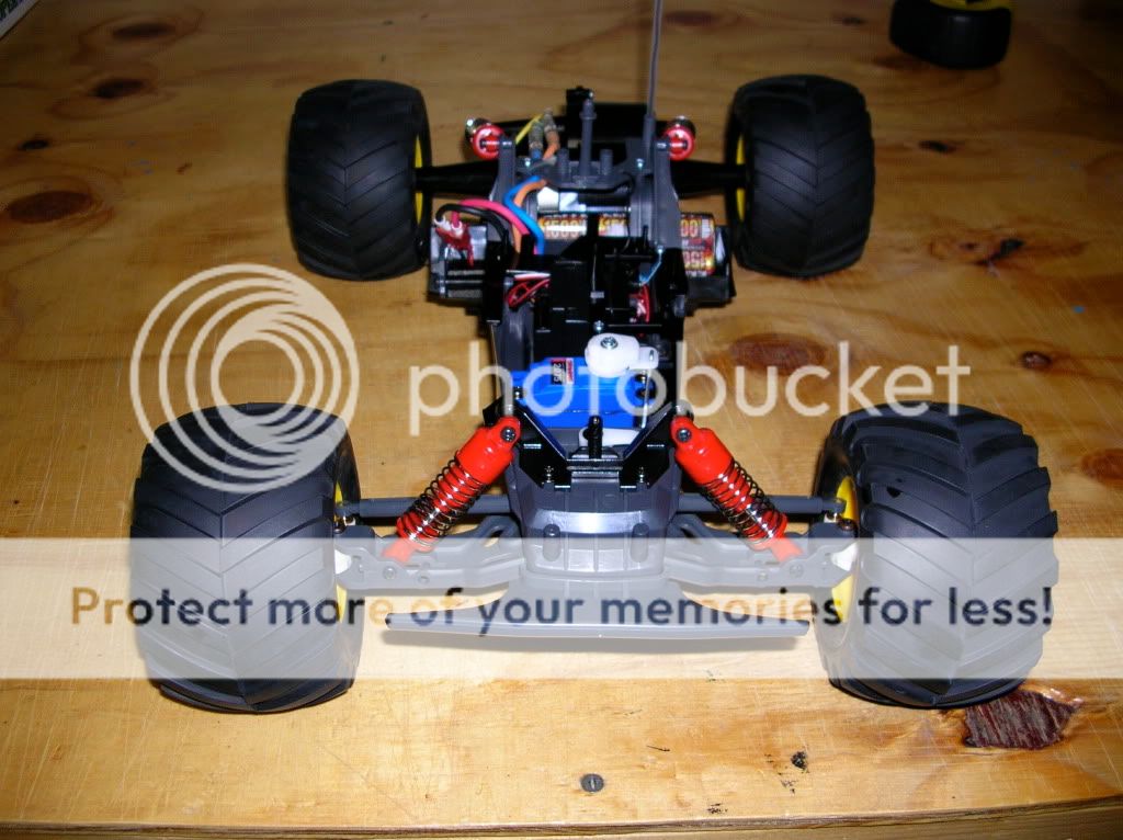

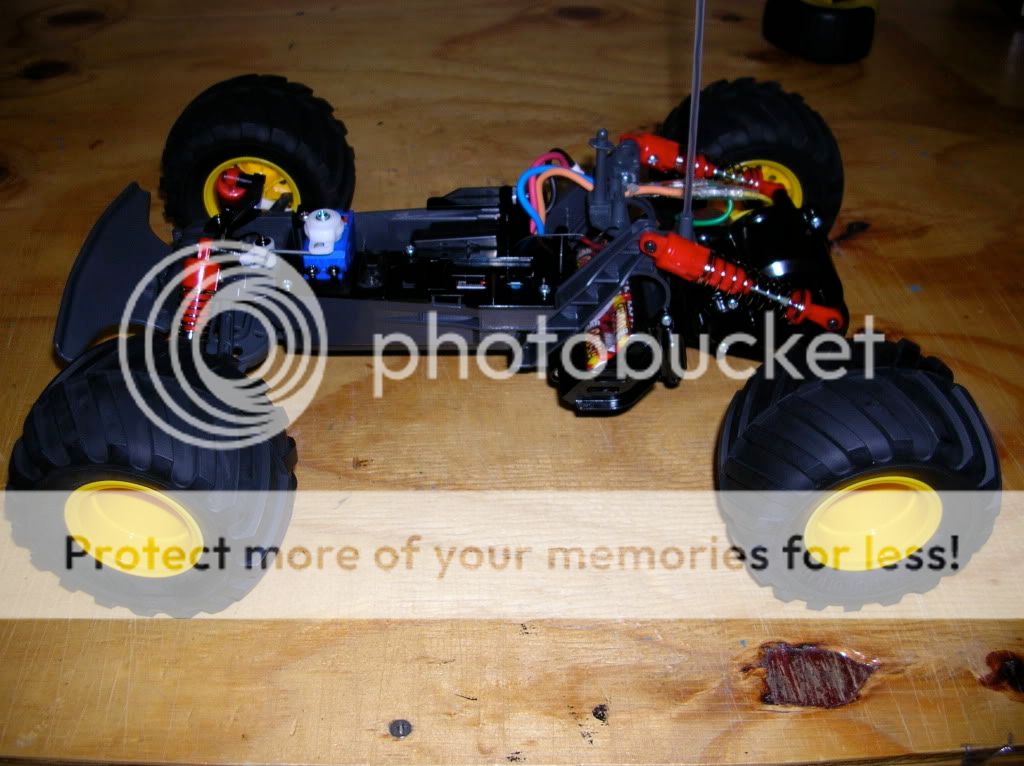

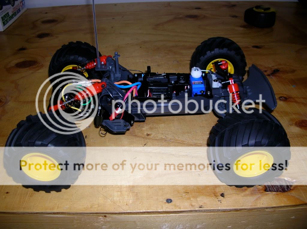

Next was installing the ESC and receiver. For now it has the stock Tamiya ESC and depending on what motor I go with later it may or may not stay. I'm using a traxxas mini receiver and radio for control. You'll notice that the ESC is completely out of site and only a small of the receiver can be seen. I have it all buried down in the chassis.
You all know what comes next right!!! Wheels and tires!!!! we're getting close. In this step the servo saver and steering rod are attached as well. I don't think i've ever seen that many bends in a single piece of wire!!! BTW the slop in the steering system is horrendous!!!! I can move the tires left to right about and inch without moving the servo. this will need to be dealt with ASAP.
Well that's it for the assembly. All that's left is paint and decals and a test drive. Here are some pics for ya!!!

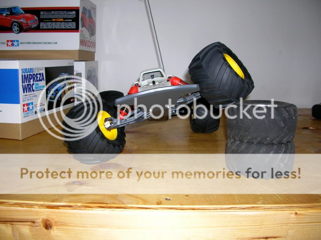

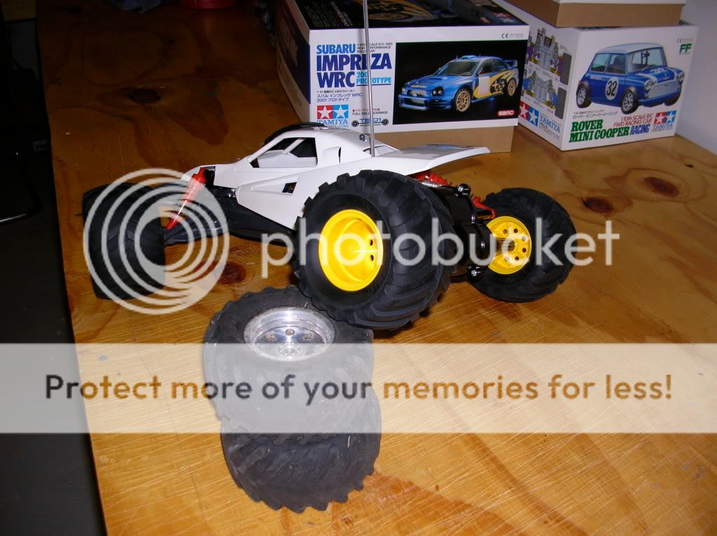

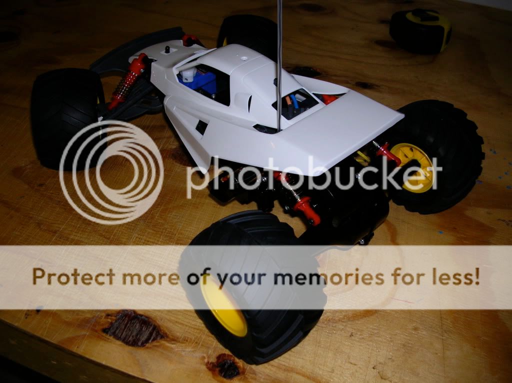

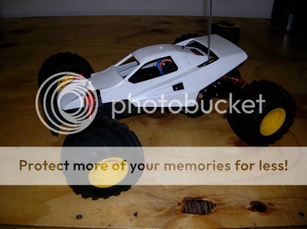

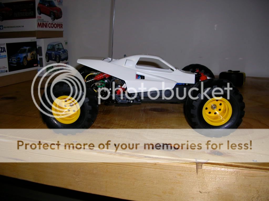

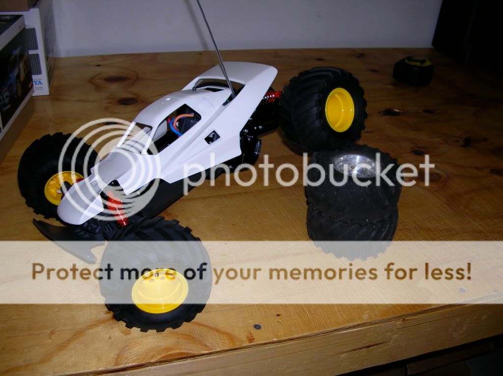

Here are some pics with the body in place along with a couple of flex shots.
Notice the amount of flex in the suspension. This is mostly due to the rear axles attachment design that allows the rearend to roll. Very nice setup..
Painted body pics and a test drive to come. Need to get a video camera to shoot this. Anyone near chicago wanna meet and shoot some video for me?

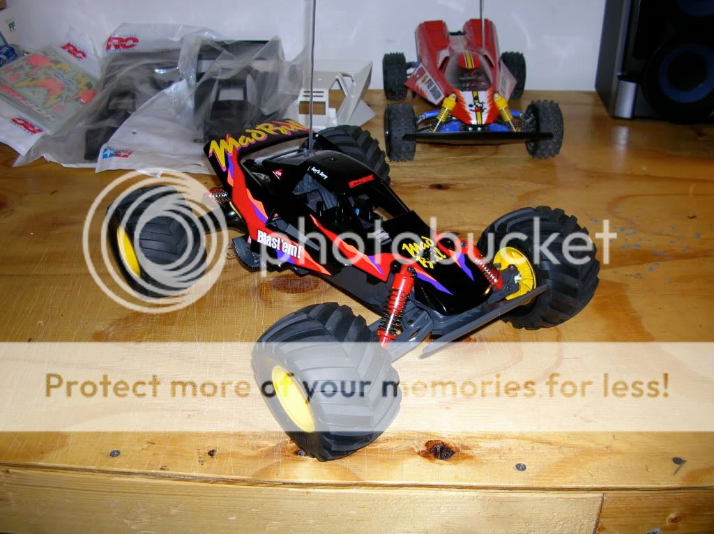

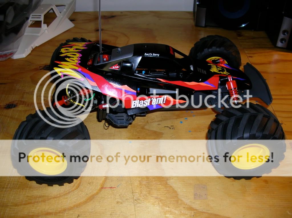

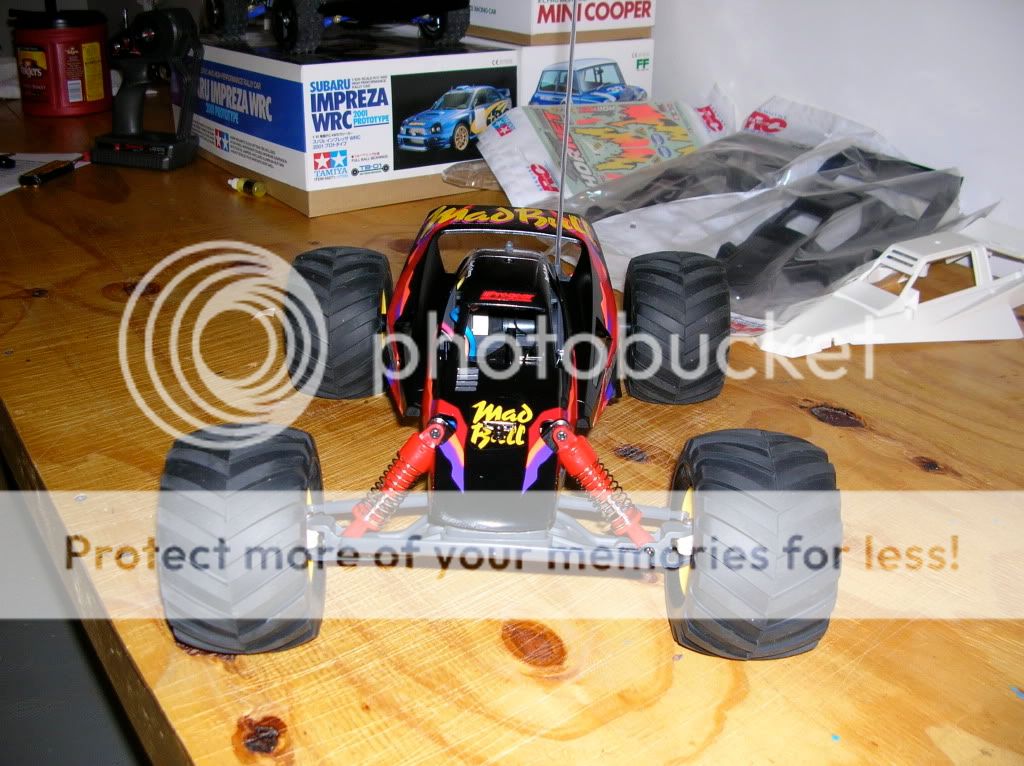

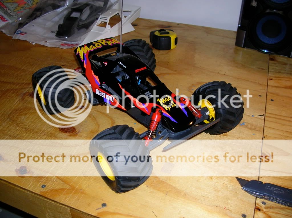

Location: ABC WORLD, IL
Posts: 2,559
Default RE: TAMIYA MADBULL INFORMATION AND BUILD THREAD **THE BUILD HAS BEGUN**

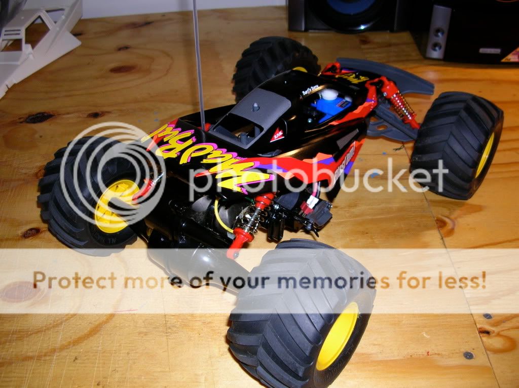

We managed to get the body painted and decals applied. Just a simple Black paint job. I still have to so the roll cage bars in Silver and put a few coats of clear on it but overall I thing it looks pretty good..
Here are some pics for you guys. I'd take it out for a spin but it's raining like Hell here right now.
