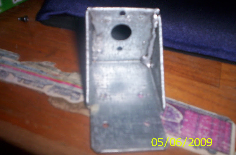

instead of using that motor mount, make a L shape motor mount. That way you have more options in terms of gear mesh and different motors.

couldn't you also make a mount plate that would take advantage of the existing nitro motor slots, lots of adjust-ability there

yup, thats what samgaun was saying about the L-bracket, something like this???
for my E chaos big enuf for a 540, mounts into the stock holes, i also mounted it, and soldered a nut onto the base so that i could just screw into it and now worry about having to hold a nut inplace
