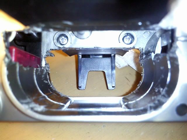

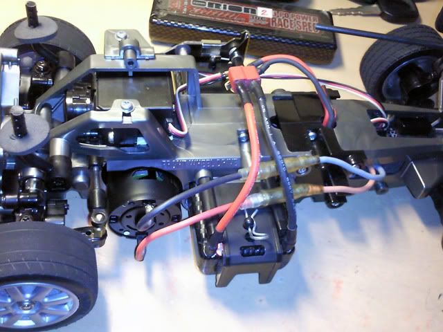

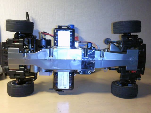

Went to the LHS today and picked up a set of A-parts. I only have one stick pack size lipo, so I figured, instead of buying another why not get a spare chassis and hack it up so I can use my existing lipos
View of the hacked battery slot. you can see the ESC mounted on the L wheelbase extension

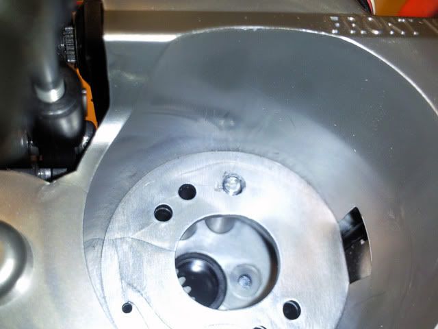

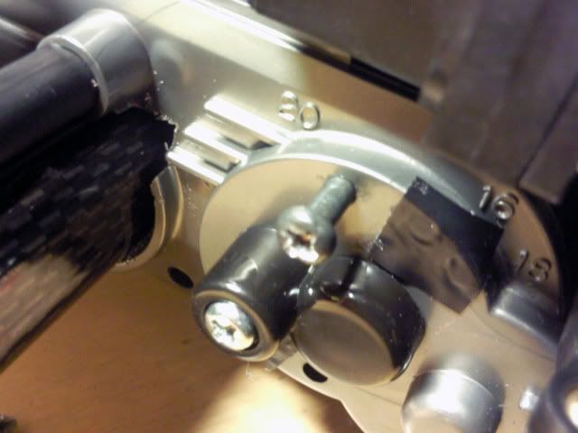

Ran into a problem with one of the motor screws. It wouldn't go all the way in. This is the first time I encountered something like this in a Tamiya
Had to enlarge the hole for the screw to go all the way in
Also had to switch back to the stock battery holder on one side to make room for the wires
View of the underside

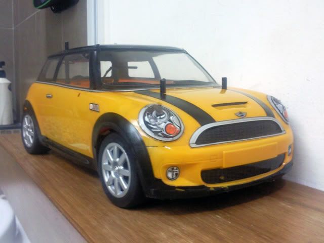

Also cleaned up the body. Ready for another day at the track

The screw on the motor.. that's weird.. never seen that before.. I did not have problem like that when I was building my M-03!

Yeah I didn't have a problem with it too when I built it with the black chassis that came with the kit. Not sure if all the grey A parts are like this, or if I just got a bad batch

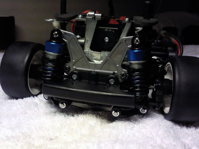

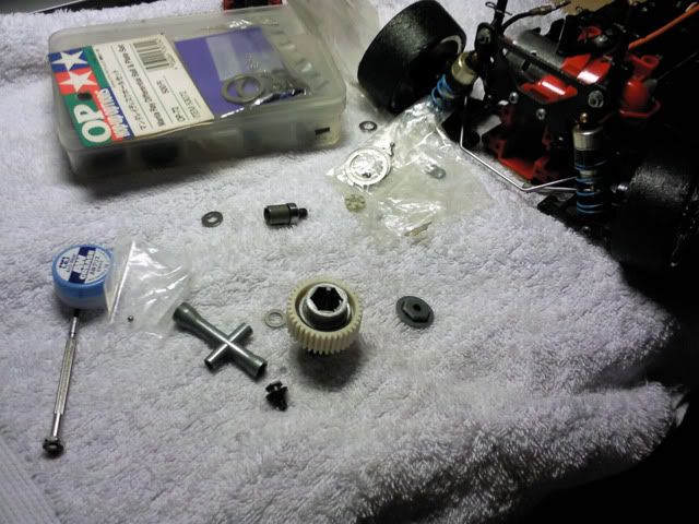

Couple of updates over the weekend.. Took the manta ray diff from my TA02 and rebuilt it with new balls and plates. Used AW grease and screwed it on tight. Installed it in the M03 and off to the track I went. Wow! Car drives so much better with the ball diff. Steering felt better, and the mini exited the turns quicker [8D]

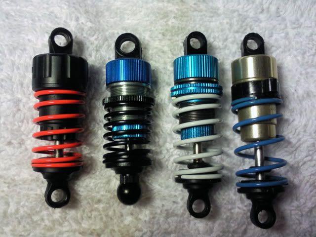

Was still struggling with traction roll though, so today I went to a couple of hobby shops to do some shopping Picked up a set of 3Racing shocks. Would've wanted the TRF ones, but the LHS wants $65 for it. For a mere $21 for the 3Racing, I had to try it Also picked up a 3Racing High Torque servo saver and TL01 Stainless Steel Suspension shafts. The shafts won't make the car go any faster or handle better, but it was cheap so I thought why not?

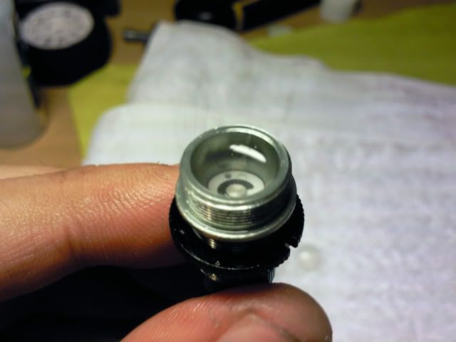

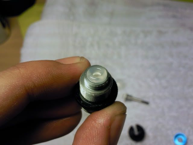

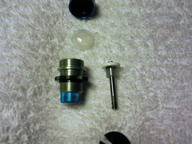

Disassembled the shock, and slipped on 5mm of rubber tubing to reduce the shock length
View of the inside
and the bottom
Filled with some silicone oil
Comparison between CVA Mini II shocks, TRF 42102 and TA03 Super Low Friction. The 3Racing ones are actually pretty good. Build quality is not on par with TRF, but the damping action was just as smooth.
Finally installed. Next up would be to get a set of tuned short springs, M03 aluminum servo horn, and finally the universals. These are still out of stock at the LHS, might have to order online. Then I think that's it!

Interesting that you find the ball diff to be better.. it would make sense but I have read people who prefer the gear diff.. I guess it depends on the person, eh?!

I just read that some racers actually prefer the gear diff, that's all.. I have not tried the ball diff myself, so I can't comment.. but just saying that it seems to be like a personal preference thing...
