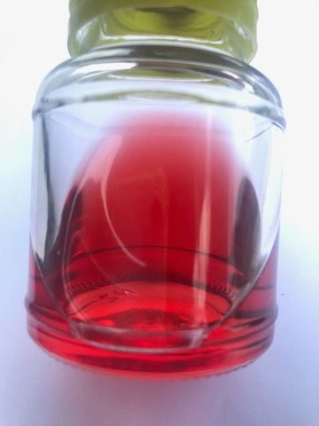

Yup, I always use after run oil (air tool oil) after every flying session. I checked my old stock of Klotz Benol, about ten years old, and it seems like the color and smell are still normal and no sedimentation at all. They were stored in a cool place. Do you think its ok to use? I know that medical castor oil can go rancid but I suppose that the Klotz Benol has been chemically stabilized.
