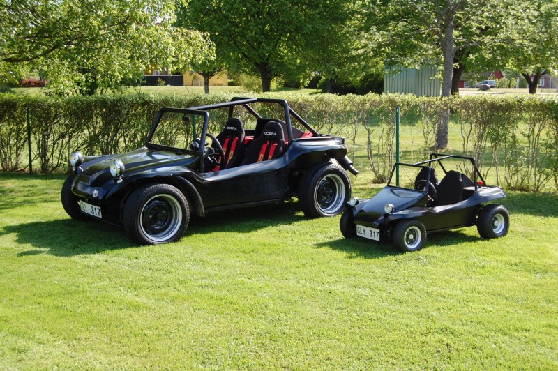

Some more progress, a seat, electricsystem and some panels
Lite film:
[youtube]http://www.youtube.com/watch?v=wFn2UUMFEQs[/youtube]
//Rydh

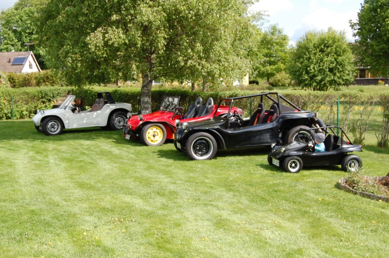

Long time no see..
In early June the buggy was ready to go to car shows, and then the whole summer was pretty busy.
The brushless drive system didn't really work so now i run a 24v dc wheelchairmotor instead it starts mutch better and is totaly quiet.
Everything has worked perfectly all summer so this winter the oly thing to build is some controls in the car så my son can learn to drive next year!
//Rydh

Hi
When i replaced the outrunner motor i only changed the motor to a bruched one från a wheelchair, i dont use the wheelchair gearbox so the wormgear and diffassebly i first made is still in use.
I'm in the process of building a bit more simple RC gocart for my Brothers son and for that build I'm planning on using the complete gearbox and motor från a wheelchair, and knowing what i know now i would go for a motor and diff from a mobilityscooter.
ORIGINAL: twissted
that is very cool. I wonder if insdtalling subaru diff in th rear with a planetary and motor would work with a build like this?
I guess that it would work but perhaps i bit large and heavy!
//Rydh
