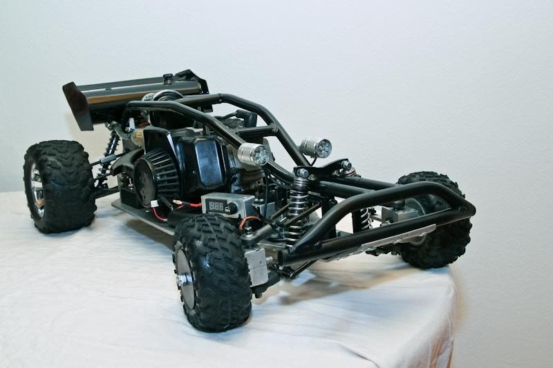

Hello!
My name is Sinisa and I am writing from Croatia. This is my first post on rcuniverse forum. Before year or so I decided to build my own RC something (at that time it wasn't matter if it would be car, buggy, truck, airplane or something else). I am an electronics technician and familiar with hand and power tools, but without any experience in RC before this project.
After days and hours of googling this forum was discovered .
After reading sticky about homemade projects I made my choice: It will be 1/5 or 1/6 BUGGY
After one year car is finally in working and good driving condition. Many, many problems needed to be solved during production period, and much more time and much more money was spent than planned.
It was worth every single minute and every single buck!!!
Thank you all for being so constructive in posting and for posting lot of pictures.
Special thanks to sam123, Dirty Vinylpusher, Lars from Norway and many, many others which were active on homemade threads.
And here is some photos and information about my project.
I have many pictures from production (details, phases, replaced parts,...) and will post it soon or on your request.
Length: 740mm
Width: 416mm
Height: 278mm
Wheelbase: 515mm
Front track: 288mm
Rear track: 333mm
Weight: 14.4kg with fuel
Engine: 40ccm 2,5kW
Battery power: 6V NiMh custom pack
Gear: 11:19, 6:19
Brakes: 98mm disc
Servos: 10kg/cm
Greetings from Croatia!

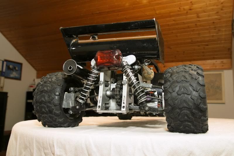

Here are some photos of parts and assemblies.
This project had many changes because of bad design or miscalculation so I will try to point to that stuff.
That may help someone to not make same mistake.
That doesn't mean that i will be posting only bad stuff
First idea for transmission was system with two belts. That was bad idea!! Engine has just to many torque.
Tiny XL belt didn't survive first test drive
Very soon i had to replace it with chains and sprockets
First set of wheels were from ebay for some rock crawler. They couldn't carry weight so I installed a valve and filled it with compressed air.
That was bad choice because at that time buggy was over 10kg weight and was very unstable with those tires.
After couple of test drives realized that it needs bigger rear wheels, wider rear track and that I need to get rid of inflated tires.
Those small rear wheels were poking me in eyes. I bought some real tires for rear and did something that bring amazing increase in stability:
took a visit to local furniture manufacturer and got piece of hardest foam that he had. I made inserts tvice as big as originals and somehow stuffed it into tires.
Result was amazing! Wheel is enough firm to carry vehicles weight and still soft to deform as needed.

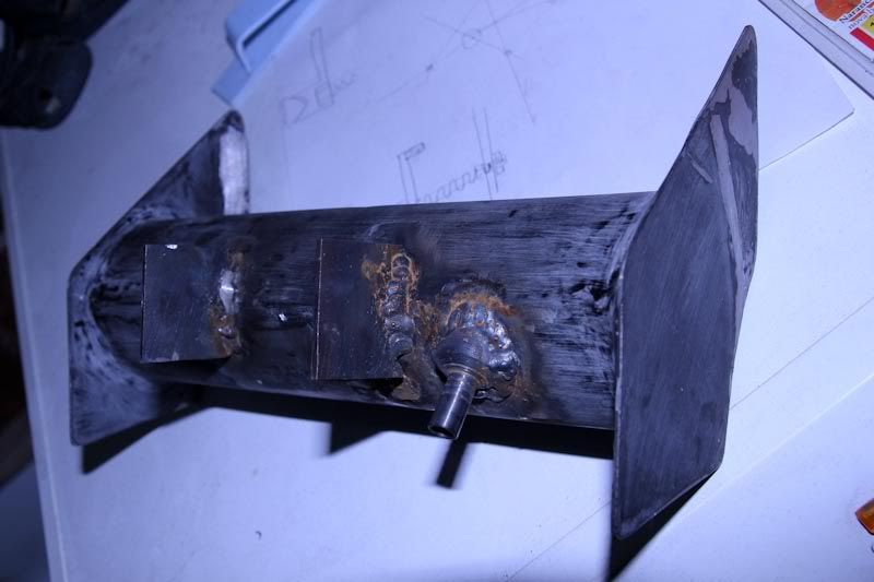

I also changed rear suspension, increased rear end ground clearence and changed driveshafts.
First try was to increase length of driveshafts by cutting them and put into tube adapters. Bad idea.
To much vibrations and too much torque and weld couldn't hold.

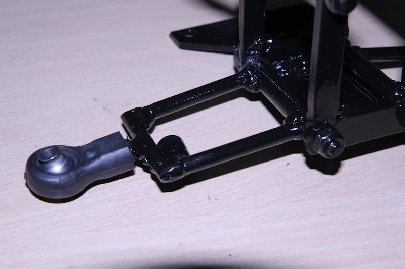

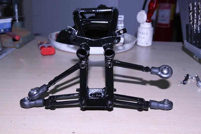

Ok, here are some details. Some of them are changed but i will write about these.
Front end - first design
This setup is driving but i am not satisfied with it. Suspension is too narow, tower is too weak, bump steer is very high.
Bump steer is very high because my arms forms high angle and turnbuckle joints couldn't performe it. I had to raise turnbuckle joint on one side to lower angle. Result is more than 3mm difference in length when suspension is down.
Those blocks could be better built, but at that time I didn't have a lathe
Anyway, here are photos, maybe someone coul'd learn on my mistakes

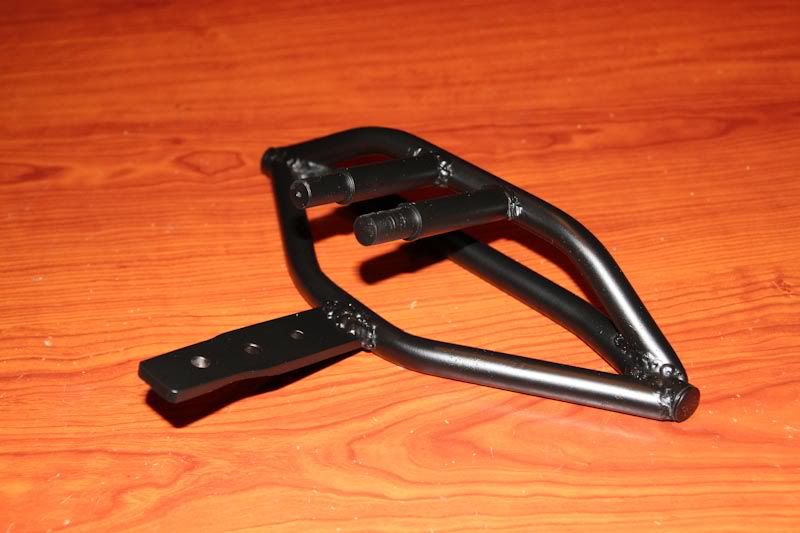

Rear end - first design

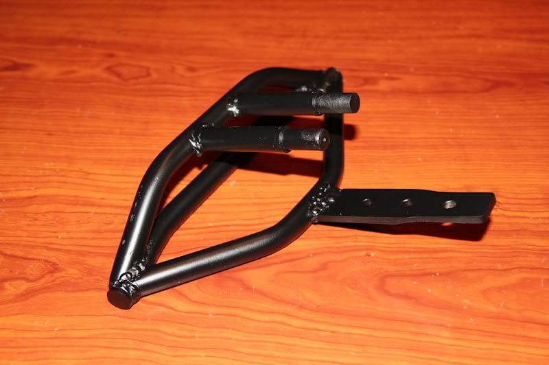

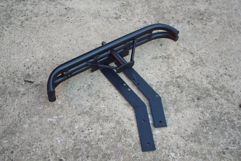

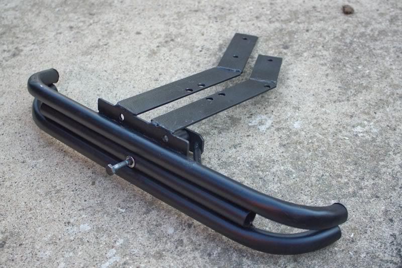

Bumper

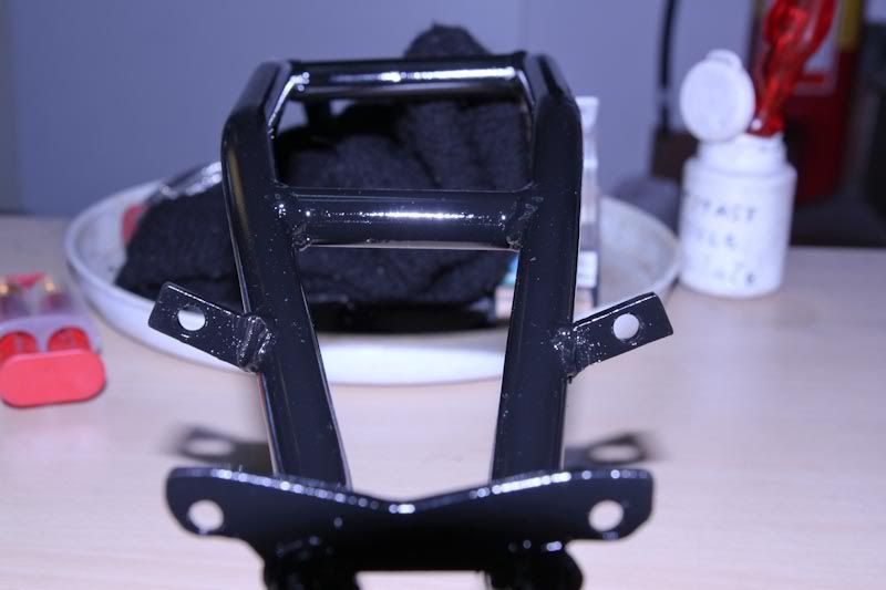

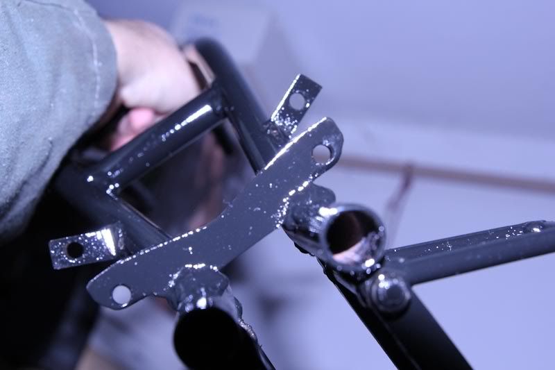

At first there was no plan to build a bumper. Very bad idea! Before this build I never drove this big, heavy and relatively fast rc vehicle. I underestimated force of almost 15kg heavy buggy hitting a sidewalk, taking a flip or crashing into fixed obstacle.
Realized that after very first test drive. Result was broken brand new servo. Instead of installing servo saver I decided to build a bumper to protect both front wheels and servo.
Another big mistake was to make a bumper from aluminum tubes. This one was ruined after very light touck with a kurb.
I made second version from aluminum again, not from tubes, but from profile. This version was much stronger, but still not strong enough. Aluminum plate on two springs was very good for light contact. At that time I had problems with radio system and several lighter crashes deformed it very badly (mostly on thin wheel protecting part)
At this moment I decided to build next one from steel. Heavy, but who cares, buggy will be protected during all testing and debugging stuff.
It was made from steel tubes and had an extension to chassis
It was very, very heavy, but very, very good. It survived one severe crash when my friend (first time driving ) turned into wrong way and in panic got full throttle instead of giving a brake He crashed into parked car with almost full speed! Luckily he bumped into wheel and there was almost no visible damage on car.

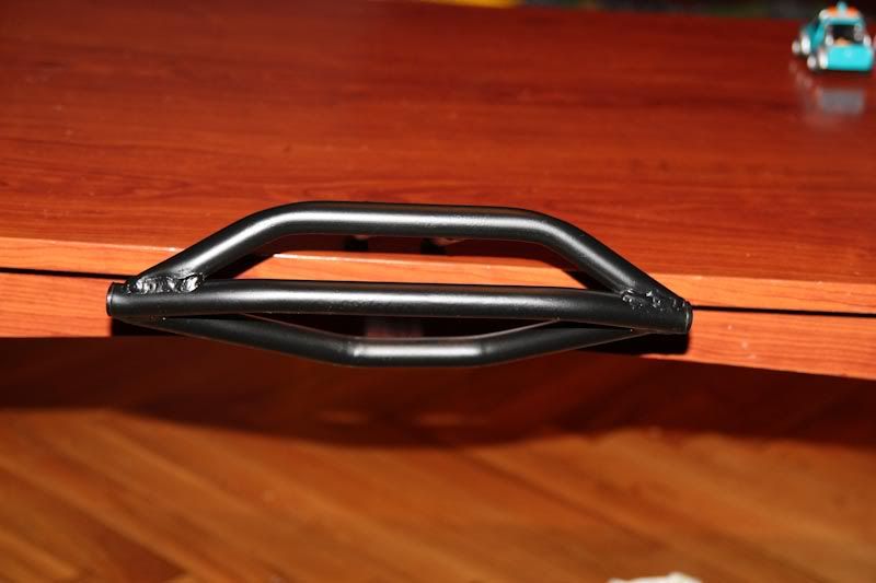

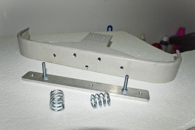

Bumper - need a new design - please help!
Last (third) version of bumper is performing well, but is to much heavy so I decided to replace it with more compact version.
This time I need your advice, please help!
Idea is to protect vehicle from front crash and partialy protect wheels from bumping with wheels in turning position. I will also install a servo saver.
Bumper with springs seems to be a good choice because it can take a lot of energy without transfering it to chassis or deforming. I got some pretty hard springs used in real cars for valves. This time springs have to blend into bumpers desing. I want to use steel or aluminum (or combination) but not have tools to weld aluminum.
Build it from two parts (like in 2nd design) or to make it from one movable part? If one, how to attach it to chassis?
I don't want to wrap bumper around wheels this time. How much wheel area to cover? Curve it ot leave flat? At what height to install it?
If anyone have an idea please reply!
Thank you!

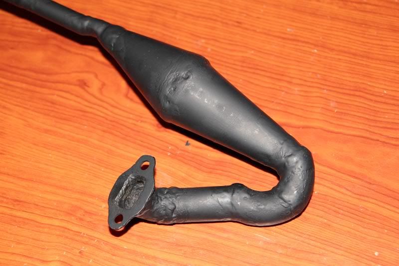

Pipe and silencer
First idea was to build a simple two stage tuned pipe. I got several tuned pipe calculators from internet and played for a while. In every result, overal length of pipe should be more than one meter with second cone longer than 30cm. Since it was to big to fit without complicated bendings I decided to shoot in blind. I don't have equipment to measure is it really working so I decided to compare it with any other muffler. Some stock muffler from chainsaw was nearby and comparison result was very good. There was noticable difference in power and sound. Sound was very loud, but pleasant. Pipe was crying for some sort of silencer so I decided to build one.
Made it from aluminum because it had to be light due to high vibrations. In lack of equipment to join aluminum parts I glued it with epoxy and baked in owen for two hours. Result is amazing. Sound and appearance are very good and there is no noticable power loss.

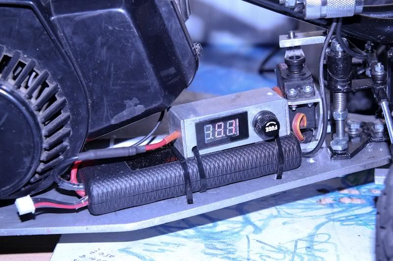

It's time for some updates!
I was almost satisfied with last build, but there was few thing that was screaming "change me, change me!"
Main problem was high center of gravity due to heavy tank on top of vehicle (I could not find an affordable carb with membranes so now tank must be positioned above) and relatively high positioned engine. Sometimes it was to easy to flip buggy in fast corner.
Also aluminum parts in bumper and in frame was a bad idea.
I made some serious changes and can't wait to drive!
Here are list of changes made:
Engine is now 3cm lower, mounted directly to chassis (I had to drill a large hole in chassis because carb is very low and rewiring was needed).
Fuel tank is 2cm lower, now mounted in two points. I got rid of heavy big clamp and add an element to reinforce wing top ends. Drain hole is now much bigger and put in angled position because gravity was not my friend
I hope that this two things would increase stability.
Aluminum frame is completely replaced with steel ones. Front tower and arms are now from steel too and welded directly to steel frame. Suprisingly it is not much heavier than aluminum one because alu front end was made from many pieces bolted together and old frame had steel bars in some of critical tubes.
Front track is now 315mm, just a bit narower than rear one. Arms are much longer and with no play in bushings ( I have a lathe now )
Wheelbase is increased to 535mm.
Shock tower is narrow now and top end is more than 3cm lower. That means that it is not exposed to damage during flipping.
I had to move and shorten headlights for same reason.
Steering system is completely new and I made a steel servo saver
I installed second pair of bearings to front blocks and made a beadlocks from steel plates (ugly, but goooood)

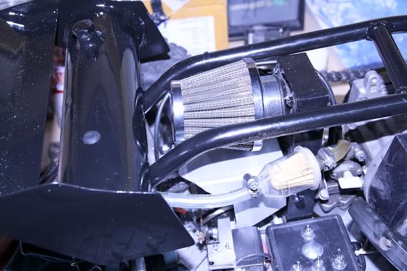

There is also new air filter for which I had to build adapter to dislocate filter from carb (no room to place it behind carb)
After many problems with proper power supply I decided to switch to LiPo Good call!
This is 2cell 3000mAh 15C battery from ebay and is performing very good. Unlike NimH ther is no voltage drop on full demand (both servos under load, headlights and brake lights on)
I know that 4amps isn't much load for Lipo but Nimh couldn't perform it.
I found this oil can when was digging my scrap. It is probably older than me but it works!
This was huge rebuild and I cant wait do try to drive! Still need to rebuild pipe (egine is lower now and there is no room for it under chain anymore) and design a new bumper.
I will take some photos of whole vehicle soon.
Hope you like it. Feel free to reply with or without questions or ideas.

Here is new bumper. I decided to give up design with springs due to lack of inspiration. Skid plate (not mounted yet) will be playing that role.
I was not inspired at all during design of this (4rd generation) bumper and it was very time consuming Much more than build it actualy. Call for help several posts ago didn't get any results. Hope there are no big design mistakes in this update.
It is made of 15mm steel pipe with 1,25mm wall. That makes it just over 600g.
Here is rerouted pipe (chamber is moved to front, flange is closer to chassis).
Weight is 600g.
Parts aren't mounted yet and I need to make and mount a skid plate

Bumper and pipe are finally mounted so here are pictures of "new" buggy with all updates.
I'll wait several days for better weather to test it and to make some video.

Here are more photos of last update...still no video
