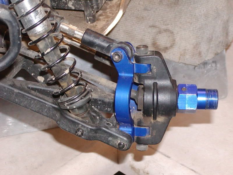

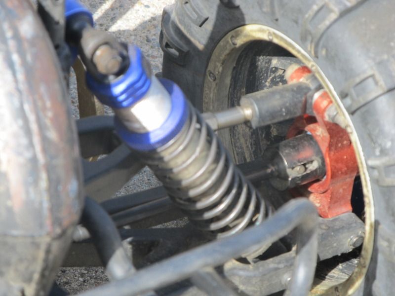

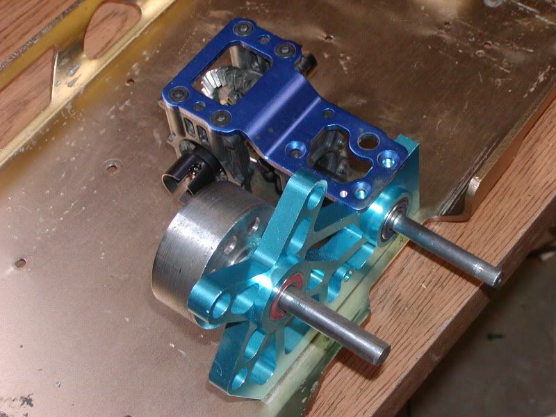

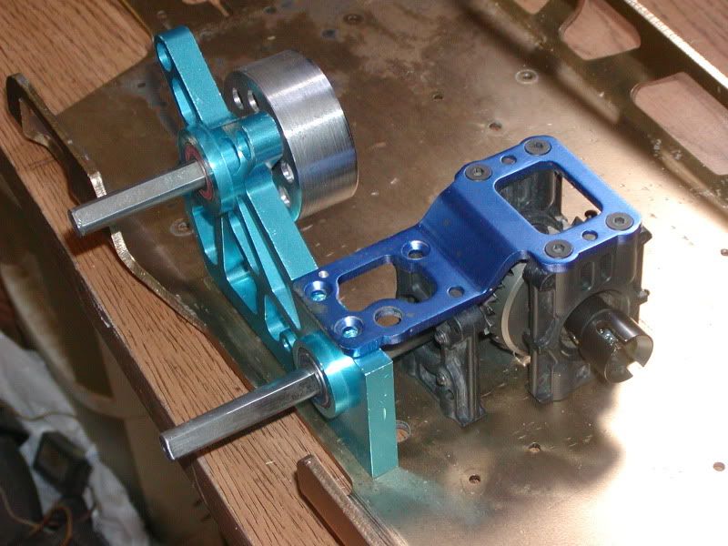

I need to see a a picture of where the diff out drive cups are located on my Maverick Blackout so I can measure them and get a retainer ring made.

here is a pic of the rear wheel drive cup this is a redcat rampage mt but they'er the same truck
front center diff cup
rear of center diff cup
front wheel drive cup

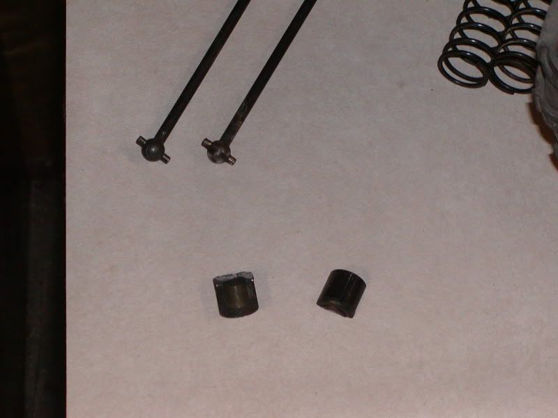

Thanks for the pics, I've heard pins have a tendency to come out. Can you tell me where to come out from if you know?
Thanks.

the pins come out of the ends of the dog bones we take a punch and knock the pins out then use a center punch to put punch marks in the center all the way around the pin and then we use 209 green loctite on the pin and put them back in the dog bone
