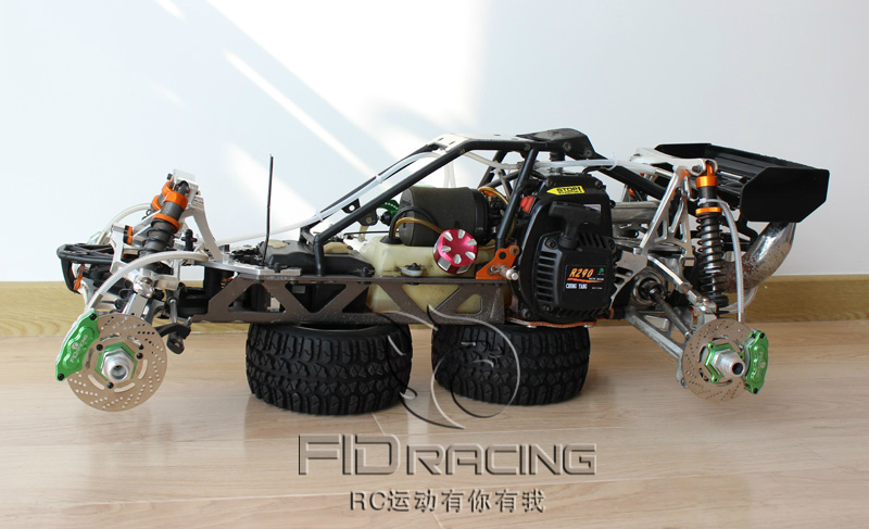

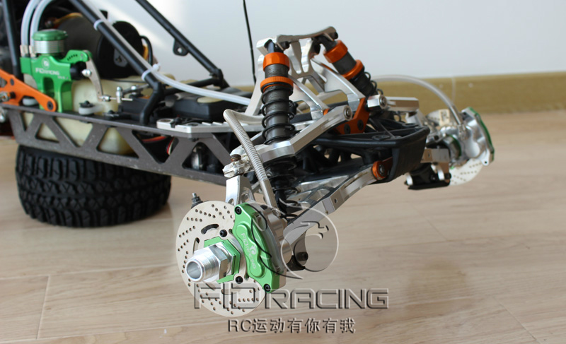

HPI BAJA 5B 4 wheel Hydraulic brake
themastercylinderusesaviationaluminum7075-T6withhardanodizedandadrivingwayoflever
typetoguaranteewearresistanceofthepistoninmotion.
Eachcalipershave2piston,asetofbrake=9pistonswithsu perbrakingforce,
Thebrakediscisventilateddiscstructure,
whichhas6mmlargeoilpipewithresistancetohightempera tureandhighpressure,
equippedwithmetalprotectivesleeve,90°bendjoint,
standardTtypetee,andcooldoublepackingdesign!

But there is no brake bias front to back and as seen in the vid the rear end is coming around, so on dirt it would be even worse!
