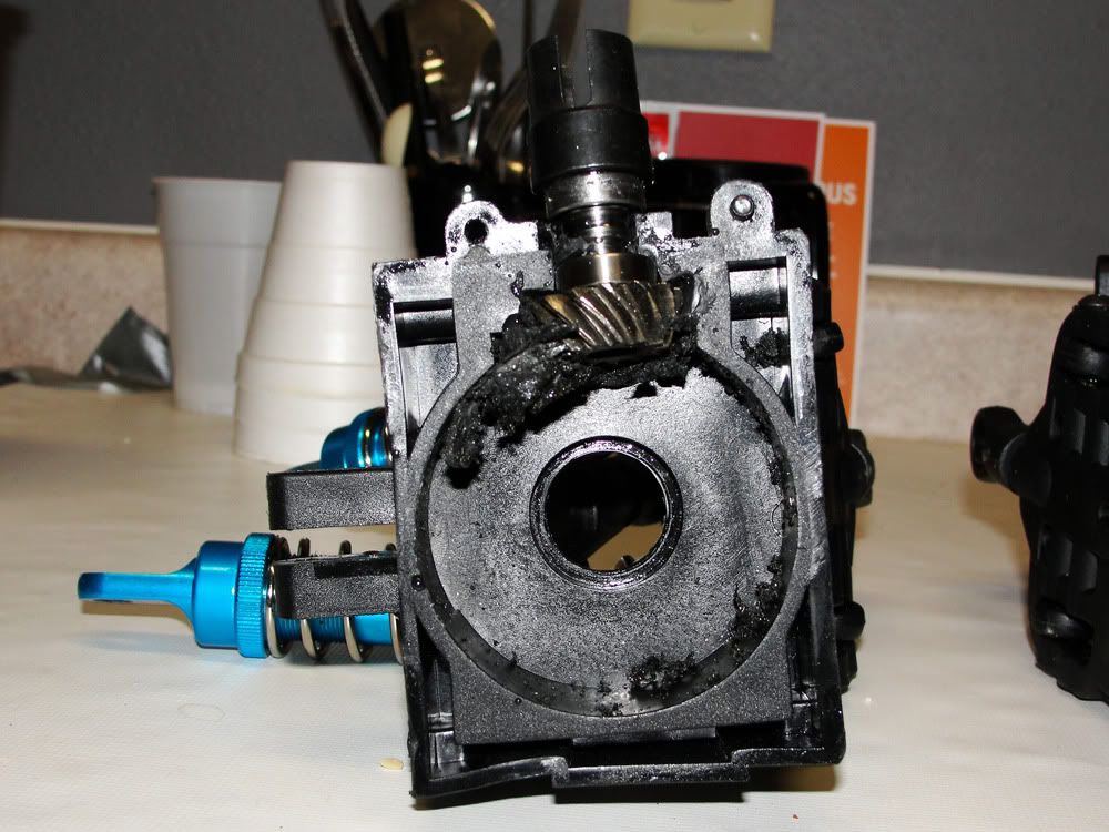

Sure glad I didnt take on a container load yet lol [:@] got my first 1/2 tank through and melted the front differential box, back to the drawing board and see what we cant come up with from the factory but I will not import and distribute these until I feel they are up to par, I just hope the factory is willing to make some changes and acknowledge the issue, rear differential is fine I don't know if the plastic differential box failed or if the inner bearing gernaded first and then took the box out, I am sending the pictures back to the factory and see what we can get done, I really like this truck and the reverse is hands down the best lol, I had it plowed into a huge snow bank all the way at the end of our parking lot anything else and I would have had to walk all the way across the parking lot to turn it around but with the reverse I just pushed the switch and it hold the servo arm against the actuator and when you want to go back forward just push the button on the transmitter again and the servo arms goes back to neutral :-) dam thing goes just as fast in reverse as it does in forward lol very cool feature just need to work out the bugs.
I will report back once I hear from the factory!!!

man i like the reverse feature also but on my nitros all of them it was a real pain to keep running.
maybe this features a better system,i would like to see how it holds up.
i wouldnt be too hard on the car over the diff breking this could be an assembly glitch you may have just got one bad one out of a bundle.
it looks strong too,the diff gears look good.
let us know how you get on.

Looks like a bearing failure to me, their bearing supplier mightve had a bad day
The differential gears look good and im realling liking the removable cups on the diff outputs.

Yes I to am very impressed with the quality and I hope it is a fluke but its my only sample of the MT so I need to know this is not an issue, I will be getting new bearings from the factory and a differential box as everything else looks fine, I to think the bearing gernaded first and took the cases out but its hard to tell, the plastic cases could have been a bad mold to which would put a ton of pressure on the bearing, I will know once I hear back from the factory as I really want to make a go of these because it really is a quality built unit, I know there is a weak point in all of these but I need to know there will be support from the factory with issues like this so this will be a big test, hey everything happens for a reason I just hope we can get through this little snag. Everything else was hands down twice the quality of the FS and the FS is the only other product I personally imported, all of the fasteners on these are alan heads and unlike the FS fasteners I haven't stripped out any of the heads taking them out so that's a bonus. everything on this truck is so thick and well built I was really not expecting this but that's why you take samples and work out the bugs :-).
I have high hopes this little issue will get resolved and I can continue on with importing these because they really are a great unit every where else thus far, the transmitters are great no range issues or glitches like the FS transmitters, and I cant say enough about the reverse lol its great and so simple it hurts haha I cant believe non of the other manufactures jumped on that band wagon yet.

the bearing gave up and that give the extra gap for the gears to grind the plastic.

From what I have been learning ,it seems to me that bearings are a real problem in the Chinese cars.

The one tested here is the lower cost version.
the bearing of the new version are upgraded.
is a matter of $

hahah wow where did that come from, how is the one we received a lower cost version ? money doesn't have anything to do with it Ken they only have one version of that truck and that's what we received, sounds to me like your trying to pitch a sale here, I call it like it is plain and simple and by chiming in here and say its a lower cost version and it all boils down to money your not helping the cause, I am testing and relaying the results here for everyone to see that doesnt lie or mislead !

Yes the bearings do seem to be a weak point on most of the Chinese imports but I am going to take a new set from them and a new differential case and have another go at it, even boca has a faulty bearing from time to time lol so I am not going to put the product down just yet as I really really like the rest of the truck and I think it will still make a great quality reliable vehicle. As soon as get a tank or 2 ran through this bad boy I will have my final conclusion, worse case scenario I can import these and swap the bearings in the differentials before I ship them out .

P.S the factory emailed back and they are sending out some new bearings and differential case so far I am really impressed with there service which is just as important as the quality of there product to me

Well I put the beast back together in 2wd until I could get the replacement parts from the factory, dam things really tears ass but surprise the same thing happened to the rear differential lol [:@] now I am out of parts haha I will have to wait and see if the new bearings and cases fix this issue, this is almost more fun in 2wd tachs right up on the dry pavement and smokes the rear tires doing donuts
I hope I can work out these issues with the factory this thing is a blast to drive and I cant say enough about the power, this thing stock has more grunt and topend then my FS MT with a tuned pipes, air filter and V Stack way more power.
Thank You,
