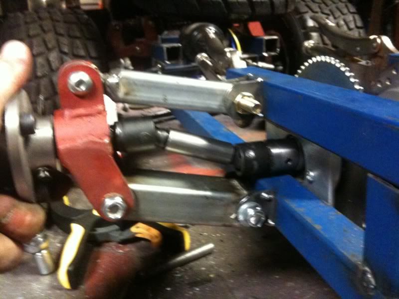

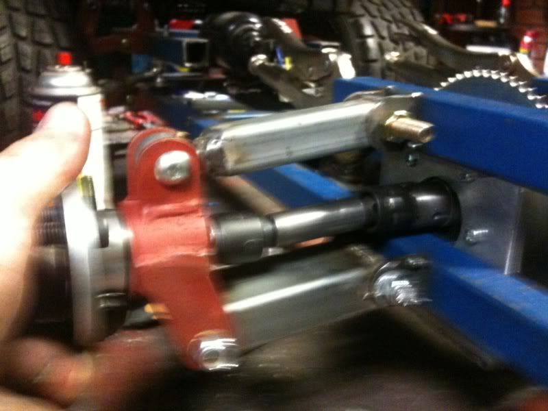

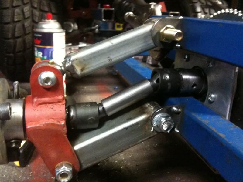

pissed around with some axles today... i was dreading making telescopic axle for the lateral movment ...
i thought ild try using the little in/out movement that the unijoints had already and blow me down it was enough
so no having to make telescopic axles

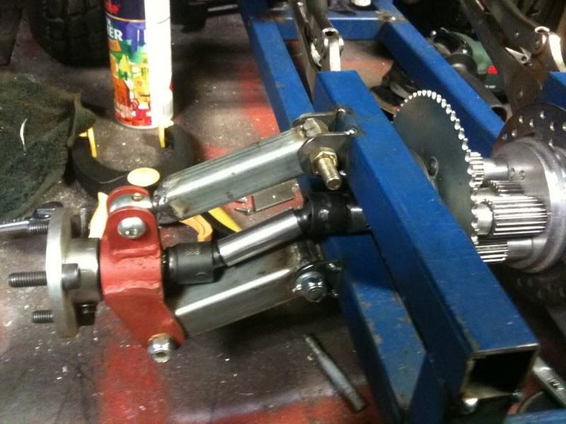

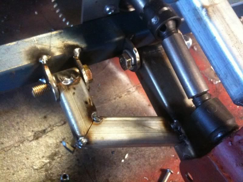

made an extention to the rear arm to tighten it all up...
tac-ed it all together
made a little booboo too :lol: :lol: see if you can spot it in the pic!!

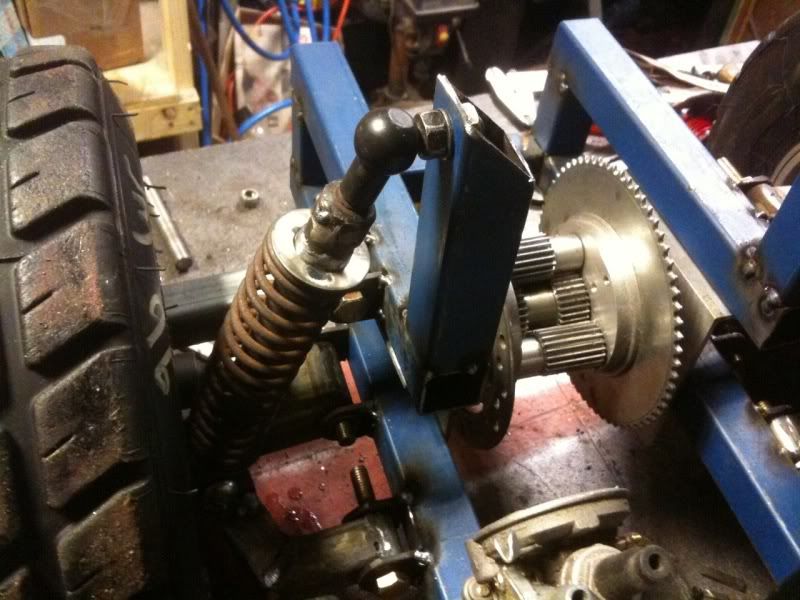

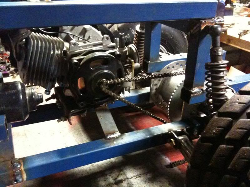

heres some more pics of the rear shocks.... i have enough room so ive mounted them "normal"
just have to make some bracing and shell be all strong
heres a mock up of engine and battery placment

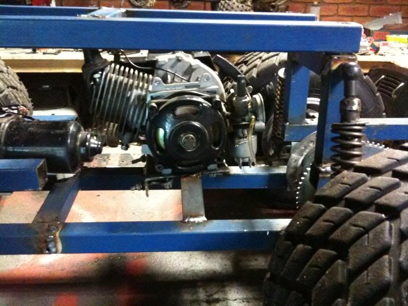

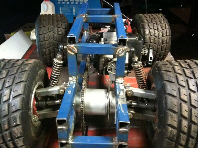

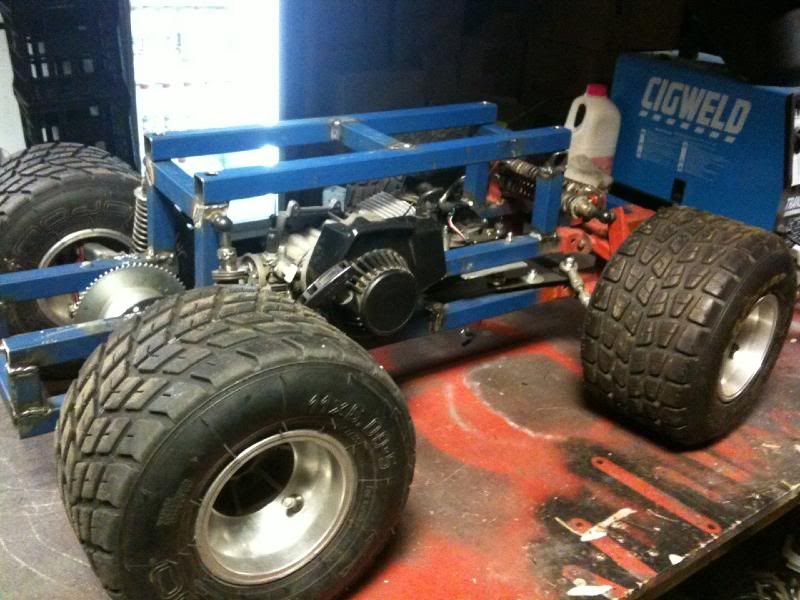

did abit more today.....
final assembly of the axles
frame /bracing done... looks alittle Square but its all covered anyways
motor mounted
chain on
rear view with the diff casing on
with body on again (and me little losi on top)

ORIGINAL: da mad maori
You didn't get the bolt out after tacking it together?
Old 09-25-2010, 01:25 PM
  #81
dealwithit
My Feedback: (55)
Join Date: Mar 2010
Location: nanaimobc, CANADA
Posts: 227
Default RE: 1/3 scale project
lol you wont be able to get either bolt out
man that steel work looks sick! lol that things tough enough you could probably use a 3hp 4stroke honda sound abit better than the pocket bike engine and would allow a smaller diff gear for more clearance

um thats the way to gear it lol.... yeah its square but itll get the kids to and from school faster lol
how much higher is the body going to be to clear the suspension upper travel?
What about camber angle ? I saw in your photos that your angle is between 0 and (~)+3 degrees , than the -3 of the proper .
Old 09-27-2010, 04:57 PM
  #85
da mad maori
Join Date: Jul 2006
Location: , AUSTRALIA
Posts: 771
i have about 5mm adjustment on the top arm which is about 2.5mm movement in the axle before it'll bind.. its been adjusted since the pic....
its not perfect but itll do lol
theres a slight positive camber on full compression and 0deg on extension so its not too far out now

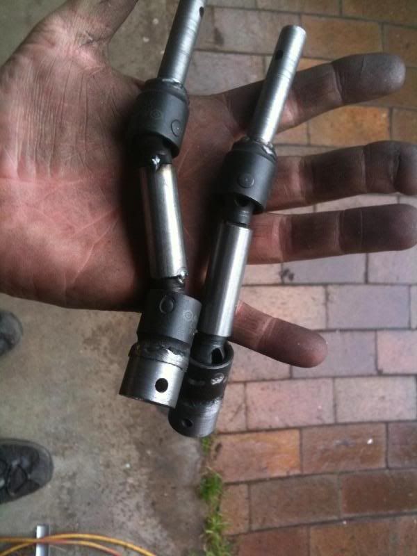

Here it is... on her maiden voyage....
homemade RC Hummer!
cooked the hbridge for the steering servo coz the 3 feedback wires were too close to the sparkplug lead and made the servo go ape sh*t
after building and installing a new hbridge it was all go again
Homemade RC Hummer 2
Homemade RC Hummer 3/3
and then i blew an axle!!!! (bloody dodgy welds lol)
