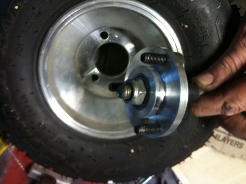

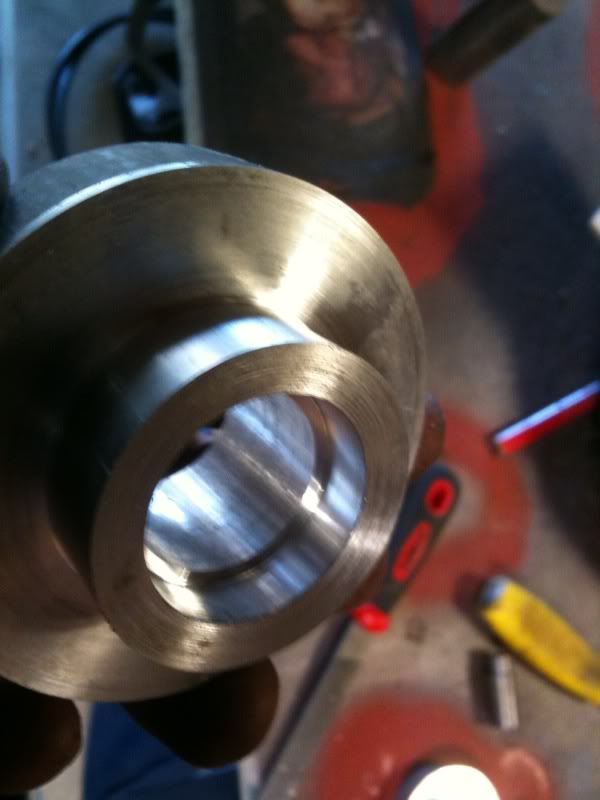

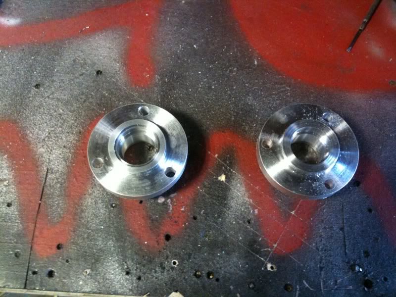

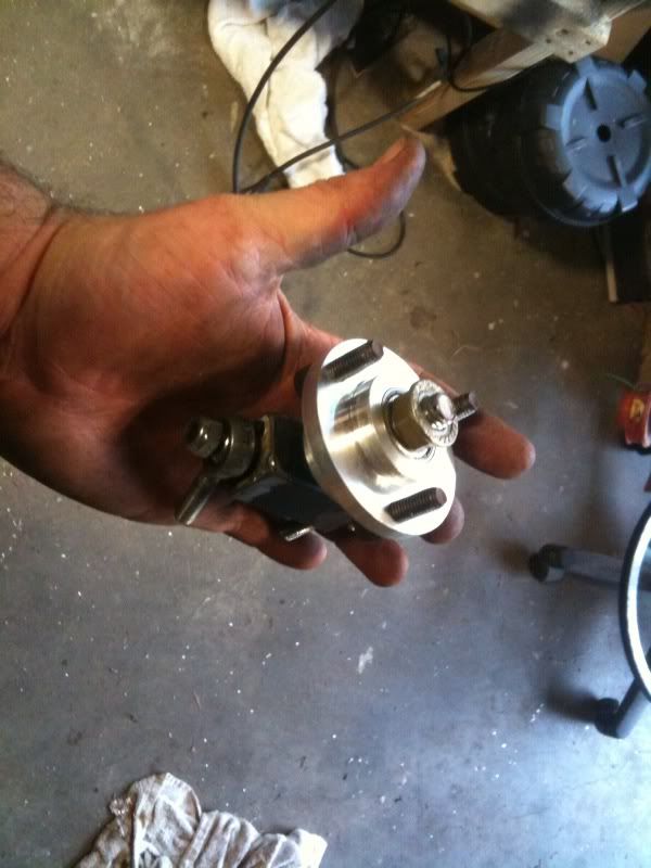

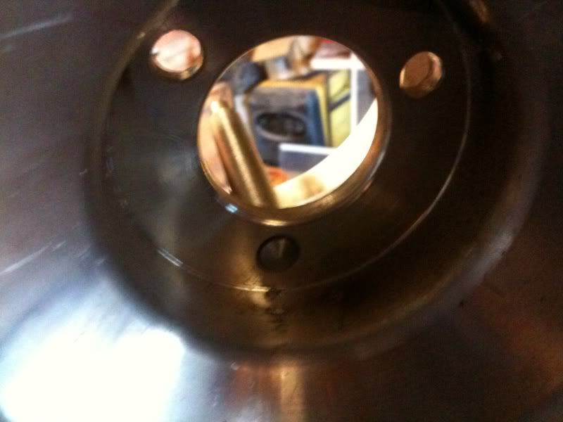

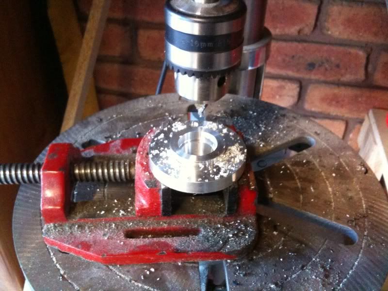

started with the front hubs
70mm stock Allu round
machined a center punch to mark the center for the wheel nut holes
and a teaser pic of what it is

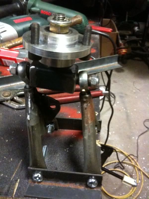

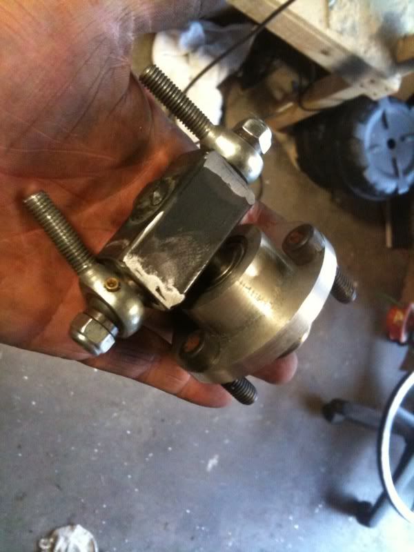

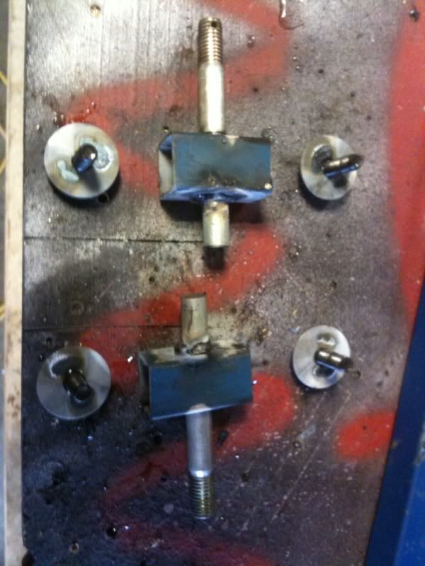

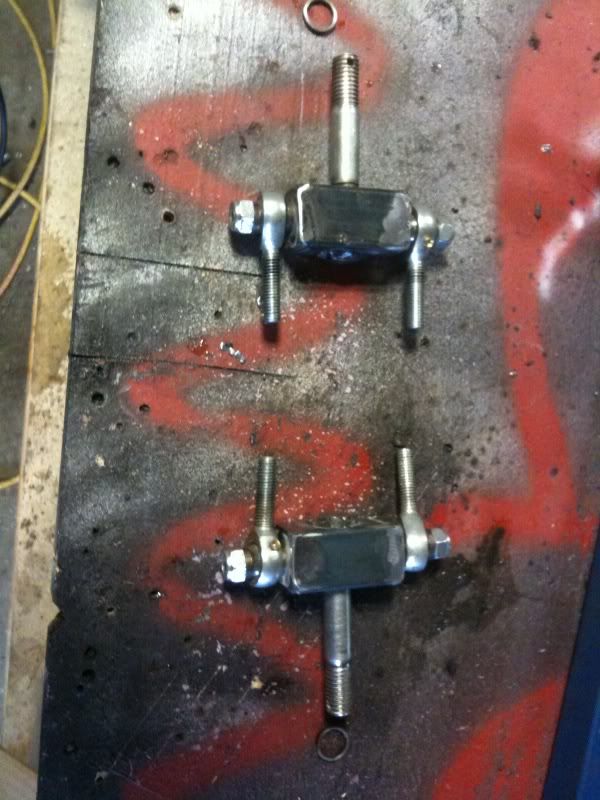

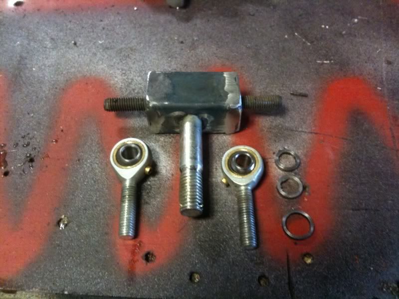

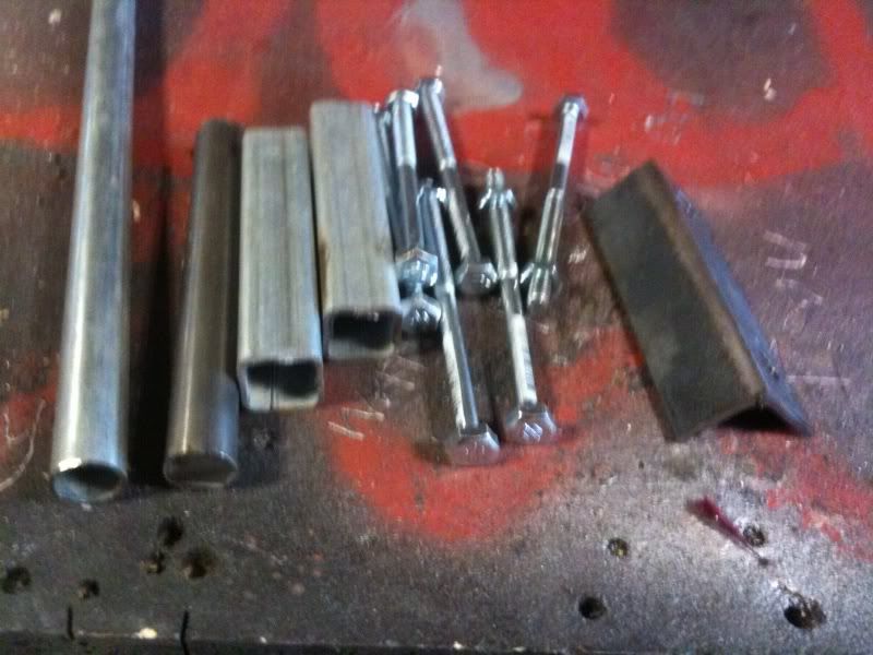

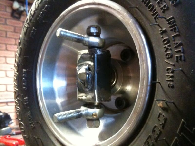

made the uprights tonight
M8 bolts welded into big washers,
welded and cleaned up
ball ends make good ......well.... ball joints LOL
using the arms from my 1/3scale buggy project... but gave it the ass as its sloppy and rusty etc so will be making new arms tomorrow

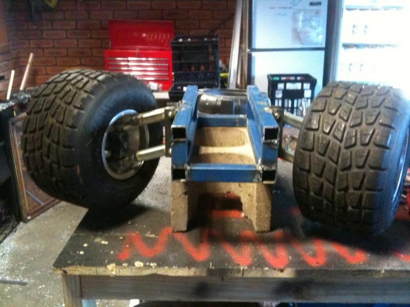

mock up

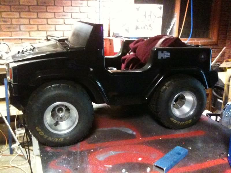

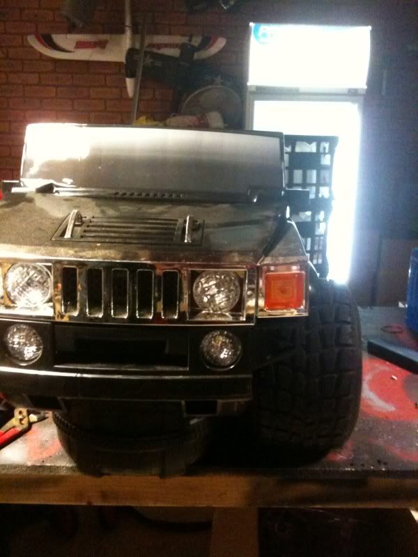

been thinking... the hummer body is not in proportion... of course coz its a kids toy... its too short for the width so should i cut and lenghen it to look more realistic or leave as is???

Old 08-03-2010, 06:34 AM
Mudgy
Mudgy's Avatar
Join Date: Apr 2007
Posts: 851
Default RE: 1/3 scale project
leave it as is mate. It's an R/C, so all poetic license surely is permitted
Old 08-03-2010, 08:01 AM
Dirty_Vinylpusher
Dirty_Vinylpusher's Avatar
Join Date: Jan 2009
Location: Close to the beach, AUSTRALIA
Posts: 3,497
I'd probably cut and lengthen it myself.
Looks a bit cartoony as it sits there at the moment....
Although it is kinda cool
Kinda like those Dub City toy cars.
Maybe make up some pimpin' hubcaps?

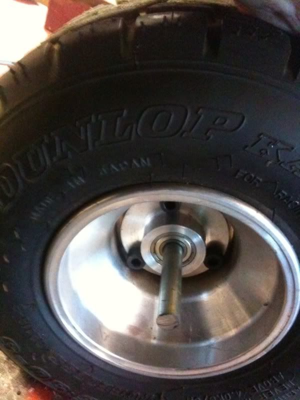

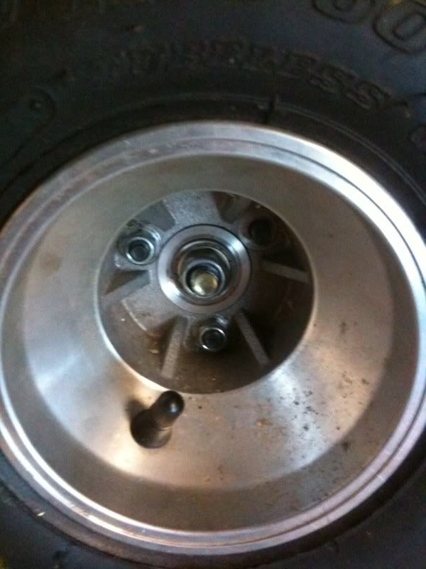

Are they gokart front wheels on there?

ORIGINAL: Dirty_Vinylpusher
rear wheels.. i need 2 more for the back also...
probably should have gone with ffront wheels lol ohh well

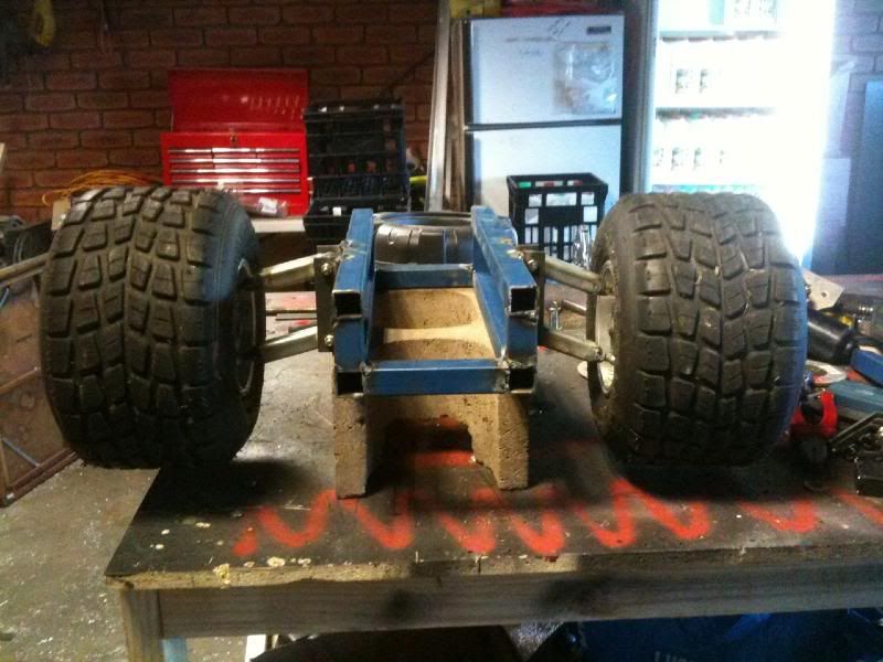

after 3 different designs and pulling half my hair out,,,, i finally decided on the simplest one :-[
(not alot of pics from a long frustrating day lol)

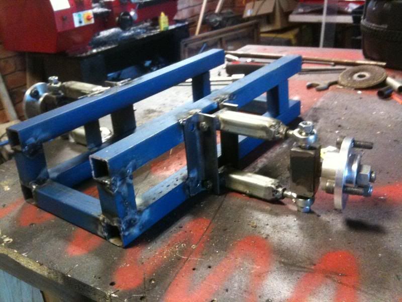

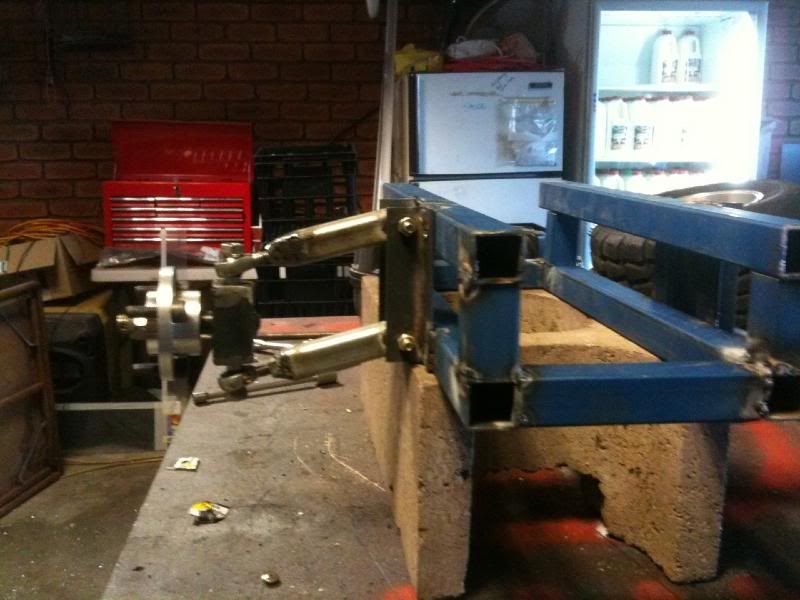

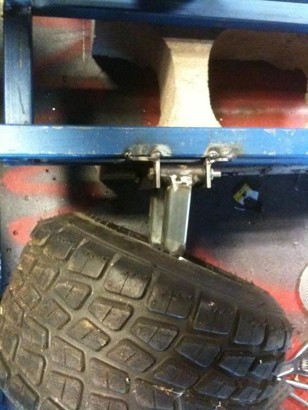

starting the the front end today....
its all going to be segmented so the front end which will be in one piece and contain the steering, front sus, steering servo,etc
will bolt onto the rear end which will contain the driveline , fuel tank, rear sus etc
anyhoo
i need to squeeze a shock into this spot... coz i dont wanna mess around with counter lever shocks....i dont mind sacraficing a little steering lock for ease of shock placment
next will be steering and shocks

you sure that will be strong enuff???

if your tight for space have you thought about bell cranks 'n' inboard shocks? just an idea...looking good mate
Old 08-11-2010, 03:29 AM
da mad maori
Join Date: Jul 2006
Location: , AUSTRALIA
Posts: 771

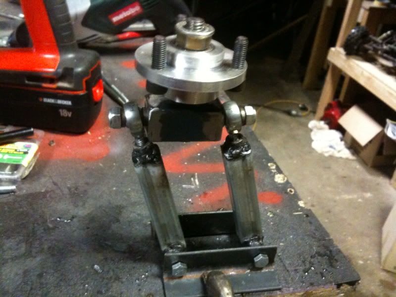

made a start on shocks today....... man what a hassle!!! went through 5 different designs, trial , error, ,throwing stuff, lol
couldnt effectively mount shocks normally so i had to resort to inboard shocks (,counter lever,,,bell crank,, etc) which i didnt really wanna do but ohh well
seatled on a good easy design using gas struts
made a sleeve to fit into the shock body and the endcap...giving me an area to drill and tap a fill hole and possibly to drill and tap another hole for a ressie
i soldered them together to seal it then tac welded for strength
the shaft is hardened steel so welding a bolt on the end was the only way LOL
one side assembled

Did you do anything to the washer that's on the end of the shaft?
Cut slits in the side or anything like that to let the oil pass through?
Also, when you say that you soldered them together..... what do you mean by that?

BTW "wash yer hands, Geoffrey" !!!

yeah theres a washer in there that acts as a oneway pass for the oil... so i welded it still ,then cut slits in the side to let oil pass like ya said
i used plumbers solder to join it all together coz i only have an arc welder... its very hard to weld water tight with an arc lol so i soldered it first..

LOL they're never clean for too long
