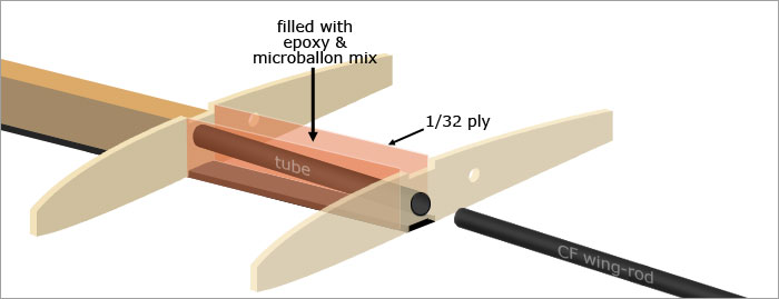

Well inspired by BMatthews' excellent suggestions I have a slightly modified plan for my wing-rod joiner section...
I like this idea because it avoids the hassle of needing to accurately drill holes in hardwood blocks at exacting angles. A nightmare to get right using wood but with Matthews' liquid method, all I need do it place the two wing panels together, insert the tubes & wing-rod & pack in the goop.

ORIGINAL: Nodd
The technique you've pictured has been around for a very long time. The rods used to be piano wire. Back then there was tubing from the rack to fit whatever size rod you figured was appropriate. It's quite an easy job once you've worked out handling the process.
Keep in mind that up until CF reared it's expensive head, we used spruce spars and balsa webbing. Once we got your component sizes worked out, wing failures were really not a problem. Sometimes having a stiffener that is too stiff causes problems. It is significant that your wing failure appears to have happened during what sounds like normal flight.
BTW, it's a good idea to pick up a handfull of ordinary wooden dowels to have on hand when doing the work. They make quick and easy end plugs. Gap filling CA seals the plug in a heartbeat and you'll have no worries the 'liquid' might lock the rod in the tube.

Yeah I recall flying gliders & whatnot back in the '80s using piano wire wing-rods. I don't think I flew with the same amount of dihedral twice LOL. Worked out nicely though, the gliders got more stable with each high-start launch :-P
I'm not really surprised that my old wing failed during normal flight. Since discussing it here online in excruciating detail I've realized it had several major design flaws including a weak C shaped spar, poorly attached webbing, gappy butt-joined sheeting & areas of high strength that ended abruptly causing stress points. Failure was inevitable. I'm chocking it up to a learning experience & trying not to dwell on the what ifs. New wing, new design, moving on...
Good call on the top & bottom filler pieces to displace some of the microballoon goop around my wing tubes. That'll save me some glue. I'll probably use your tube plugging tip too. Much appreciated, thanks.

The trick about drilling precision holes in two different wing panels is what led me to use the goop and tubing method in the first place. And yeah, there's certainly no foul at all about packing much of the space with more balsa to limit the amount of goop required.
To confirm DaRock's ideas on spruce vs carbon I've got a 2meter glider which was converted with a new fuselage to electric motor launch some years back. The airfoil is an Eppler 201 which is a little thicker than most at 12.5'ish percent. But this two meter model has lived through winch launches and a couple of rather nasty pull outs all with nothing more than carefully selected 1/8x1/4 spruce caps top and bottom and double webbing front and back. The key was to use thin ply for the first few rib bays and very rock hard balsa for the next few, then hard balsa and so on out to the tips where lighter balsa did the job just fine.

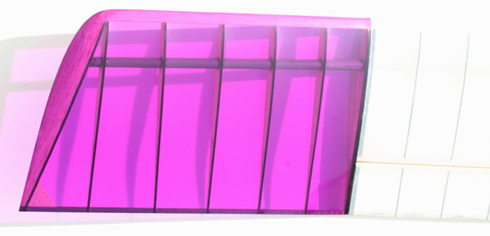

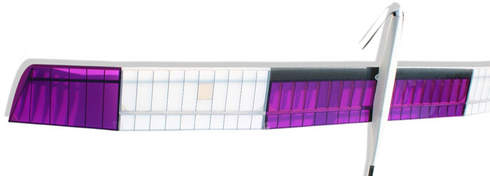

A HUGE THANK YOU to everyone for helping me redesign this wing.
Enough talk though, now its time to build, woohoo!
I spent a few hours tonight working up the new design in my CAD software. Here's a few teaser views...
I'll probably order the CF & wood early this week, can't wait to get started building or should I say re-building :-)

Actually, my first set of spar tube blocks were cut and milled on a Dremel drill press with a guide clamped onto the table. You could just use wedge blocks with no slot and block the tube in with wood then use epoxy and micro baloons to fill in around the tube. You will still be using a short pin for the wing rod so webbing, capping and wrapping will be required. If you don't get a gorilla foot on the winch pedal it may even last a long time. Tapping the pedal is the key with these short wing rods to keep them flying for a very long time.
The build is great by the way. I really like your design and may try your pod and boom design on a plane of my own, if that's alright.
