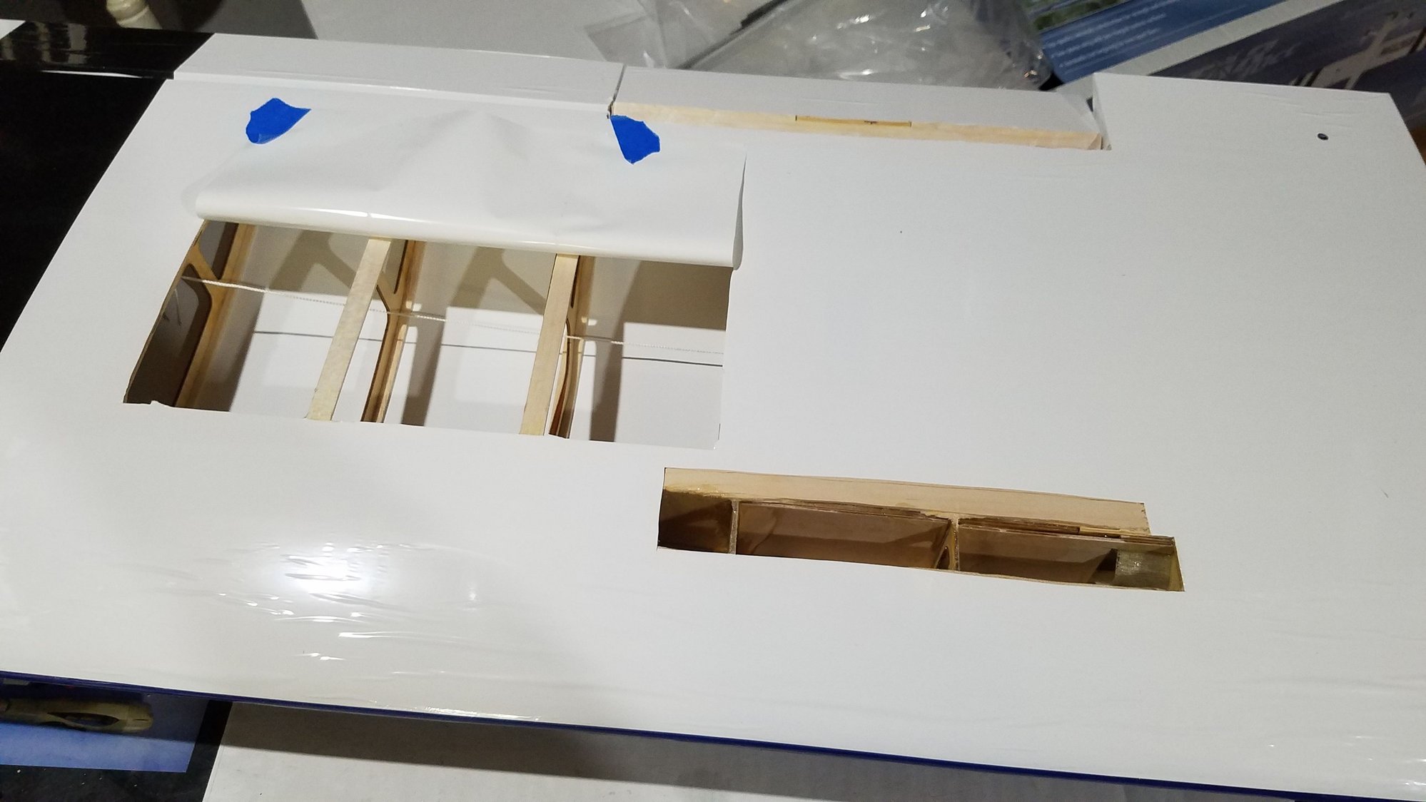

Default Main Wing Modification
After extending my elevators to 5 inches, I was having some fun watching this Avistar make tight turns and immelmans like a 3D plane.
However, this is NOT a 3D plane!
The wing joiner is only a 15 inch tube. It seems small for a 90" wingspan and I proved it during those tight turns. My left wing cracked during flight. I needed to strengthen the wing. I was going to make room for a longer tube but that would be more major surgery than I wanted to deal with.
So, I decided to add plywood between all the ribs I could get at without tearing up the whole wing. I then covered my work with a coat of fiberglass and epoxy.
I exposed about a 15 inch area of the wing spar and added plywood. Some spots near the end of the wing tube I was able to add strength on both sides of the spar.
between each rib I epoxied thin plywood and covered all these areas with fiberglass.
