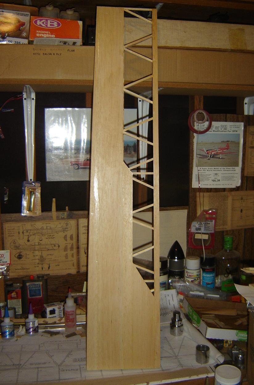

I blew the dust and cobwebs off to resume building my Cloud Bound 4 after a hiatus of 17 years. I can't believe it's been that long. Man time flies!
I was on a roll until beginning the left inner wing panel. Then I became frustrated trying to build the wing with differences in the Skybench kit and the original design. Also the ribs had to be trimmed to fit and was much more difficult to build than I anticipated. Nevertheless, now I am determined to finish the model whatever it takes.
I finished installing the spars, ribs and sheer webs on the left panel and looks really cool. The original designer said in the RCM construction article that he borrowed the V-pattern for the ribs from the Grand Esprit.
My next step is to build the right wing panel to same point. Then I can check the dihedral and incidence before gluing the brass tubes.
Has anyone finished their Cloud Bound 4 and flown the model?

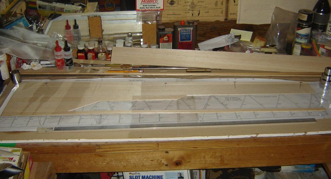

I prepared the bottom sheeting for right inner panel. Next I will glue the pieces together including cap strips for the ribs.
Old 10-26-2021, 05:06 PM
  #185
McLeodAviation
My Feedback: (70)
McLeodAviation's Avatar
Join Date: Jul 2003
Location: Austin, TX
Posts: 396
I finished the bottom sheeting and cap strips for the right panel. Laminated the carbon cap strip on the lower spar. Installed the lower spar and ply ribs 1-5. Installed the leading and trailing edges and all of the ribs in front of the spar. Next is the sheer webs and rear ribs with the V pattern.
Anything I could find for weight on the lower spar.
Wing sheeting, cap strips and lower spar completed.
Top spar has not been glued in this picture. I still need to install the 3/8" balsa vertical grain sheer webs before gluing the spar.

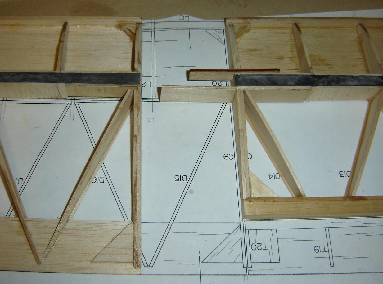

I still need to finish the sheer webs and V-ribs on the right panel but did a quick mockup. I had to be careful not to bump the wingtips on anything and the outer polyhedral panels still need to be installed for 144" span. The CB-4 is a big sailplane.

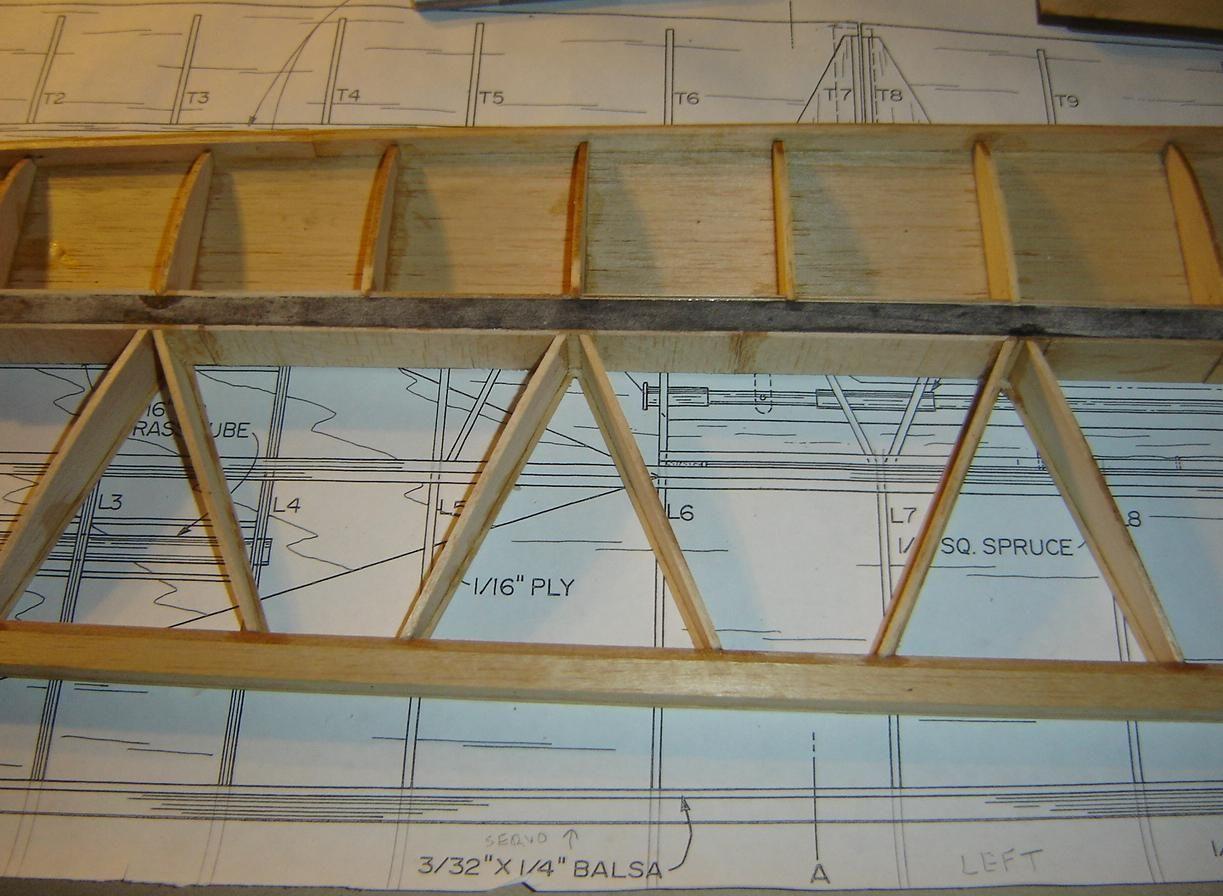

The rib notches adjusted for the correct width and height to install the top spar. Next is the vertical sheer webs and V-ribs.

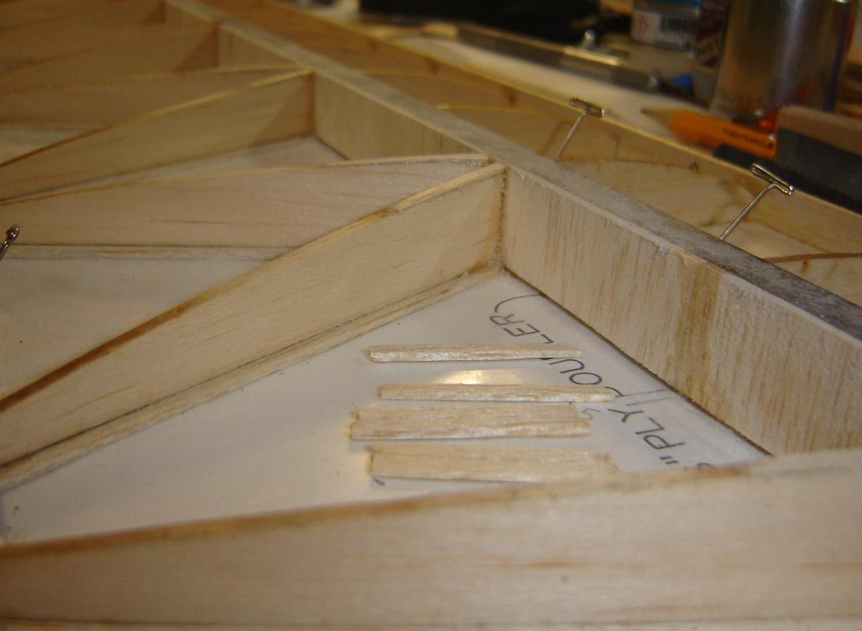

Some of the ribs were slightly too short for some reason but easy enough to fix. I just added strips of balsa and sanded to match the spar.

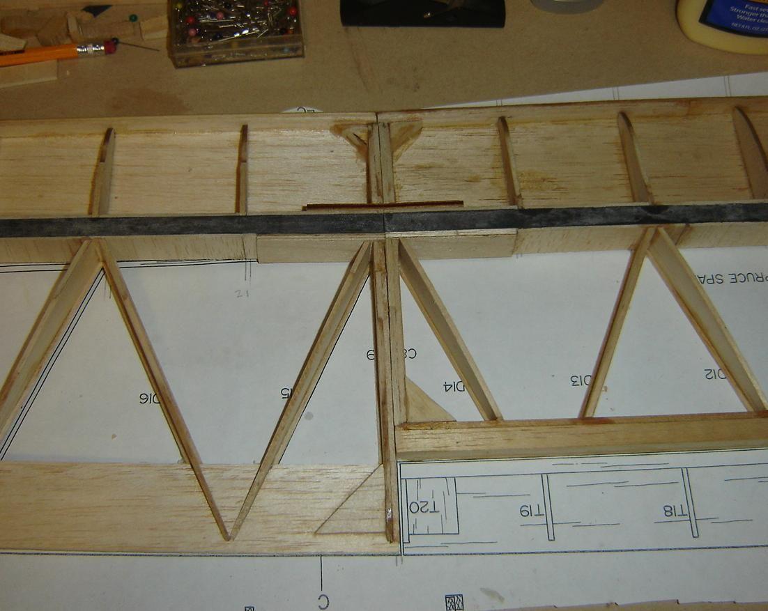

I beefed up the polyhedral joint. I installed 3/8" vertical grain balsa sheer webs between the spars on both sides of the polyhedral joint. Also doubled the ribs and made a larger ply brace behind the spar. I am using one of the smaller ply braces that came with the kit in front of the spar.
