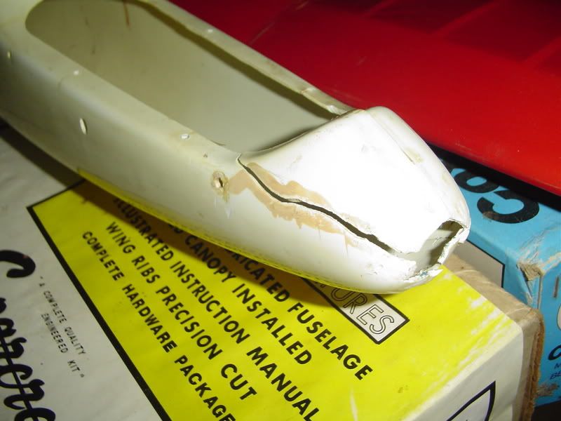

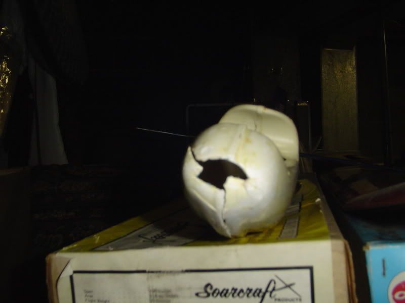

A good friend and neighbor gave me a badly damaged Soarcraft Centurion II glider. It came with the glider, Orbit four channel radio, the box, the blueprints, extra covering material, and some of the original hardware (balsa, plywood, etc.). It is missing the four plastic rivits that hold the mylar canopy on though.
The Orbit radio still works although all the electrial connections needed to be cleaned. Even the batteries charged and all four of the servo's worked! BUT I'm not going to use the Orbit parts for the airplane at all.
Damage: Nose is 90% there but many cracks in the plastic. Because the nose is cracked so badly, I'm going to have to do some major repairs to it. I plan on repairing it by joining the broken parts with two part epoxy. I built a new right elevator for it today (isn't CA glue the cats butt! so fast and easy too!), installed it (CA again), and re-covered it with the Monocote that was in the box (along with the blueprints for the glider!). The only thing I could find wrong with the wings is that the brass tubing for joining the wings together were plugged with dirt (possibly from sitting around or from crashing. I cleaned them out and installed new brass tubing in them and they appear to be OK.

Mike: Thanks for the kind words.
You think that adding 10 oz (or less depending on my choice of servos, battery, and receiver) to the original weight/wing loading would be critical?
Here are pictures the damage:

No, I wouldn't think that adding 10 oz is going to make a huge difference. What you have is a glider that was gifted to you that you can use to get excited about soaring. It's not going to be a competition ship -- it wasn't in its day -- but rather something you can use to learn some lessons from.
It looks pretty rough from your pictures so I wouldn't spend a lot of time fixing it up. Fix it, fly it, fly it and fly it until you get tired of it. By the way, that is a good sized plane on which to learn; anything smaller won't give you the reaching ability you need to find workable lift.
Start looking for another glider to build while you're learning to fly the Centurion. Sooner or later, you'll wear out the glider -- by breaking it beyond repair or outgrowing its potential to help you learn -- and you'll already have something built or on the building board. Ray Hayes has several glider suitable for a second sailplane:
