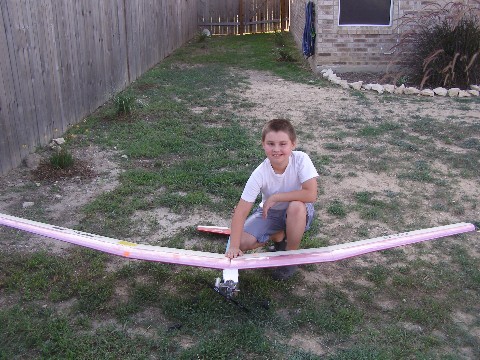

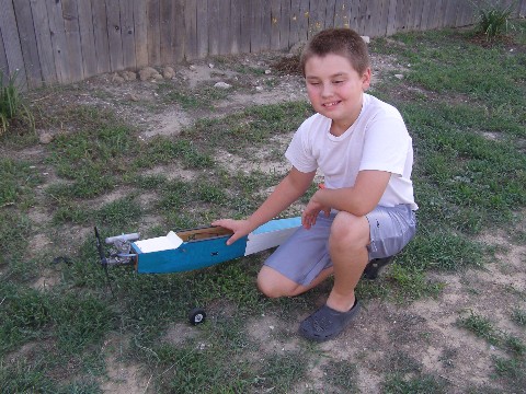

Here are a few pictures of this ugly fly. I will start removing and replacing the covering soon. Thanks

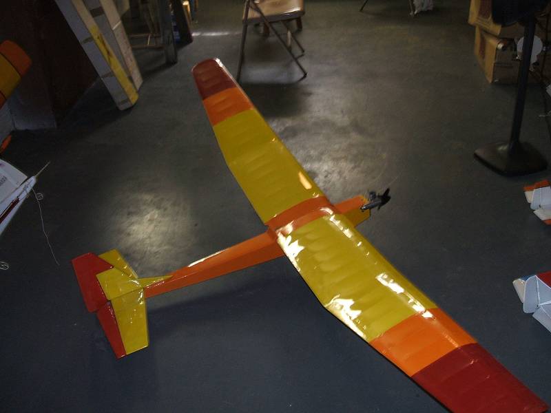

Heres my old Butterfly (1982or83), its not a Dynaflyte but a Craftair kit which was around before Dynaflytes time. Its powered by a OS 15LA now. First powered by a Enya 19 and had a Kraft radio. Then powered by a OS15FP which lasted many years and now the "New 15LA which is about 3 years old.
The CraftAir kit was really a terrible kit. The ribs and some of the wood was as hard as a rock and some of it soft as mush!!! The notches for the Turbulator spars were not even cut into the ribs and they were very soft balsa. I replaced them with spruce I remember. But the build has been worth it, the plane has hundreds of flights and many people have had there thumbs and fingers on the sticks.
People remark about how ugly the plane is on the ground but how beautiful it is as it soars in the sky, kind of like a Vulture!!!! Nothing like getting it up 3-400 feet and cut the engine back to idle, sit in a lawn chair and just work the thermals for as long as you can stand to look up before your neck gets sore.
One of these days I should convert it to electric, but the OS15 is so docile and easy to start and tune, that Im not sure it would be worth it.
Have seen many converted with cheap 550 size RC truck motors geared 3 or 4 to 1 that fly great. This plane would also lend itself to the A123 DeWalt power tool Li-Ion batteries also. and should fit in the nose OK. Saw one in Kansas with twin GWS 400 geared motors, 1 on each wing panel and it also flew great but the climb rate was not real good. He just screwed a nose cone on the motor area.
Anyway in my opinion one of the great kits to come along, others must feel the same way as it has had such a long production run.
Also I have a seperate fuse and use the wing as super floater sailplane as that is what the wing was originally designed as. Called the "Drifter" if my memory is correct.

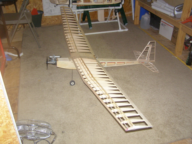

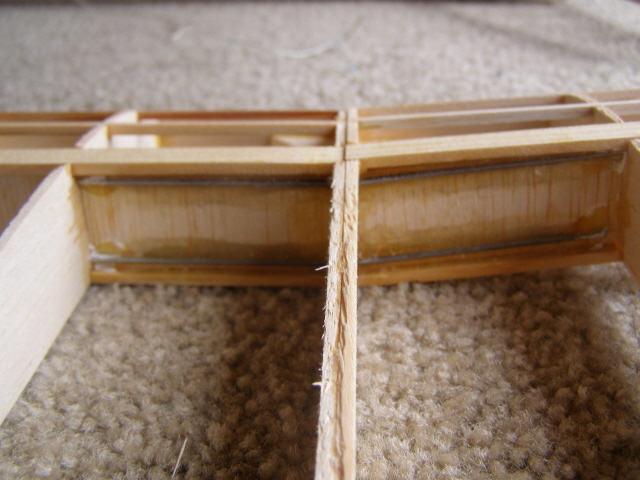

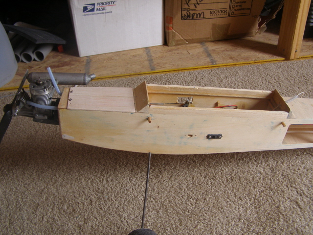

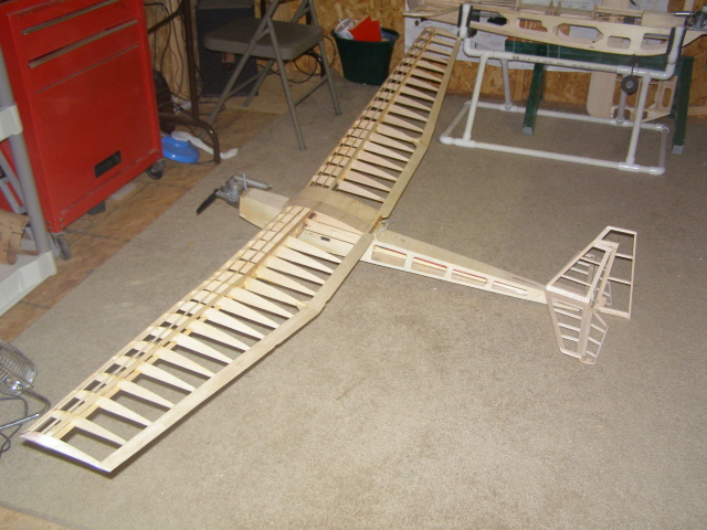

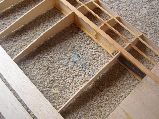

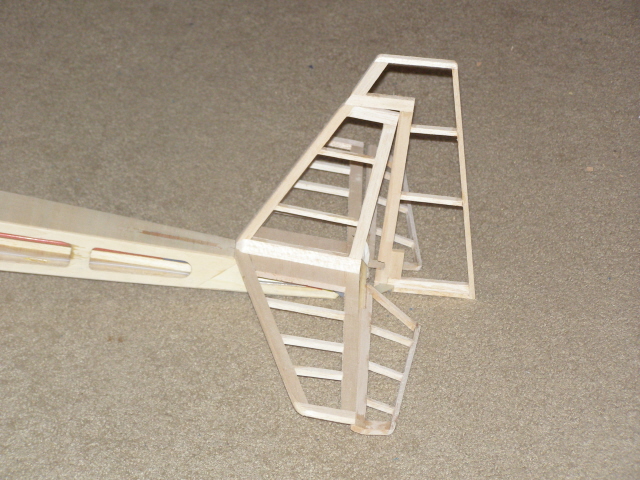

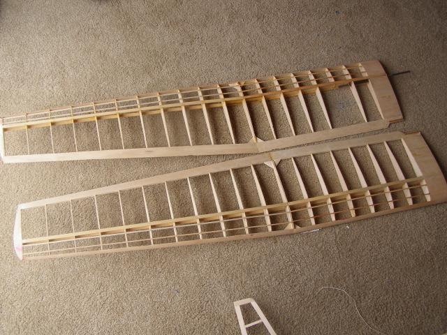

Hello I finally got all of the Monokote removed. That was a pain in the rear, I stripped most off with a heat gun then the rest I scrapped off with a razor bland and sanding block. The Acetone idea sucked because the color from the monokote sunk into the wood. Anyways I was able to get the tail rebuilt and ready to hinge. I still need to do a small repair to the leading edge, holes in the fuse sides need to be patched up. Last but not least there was a missing rib. i will build it tommorrow and then I will start covering this thing up. Cant wait to fly it again. Enjoy the pictures.

ooooh, naked airplane, not too bad be sure to post pictures of the covering job

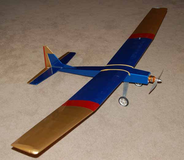

This is a picture of a Butterfly this spring for an older gent in our club. I did the maiden on it before I turned it over to him. It flies great. I built the wings with spoilers in them. The other mods are, a tail wheel and bolt on wings. I have another Butterfly on the board right now and should have finished in a week or so.

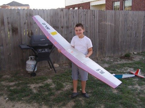

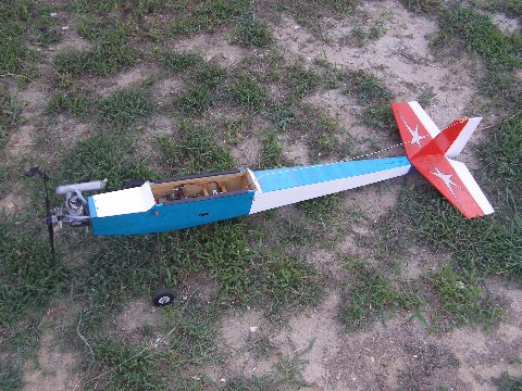

Hey does this qualify? Near as I can tell this is a Drifter II. When I got it it had tricycle landing gear and an enya .09 engine. I first put a geared speed 600 motor on it with a huge 8 cell NiCd pack. It flew well but was heavy. I just put the brushless motor on it but have only tried it on a really windy day and could almost NOT get the plane down. This is the original covering job from the '80s. A guy was retiring from RC and gave me all his planes to help out a Boy Scout troop. He said either give them to kids that want to learn to fly or sell them and give the money to the scouts. My kids went with me to pick up the planes and they got first choice. My daughter chose this big blue bird. It hung on her wall until she got into high school. The whole family ended up learning to fly RC because of this kind hearted gentleman.
I thought I would get this model up and running because I had some cub scouts show an interest in flying.
