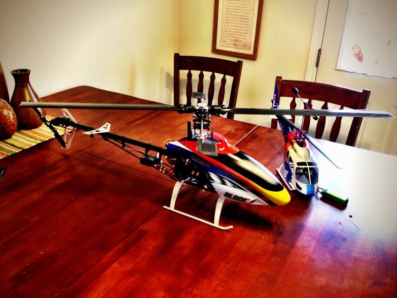

Well I went to local hobby shop and went against all the advice given to me I'm sure ill regret it but it is what it is. They sold me a blade 500 3D for $255
now I just got to figure out what radio and battery to go with.

I dont think you can go wrong with the Blade, based on your limited experience (Im assuming here).
Is it PNP(plug n play)? Or do you need a receiver too? I ask this because if it is PNP...it will be more economical to go with Spektrum radio. go with at least a DX6i...but I would go with the new DX7s if your budget can allow.
As far as battery goes...check the manual. Im sure they are going to recommend a 5s, but the blade 500 may be able to handle a 6s pack depending on motor and ESC. Again, all of this will be in the manual.
When it comes to batteries on the cheap...I like Zippy's. HK has them and they are a good "bang for your buck".
Im not really sure what is available "bolt on" for the Blade 500 as far as scale canopies go. But Im sure you can make it work somehow when the time comes.
Goodluck! And nice purchase, btw.

Hey thanks man it's a bind and fly. Yeah he said spectrum is the way to go also since it already has the receiver. It says it takes a 6s Lipo battery.
