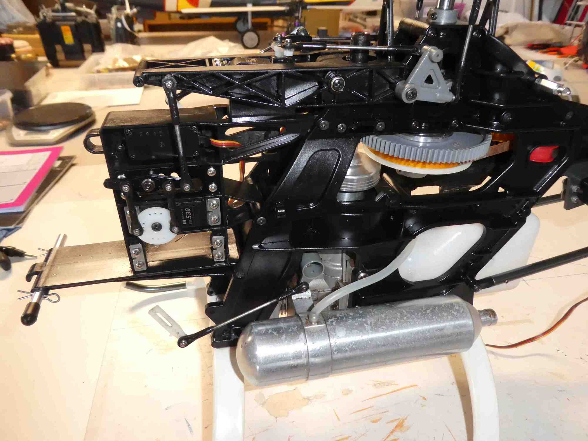

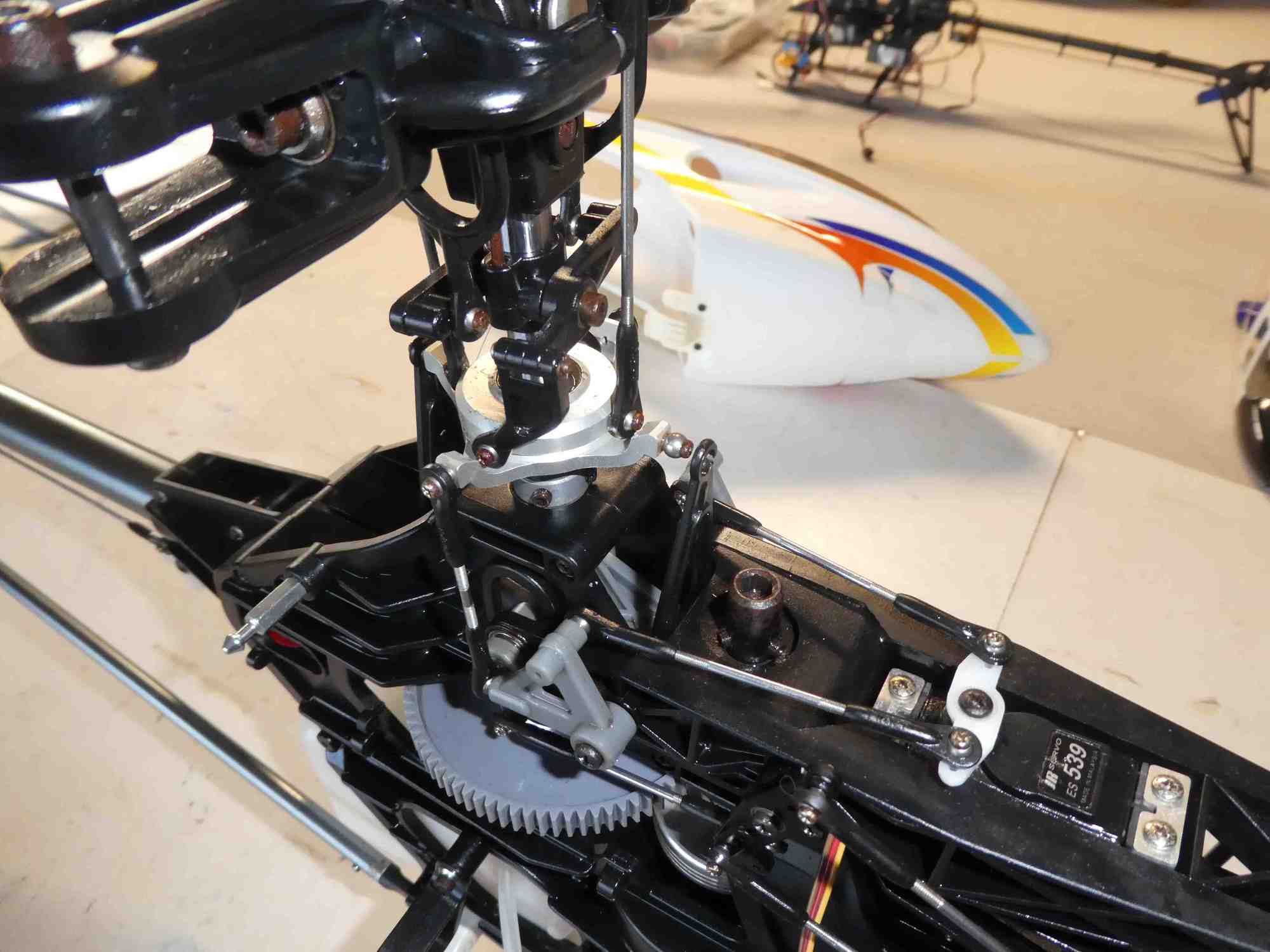

Still on Nitro, just this morn started to get going this horrible looking 50 size "TT Raptor", always hated that shokker canopy! LOL. 25 year old model, Local chap gave it to me to fix it, make it fly after it was sitting in an open shed for at least a decade!
I have never seen shuch a mess! Took me half a day just to clean it, now looking almost like new. Piston was seized and now the carby barrel is, just won't move!
I'm only hoping few days of Enox penetration might do some trick.
I have never run TT50, any idea how many turns of main needle on 10% N or should I mix more? Also what glow plug is ideal for this motor? Hot, med or cold?, when I'm ready to crank it up.
Broken plastic ball link on El. control arm, easy fix after minor mod.
Badly seized carby barrel!
Old 08-19-2022, 02:12 AM
Joseph Frost
Join Date: Nov 2010
Location: Coffs Harbour NSW, AUSTRALIA
Posts: 1,563
Received 71 Likes on 67 Posts
Won't be long, another Nitro soon ready for action after full overhaul.
Totally seized carby fully serviced.
Easy fix of broken El. control arm ball link.
Old 08-21-2022, 01:38 AM
Joseph Frost
Join Date: Nov 2010
Posts: 1,563
Running as new after today's re-maiden. Owner is delighted.
