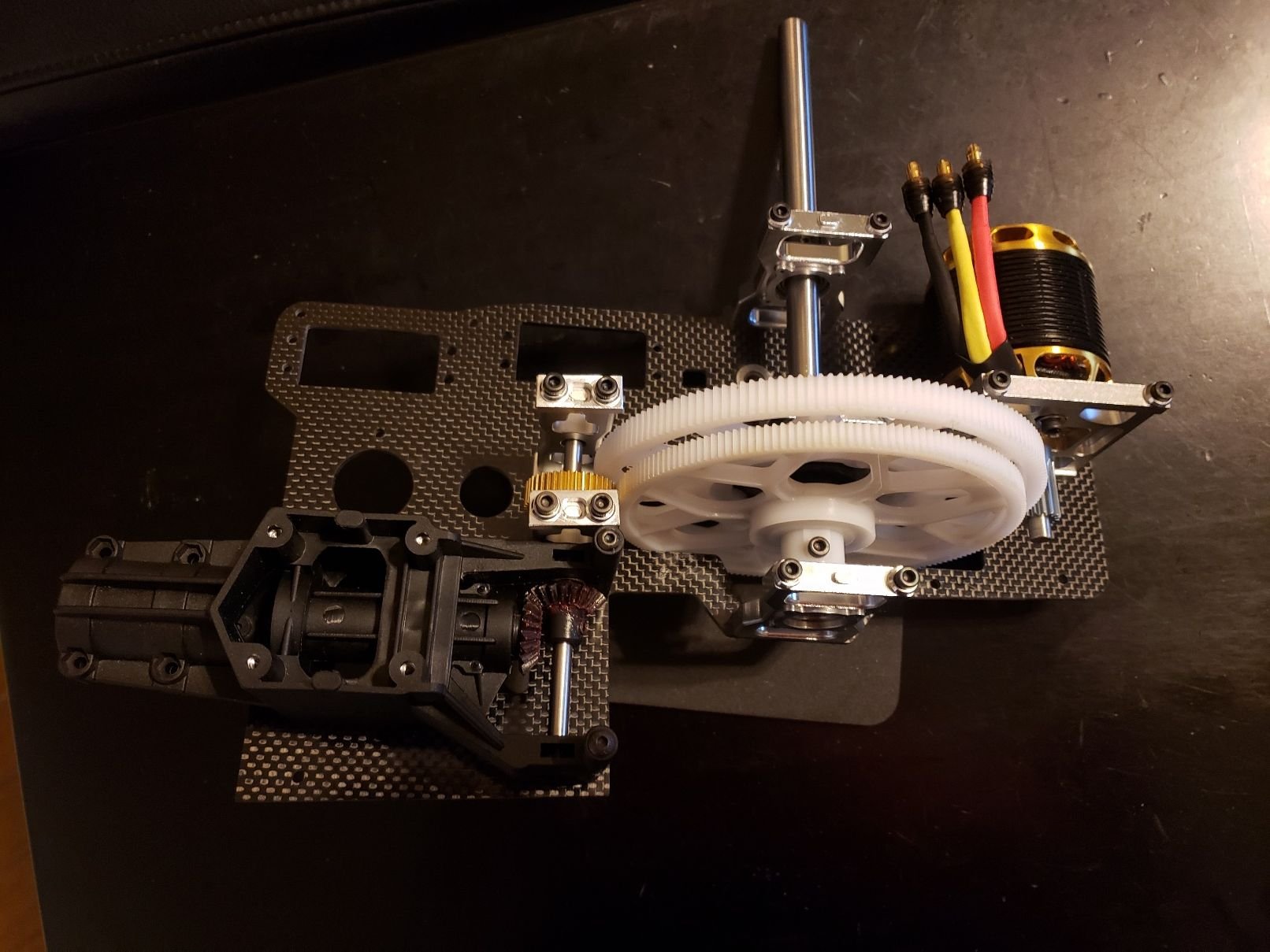

2. Unfortunately that's where the good stops. Too bad that I actually bought this to fly and not just to look at the pretty exterior. The kludged together mechanics was a mishmash of 47 mm and 54 mm Roban / Phoenixtech (knockoff "Align" 600 esp) parts for a 54mm frame. When I opened up the Phoenixtech mechanics that was supplied by MRC as part of their deluxe combo I was shocked. Not only were there wrong parts there were also plenty of missing parts and parts that I was told needed to be replaced or the gears would shear within seconds of the first flight. I tried to get MRC to pony up the parts, but no luck since I was outside their 30 day "fogettabout" it window.
Spacers included for the tail drive bearing block were too narrow. How difficult is it to subtract the 7mm difference of the 54 mm and 47 mm blocks and take that missing 7mm and divide it into two 3.5mm spacers? I also ended up buying over $250 of parts early on that were either wrong or missing. Some parts of this less than stellar mechanical design don't even exist... i.e. be ready to machine your own parts such as the correct 3.5mm spacers and a self lubricating bushing for the tail drive shaft.
I'm sure there are exceptions to everything but I've only ever seen heli bearing blocks where the bearing was either a press fit or held in by retainer rings. This model included bearing blocks where all bearings fell out of the blocks.
Easy for replacement, but terrible for building a reliable and safe model heli.
The new MotionRC / Roban knockoff thrust bearings were total trash! Weird thing about thrust bearings is that they can feel just fine but when you fly them they basically try to lock up and create a slow tail wag that NO controller can deal with. The Phoenixtech tail assembly was a disaster. I've never seen so much slop. I had to replace the entire tail assembly with a genuine Align tail assembly that included the upgraded tail bevel gears. MotionRC told me that the gears that they supplied me would shear in seconds of the first flight. No big deal it's just another $125.

Mix of 54mm and 47mm parts supplied by MRC
Assembled side frame complete with the REQUIRED third main bearing block which I also had to buy.
