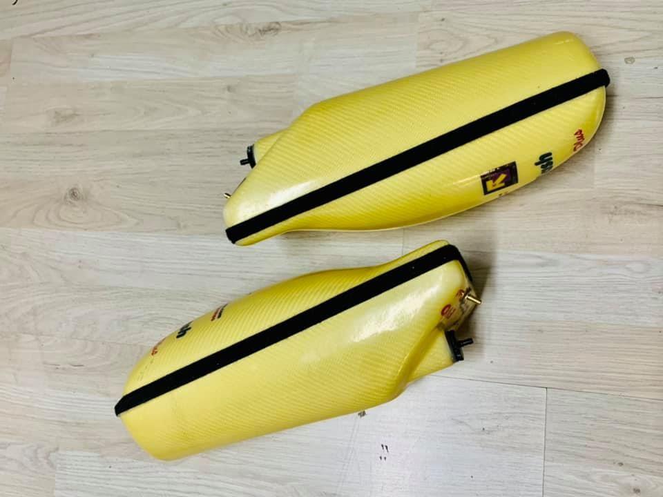

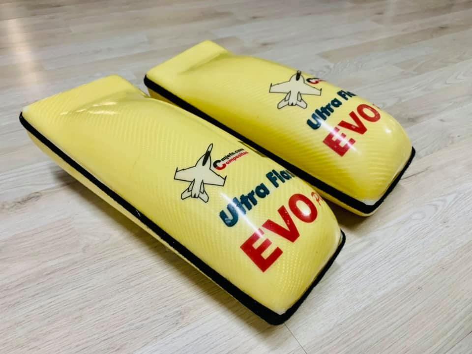

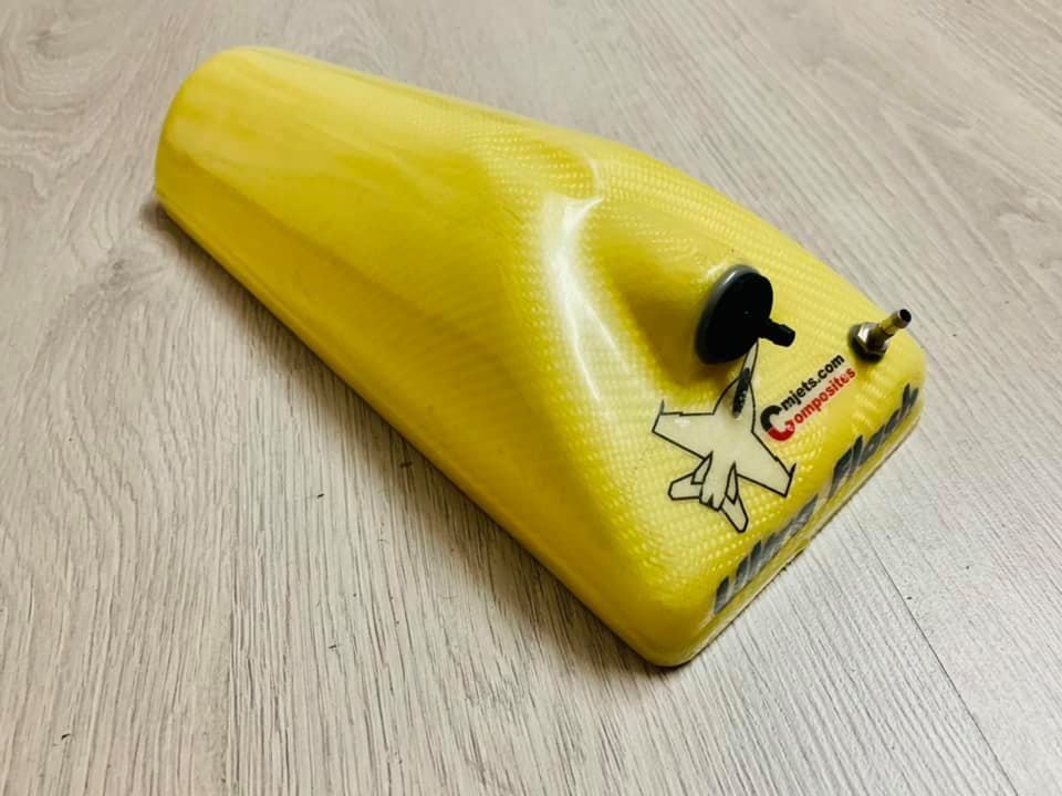

Hello, full set tanks for UltraFlash, Wing tank, saddle tanks and main kero tank in 3 sizes, 2L, 3L and 4L. Only in CMJETS Tanks.
https://cmjets.com/28-craf
BR from Spain.
Carlos
