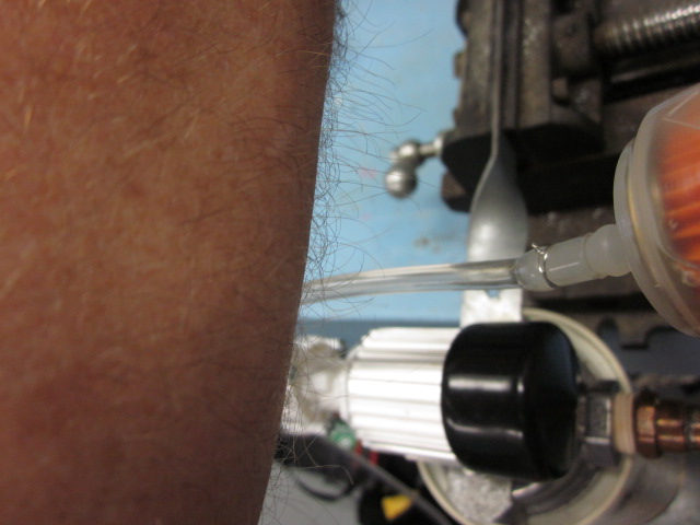

HI all, today I mixed my 50 gallons of kero, as I do each year. This time I bought a 10 micron filter and pump.
The first thing I noticed, after I set up the system with the filter on the suction side, I could never stop the air bubbles, so I put the filter downstream of the pump, and worked great.After the first 15 gallons went through, I thought I should add another small filter on the suction side, a new pump and all, did not want to wreck a new pump. Well guess what, air bubbles again, and no matter what you did to the oriantation of the small filter, their was air bubbles.
Conclusion, Jetcat and Jet Central say install the fuel filter , down stream of the pump, they are right, never install a filter on the suction side, the filter ,actually separates the air from the fuel.
I also noticed the static electricity formed at the filter. look at the second pic of the hair on my arm, and then when I move my arm close to the filter, see the hair stand up.
Rcpete

ORIGINAL: rcpete347
... the filter ,actually separates the air from the fuel.....
I do not agree.
IMHO your photos show that you have an airleak.

ORIGINAL: rcpete347
Yeah, I get hair days like that too.

Tell me MR Greese, how is it that their is air bubbles in the small filter and fuel line, before the pump, yet you remove the one piece sealed filter on the suction side and their is no air bubbles in the line between the small filter and pump.
And by the way, where did you get the idea , I was useing Festo fitting, do you see Festo fittings, Their are no festo Fitting.
Rcpete

It's not air in the filter. The pump is causing low pressure in the filter and the kero is flashing off into vapor. Once the flow slows the pressure rises and the vapor recondences into kero. Mine does it all the time...no leaks.
Mike

HI, I was waiting for some one to say that, same principal as in central air conditioning, reduce the pressure and the liquid flashes off to gas.
So far, I have tested the PST air trap,and have flashing off at 27 oz."s per minute, I'll have to go to a smaller pump to see when it stops.
I would like to see manufactures rate their UAT's/Air traps in maximum flow rate before the Kero flashes.
Rcpete

That too, u don't want a bit of fuel pump causing your fuel velve to stick open. That's one ticket to a fire.
But Pete's absolutely right about the air coming out of suspension in the fuel if there's enough suction.
If you've ever been a scuba diver and understand what's going on there, then think of this as your fuel system getting "the bends".

Kero has air entrained in it. Lower the pressure such as creating poor inlet conditions on a pump, and you will find air bubbles. Give them a place to collect like that filter housing and you've got air....
What does seem strange is that the filter size seems pretty generous for that pump size, and yet the results are pretty dramatic. I would more expect to see milky colored kero and not copious quantities of air.
