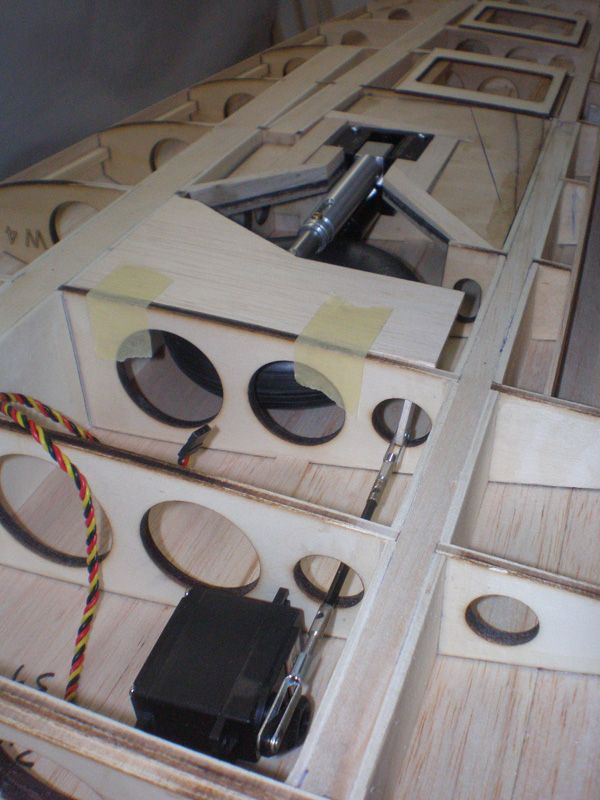

In last two months we are working on the Galeb G2 wing. If you remember, Galeb G2 will be exactly 1/5 scale of real airplane.
I have few conceptions how to made a wing, and finally with the help of friends, who are mechanical engineers, we find, I think best solutions.
Don't forget, I want to made and sell kit from this model, so I must thinking how modelers will be the easiest and most convenient to make this jet.
Galeb G2 will be wooden kit, with few plastic parts - canopy, wing tips...
We are working on the wing first. Here is some pictures, how it look in this stage...
Wingspan is 81" or 2060 mm, with tip tanks 91,3" - 2320 mm.
Landing gears are in the middle of the wing, and they determine the structure of other parts. Because that, main spar will be two piece, with fold over three ribs.
In space between front main spar, will come big wooden wing joiner.
Small wooden wing joiner will be in the rear spar.

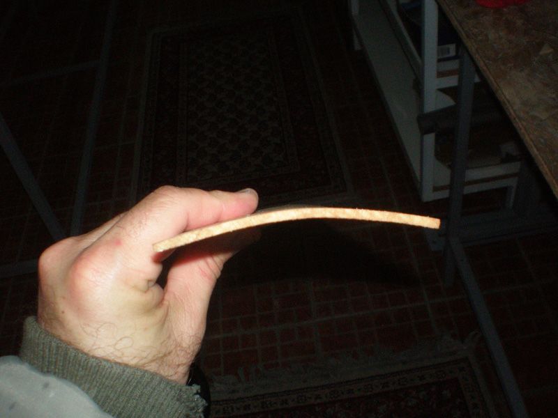

Ribs from the root of the wing to the end of the landing gear panel, will be from poplar plywood, and ribs to the end of the wing will be from balsa.
Space between spars will be closed with ply or balsa plates, and that will give stiff and strong construction.
Ribs will have washout for better stability on slow speed. Tip tanks will just increase that stability.
Tip tanks will be made from two part plastic. In kit will be balsa construction which will be glued on last wing rib. On that construction setting of the tip tank will be very easy job.
Landing gear plate will be made from 6 mm plywood and it will be glued on the front and rear ply which will connect upper and lower spars. That will give strong support and help with bad landings.

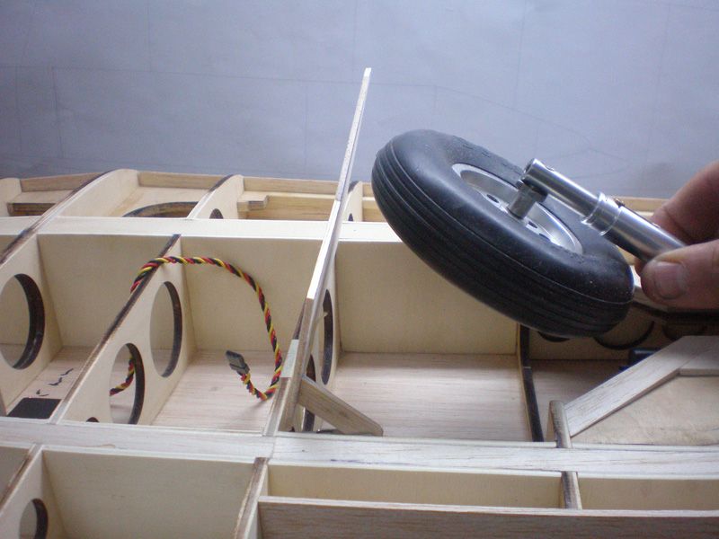

As I write earlier in this topic, I bought landing gears in German firm Behotec ( www.behotec.de ). They are top quality...
Front leg...
Main retracts...
And few pictures of difference in size between Ziroli Panther and Galeb retracts...
Here is pictures of wing & retract construction...
Galeb G2 have very short main legs, so I have a problem to find exactly 1/5 scale retracts. This Behotec is best option for that...

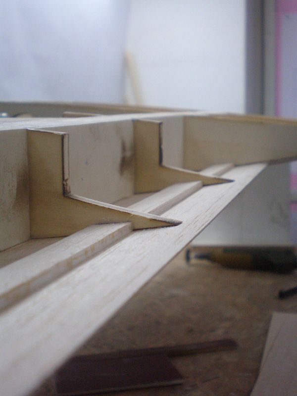

Martin started work on the fuselage and wings blend...
Flaps...
From other angle...
Flaps is similar like on P 47. When flap goes in down position between flap and wing is opening gutter for air flow. That give better stability on low speed when flap is in lower position...

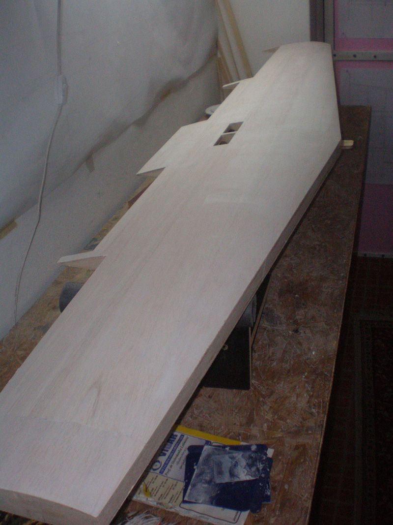

Yesterday I spent almost all day in my work shop.
I start working on right wing side...
... and because everything fit well, after 45 minutes, right wing panel was in this stage...
I must just a little bit sand slots for wooden wing joiners...
...and then i put left wing side in position, for now without glue, just to check is everything OK...
Than I add glue...
After few hours I took off wing from the work table. In spar slots, on the bottom side I add balsa strips, same as I worked on upper surface...
... than sanding, and all transitions from ribs on spar was nice and smooth...

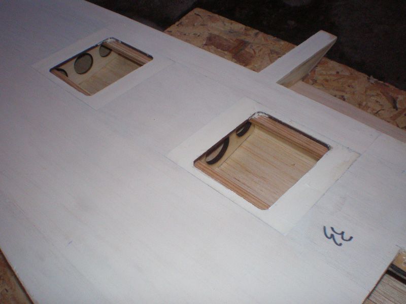

Next step will be to add 3 mm plywood plates between spars and ribs. This will be boring job...

In last few days I made all ply plates between ribs and spars. As I told, that was boring job, but must be done.
Because this is first Galeb G 2 model, prototype, I find some things which can be changed.
One of these will be this part of building, making plates between ribs and spars. Martin change drawings and now this plates will be in one piece in which will come every rib, something like "comb". That construction will immediately position every rib exactly on place and will close space between ribs and spars...
Of course, few more little changes will be done in construction, but that is just details...
As I told I made plates...
I chack how balsa will lie down on wing...
Other test was be with ruler...
I sand all spars at the end...
I glued outer servo plate...
Few picture of the wing before sheeting...
In this stage I must admit that wing is extreme strong. I measured everything and weight is maybe little higher, bur in case to use smaller spars, thinner ply ribs and few other details wing will be maybe 300 - 400 gr lighter.
My goal is to made strong model which I will fly from pretty rough terrain we have here on our airfield.
Don't forget position of the wheels in the wing that must withstand the occasional rough landing...
All in all, I'm pleased with the results so far...

When I got those parts, I first glued 2 of those 3 mm ply in one piece. For this I used epoxy glue...
New parts fit in the wing very good...
Same story is with landing gear plates...
I set landing gear on plate, fix it with screws, and set all together on the wing...
Landing gears come from German firm Bechotec, and they are for models up to 16 kg (Bechotec - C 40)...
Under landing gear plate I made support ribs to which the plate rests. Martin again made drawings, and Dragan cut parts...
We have dilemma whether to make plate from 4 or 6 mm ply. Decision was made to be thicker, but in that case, because landing gear angle, I need to sand down one corner of the plate.
That was done in 5 minutes...
When balsa come above, it will be like this...
Next step was to glue everything in the place. Before that I made final measuring...
I put one 10 mm balsa on each side to get exactly distance between wheel and rib...
Ruler show exactly same distance in the middle of the wing...
Than I squeezed landing gear...

First, I sand surplus on the ribs from rear rib flap part...
Next was to sand trailing edge and made two small ribs on the both area sides...
Than I glued vertical balsa plate...
Ruler was used for perfect direction...
With horizontal plate work was done. I used two harder wood plates to fix trailing edge to stay flat...
After light sanding, wing look like this...

I made holes on the upper wing surface for opening for inner landing gear servos. This parts in kit will be change too, and will be made from ply, similar like parts for servo openings on the wing bottom side... Martin add this to plan too...
Yesterday weather was here like in spring, so I used it to sand wing and add acrylic filler on the surface.
I need to buy bigger and bigger packaging...
This is acrylic filler I used... It's very easy to sand down...
This filler you must add in very thin layers.
After surface get dry, I add filler on other side too...
Than... O man... I sand wing almost two hours...
First with sand paper grade 100, and after with 240...
After cleaning, wing is smoother than baby ass...
And edges?
Now just to made leading edges, ailerons and flaps. For that I will need about two three days.
As you can see, it took me about three weeks to make a wing.
Don't forget, I wasn't work every day, my calculation is that I spent about 40 - 50 hours for wing in this stage...
