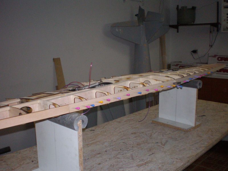

I was working on the wing and made the right half also, compiled it and did a lot of "small works" ...
Under both halves in the same places I put parts of balsa, which give right angle for both wing sides...
I put the spars and the wing joiners into place (and still everything worked without adhesive) and measure distances ribs distance from working table on the left and the right side...
When I realized that everything was fine, I glued two middle ribs with white glue, again measuring the distances...
When glue was dry, I put and glued rear and front wing joiner...
It was followed by a break to allow the glue to dry, and I continued to work aligning spar and bayonet, in order to obtain an ideal surface for plates to close the box between spar and wing ribs ...
Ends of the spar was even, in place are plates for pneumatic cylinder for gear inner doors...

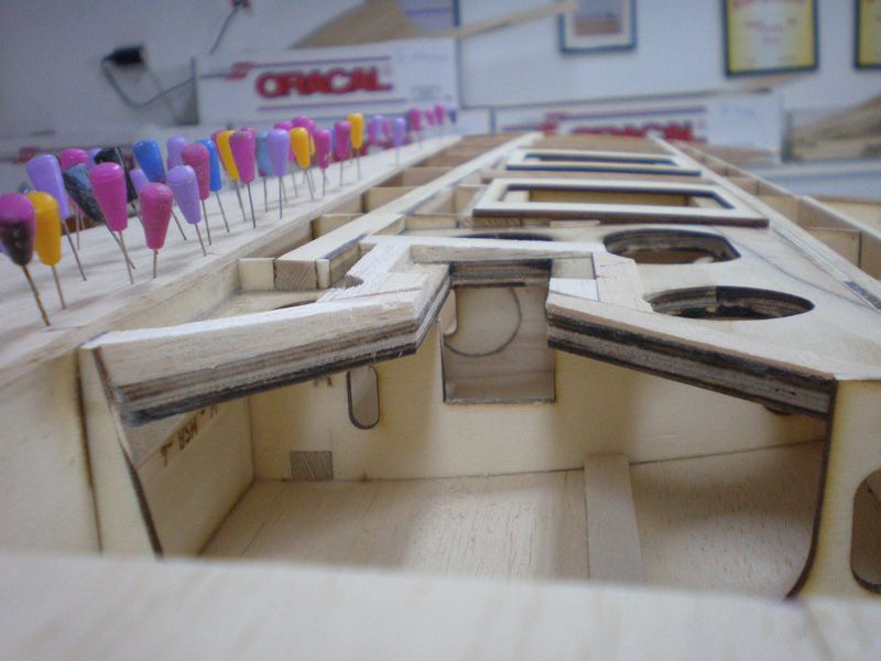

On this wing, same like on the first, some spars are a bit recessed into the wing ribs. This was done to keep the groove for balsa strips. Balsa is much easier to handle than fir in order to get the proper shape profile.
Next was working on some small details on the wing...

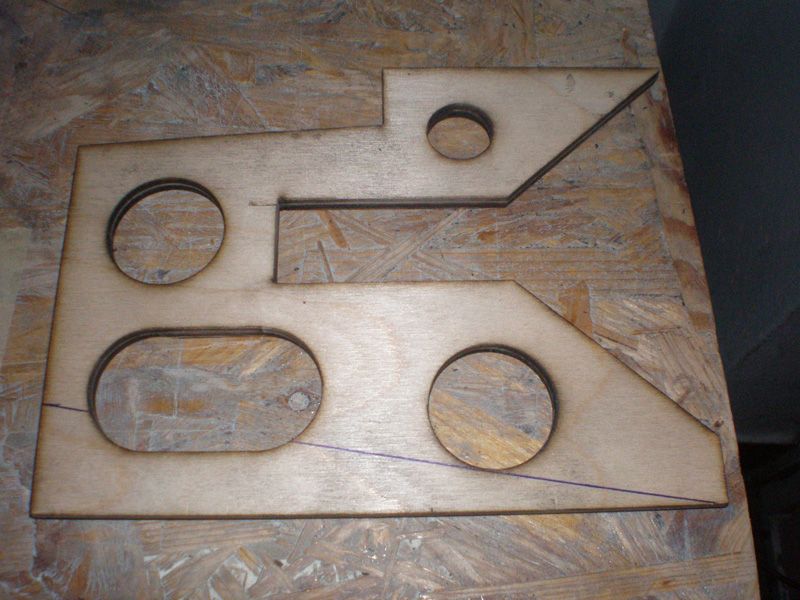

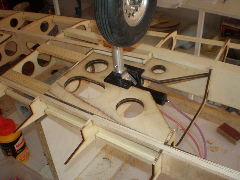

Dragan, guy who cut all parts on laser cut machine, bring me gear plates and front pin. Those parts was made from hard plywood. Every part was made from two pieces, because it's easier to laser cut machine to cut parts like that, because thickness of ply. Dragan glue at the end parts together...
After I sand down glue from the edges, parts was glued...
For landing gear plates we made few extra balsa parts for better and easier position of the plate in the wing. But, I used only one of those five parts, that one which have profile shape...
Different between this and plates for first model, was in holes on plates surface...
It need some time to fit plates to come perfectly inside of the wing...
To get right landing gear angle and same like on the first G2, I must sand down one corner of the plate...
Before gluing I check is everything OK...
Finally I glued landing gear plates. Now you can see that instead of balsa plates I put triangles...

Last step was install landing gears in position...

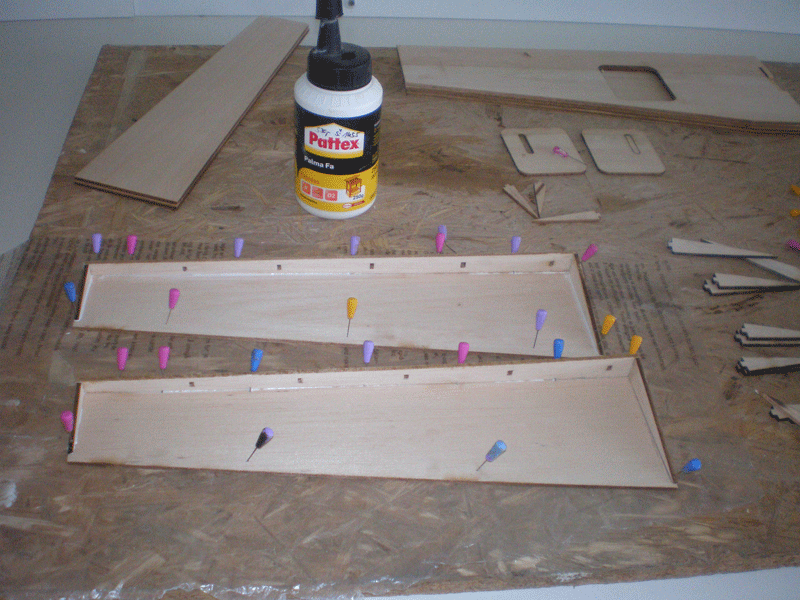

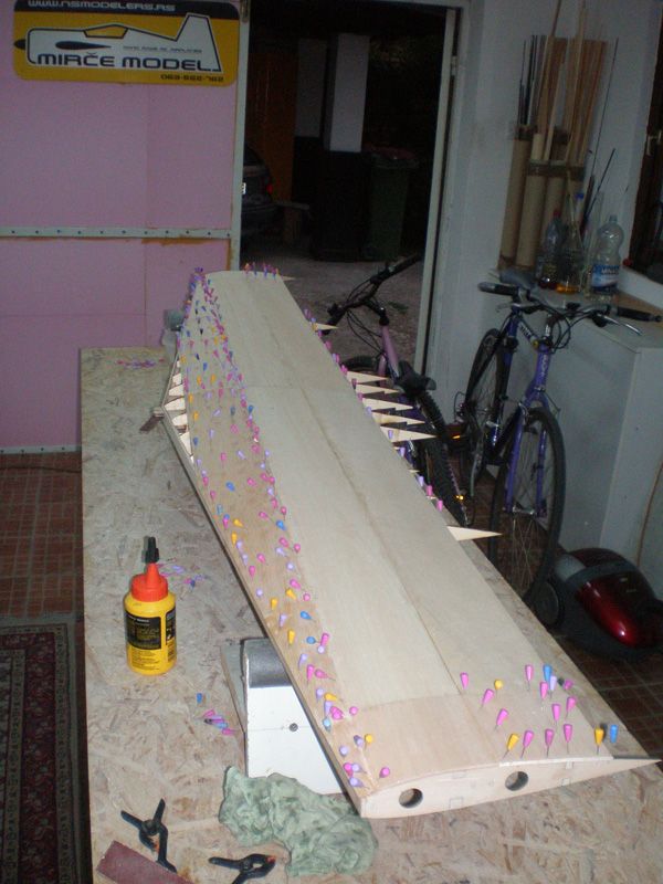

Because construction was finish, next step was covering wing with 3 mm balsa plates. From my friend, owner of the hobby shop here in Serbia, I ordered balsa sheets, and asked him to measure every plate and send me lightest. When I got them I saw that every 3 mm plate is about 30 gr, very good weight for that thickness...
First I cover upper side, starting from the middle...
For guide I used middle of the front spar.
Balsa sheet is shorter than wing half, so I must extend them at the wing tip. I glued small balsa plates to made support for next balsa sheet...
Than come balsa plates in front and rear of the first one. Those which come in front I wet with hot water, to soft them and easier apply on rib shape...
Few small balsa plates on the rear end and wing was almost cover on the upper side...

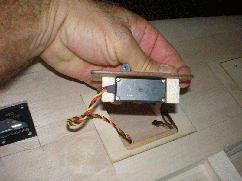

On bottom side in flap area I made two pieces of balsa. They are easy to for set, because they lie on the exactly place on the ribs...

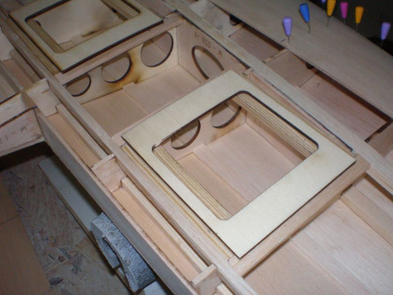

I glued plates for wing screws...
...and apply first balsa sheets on bottom side of the wing...
On landing gear plate, around of the place where gears come, I must made support for next balsa sheet. I glued balsa blocks and sand them to shape of the bottom wing shape...
Left and right of the outer servo plate I add small balsa plates also...

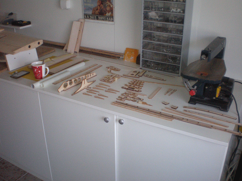

As you know, one G2 in 1/5 scale was made. That model show where we can made some changes, two biggest, reduce weight and made better air flow in rear part of the fuselage.

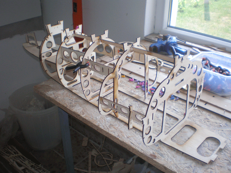

Before we come here in Senta, I made almost complete new wing. Martin, guy who work on 3D drawings, rewrote almost all fuselage ribs.
Weight problem will be fix with using 3mm ply (instead of 4mm used on first model), different way on doing panel lines, using some lighter parts and adding more holes on parts for reducing weight. I think, with that changes from model can easily take down 2 kg, maybe little more.
Change fuselage ribs design will help to more air come in rear fuselage part.
But, biggest change will be in turbine and thrust tube. Instead of Jet Cat P 80 and thrust tube of 90 mm (with double wall it is almost as wide as hole on last rib), I'll plan to use now Wren 80 (or 100) which is more than 20 mm smaller in diameter. Thrust tube is smaller also - 72mm, but at the front, on bellmouth is just 82mm!!! Jet Cat's bellmouth was 140mm and cover almost all space inside of the fuselage...
Hope that changes improve 1/5 scale G2 a lot...

Workshop is slowly filled with parts. Few days ago wing and other parts come back...
I start work on parts immediately. First I glued balsa sheets for elevators...
Than I want to put elevator ribs on trailing edge, but unfortunately some ribs are missing.
Some other small parts are missing also, so I need to send file to my friend Dragan, to cut all parts on laser cut machine.
In meantime I send to Dragan file with all fuselage ribs for 1/5 scale Galeb and another file with ribs for three piece wing for bigger 1/4 scale G2.
As you know, projects like this depend from many peoples, so here is same situation. Many participants in this story you know from earlier.
One of them is Misha, who print plans in his firm. Yesterday plans for wing and elevator of the bigger G2 arrived...

Yesterday few parcels with parts arrived from Dragan, my friend who cut all balsa and plywood pieces on his laser cut machine.
That are just parts for fuselage for smaller scale G2 (1/5) and for three piece wing for bigger one (1/4 size).
OK, there are few parts which missing for elevator, rudder and some other circuits...
In meantime, while I waited for this, I made servo holders for ailerons and flaps...
For extra safe I always add small screws for wooden block...
This system I use on every my big scale model...
As I told, I got ribs for wing for bigger G2...
I put rib 1 on on the middle of the smaller wing. Difference in size is obvious...
Until I wait to get ribs for fuselage for smaller Galeb, I prepare template for ribs position.
For this model you don't need plan for work on fuselage, because ribs comes in slots on template...
I use template from my first Galeb, which have 4mm plywood ribs and now ribs are from 3mm plywood. Because that you can see small gaps between rib and template.
This pattern will be part of future kit and then slots will as wide as ribs...
Ribs shape are much different than on first G2. Outer shape are same, but inner are different...
Few more pictures about fuselage parts...

As I promised, not to wait long to continue...
Elevator moving parts.
Planks are part of laser cut kit...
For now I stop here with building this segments...
As you can see, no any plan is required. For this model plan is required just for wings...
Elevator is build with same technique...
Front part is not glue yet. I use it now just for better ribs position.
When all ribs are on place I glued front ply part...
On it, next come 3mm balsa for leading edge...
As you can see, elevator is still on work table...
In meantime I start apply various reinforcements on fuselage ribs...

Building fuselage I work in four stages.
First I work on front part...
When glue was dry I add small part on the bottom side...
This are ribs for front removable section. They come at the end of fuselage building. But, rib 1 I use for position fuselage front...
Fuselage central part...
At the end of the day Fuselage was in this stage...
Work on the rear end will be in next few days...
Before the bed-time, I've applied upper balsa plank...
Those balsa planks are also supplied in kit...
For gluing I use ZAP glue...
