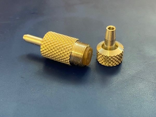

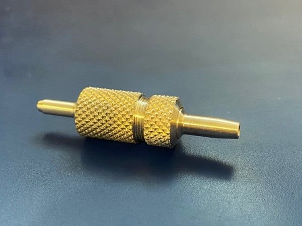

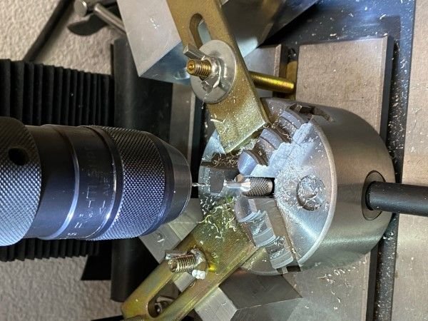

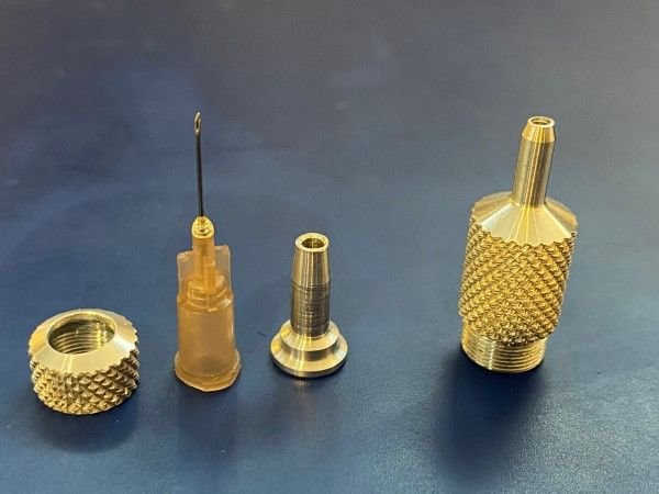

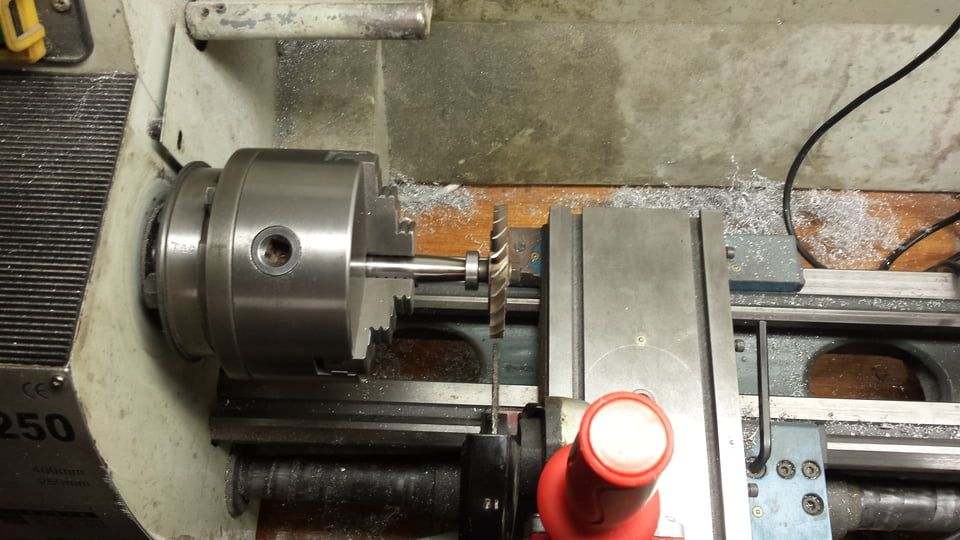

Here a short update from my side. Still make some slow progress. Figured out what may be my main problem: The lubrication! here my idea to test that with different injection needle. Here a few pictures
turning some fine threads
needle inserted
fully assembled

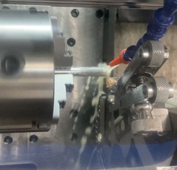

the cool thing of cnc machining

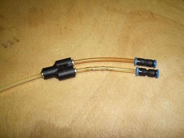

Nice tool! As mentioned before I nowadays always use the robart airline restrictors, 2 in series which is adequate. When you're gonna test these it might be interesting to make a view glass for some kind so you can actually see the flow rate. I made this set-up many years ago from a syringe, M5 threaded aluminium cap glued on. At idle you can see the drops falling down, approx 3 drops per second. All commercial engines have the restrictor inside the engine. I elect to keep it outside so I am able to see fluid on the other side..or not and stop the engine.
I used yours as well, worked oke. I turned the outside a bit smaller and squeezed it into the fuel line as shown;
Set-up on all my current engines;

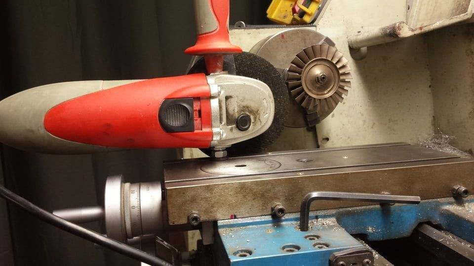

could you plz. let me know the jig/fixture you used to machine the turbine blade? I have to machine one and thinking not to ruin it. Carbide tipped tool would do?

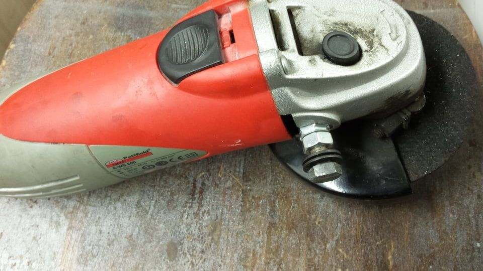

Don't try to turn it off by means of a chisel, it's too hard and blades my damage. It needs grinding. My way is somehow rudimentary but if carefully done very precise. I use a 115mm grinder fixed to the lath. Make sure the lath turns the other direction of the grinder. Take very small steps in a time. The picture shows the main shaft installed but that's only for showing. Use a scrap steel bar and turn off the turbine shaft fit and a screw thread to fix the wheel. This way you are sure it's dead center.

That helps. I will do this way only. grinding little bit every time.
