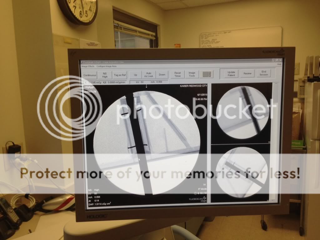

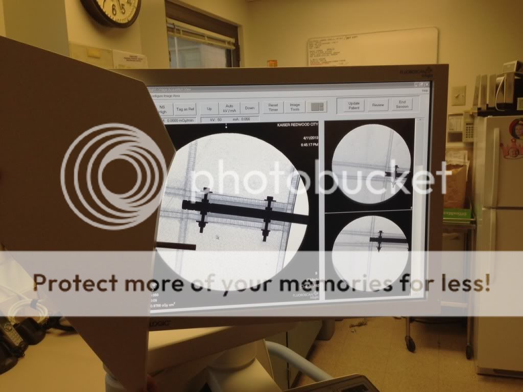

Alright guys. Here are some xrays.
First is this CRAPPY fried beagle F-16. See the small scragly little wires that are the crossmembers for a HUUUGGEE stab? This has to be TOTALLY taken apart, pin, resloted and re-inforced with carbon fiber.
This one from the F-14. The "new style" honeycomb structure. I'll post in Dantley's thread as well.
There are good looking bolts, but it seems that they maybe inserted against more honeycomb. WHICH I WOULD NOT TRUST TO HOLD THE JESUS SURFACE OF ALL JESUS SURFACES!!! [:@]
