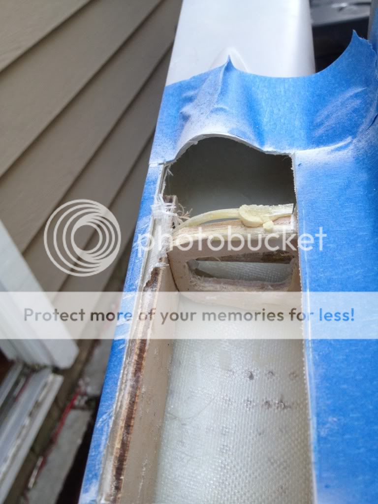

In lieu of a long list of airplane deaths from ALL these chinese manufactures, I'd like to point out some obvious defects.
The fly eagle 1/5.5 F-16 had been known to have some elevator issues, ie, fluttering inflight, loss of control, etc....
And a recent loss of over $20k from a fly eagle jet, I'd like to caution EVERYONE to check and reinforce their ARF's.
I am in the middle of building an the older Fried Beagle F-16 1/5.5 and this is what I found when I cut into the elevator components to check for strength.
GULP!
Do you see substantial glue? And in some places, NO GLUE??!!!

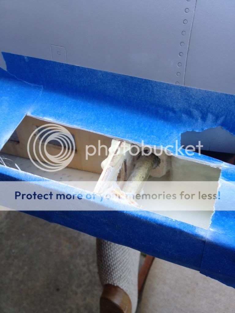

And the Vertical Stab mounting area looks the same.
This will all have to be reinforced.
After seeing this, EVERY piece of this airplane will have to be gone over with a fine toothed comb. Too bad BVM doesn't make more scale models.

Raf, what am I looking at? Is that the main pivot tube for the elev? And then we need to see inside the elevator itself.

I think there are 2 things disturbing here. The first most evident is those "spars" are obviously not bonded well to the skins. And secondly the tube is not bonded well... to anything. it almost looks like it is left lightly suspended with no cohesion to the "spar" or rib. The other thing is I have to question the entire structural intent and design. For that I would need to see more.
If you go inside a barf or a flash, you'll see they do a very good job of bonding any and all of the spars or ribs to the skins. (I wasnt a big fan of the way they ran the grain on the main spar but it's clearly sufficiently strong to take the shear loads and the fundamental design is good)

on mine i have changed that area and made a 16mm aluminium tube with ballbearings inside, and glued the spars
olnico made this plane a long time ago

Mine crashed due to elevator failure in flight. Saw the elevator give and fold down and back. It crashed and burned. Total loss. Hard lesson to learn. I will not buy from them again- ever.

Yup, you guessed it Darren. I'm going to use some of the x-ray machines at work to see inside. I totally anticipate having to go into them and strengthen them.
