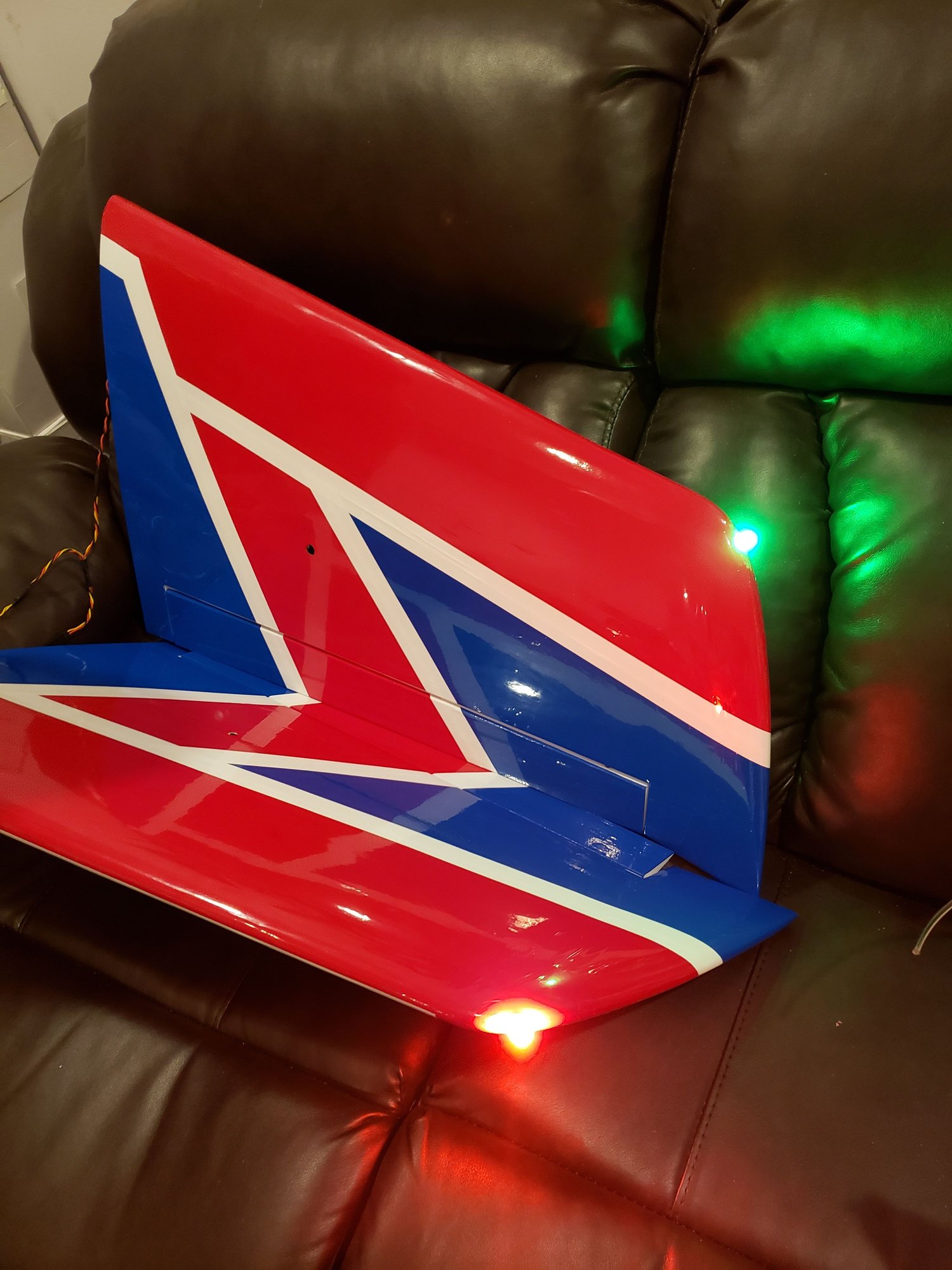

Default Led's
Got called off today so I decided to add some super bright ledo's from Booma rc. The run off of straight lipo up to 3 cell. The are WAAAAAY brighter than I thought they would be.
