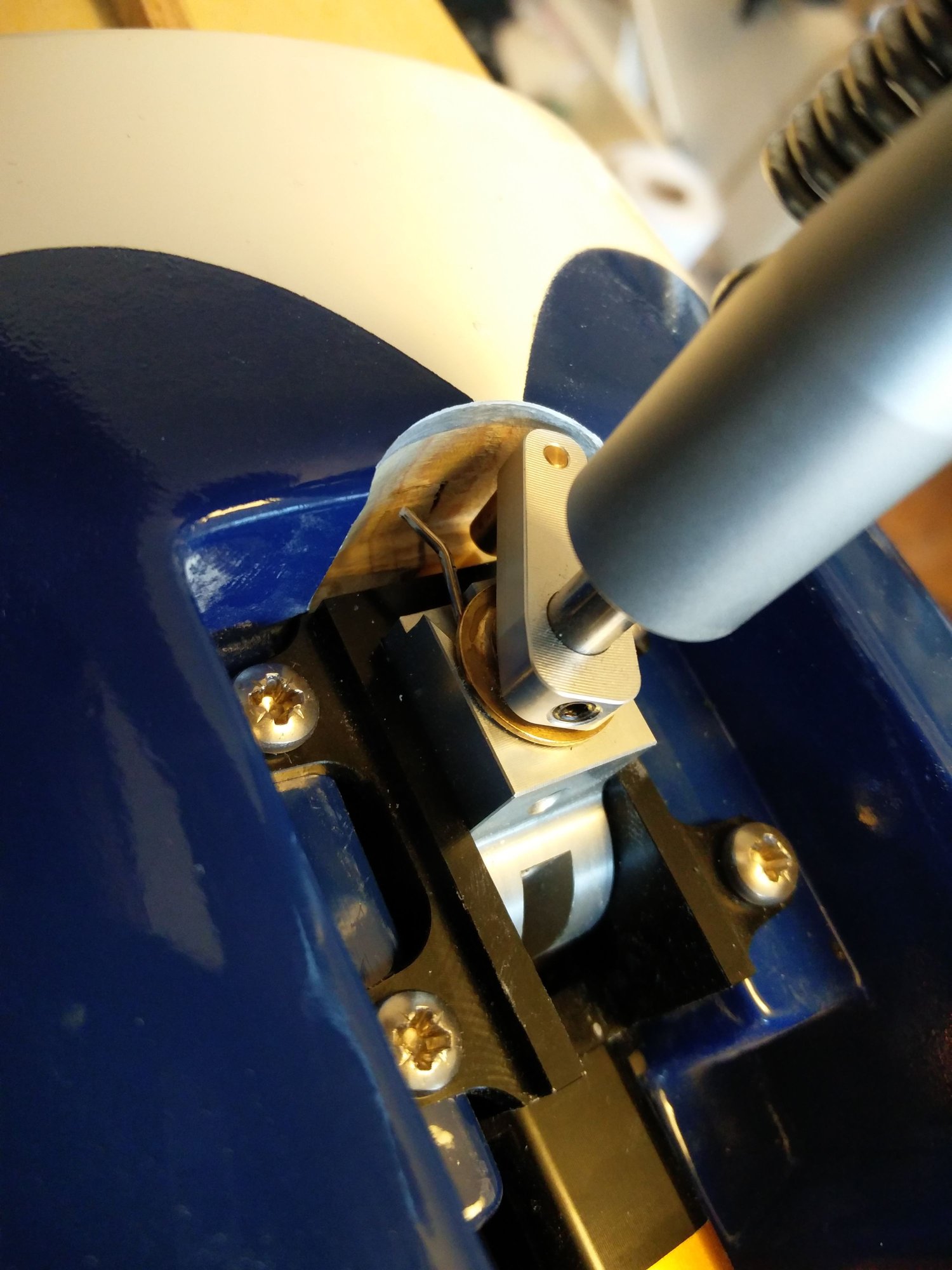

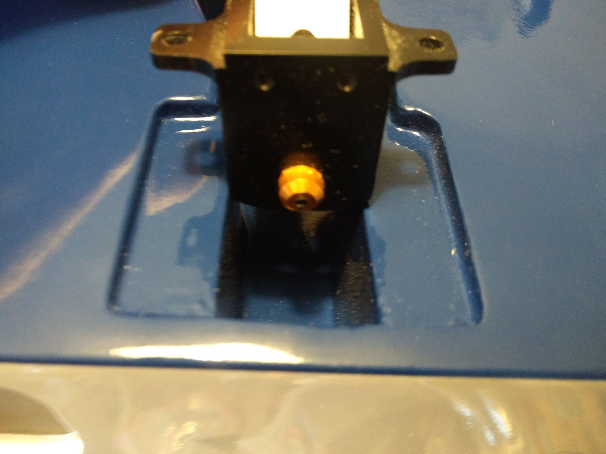

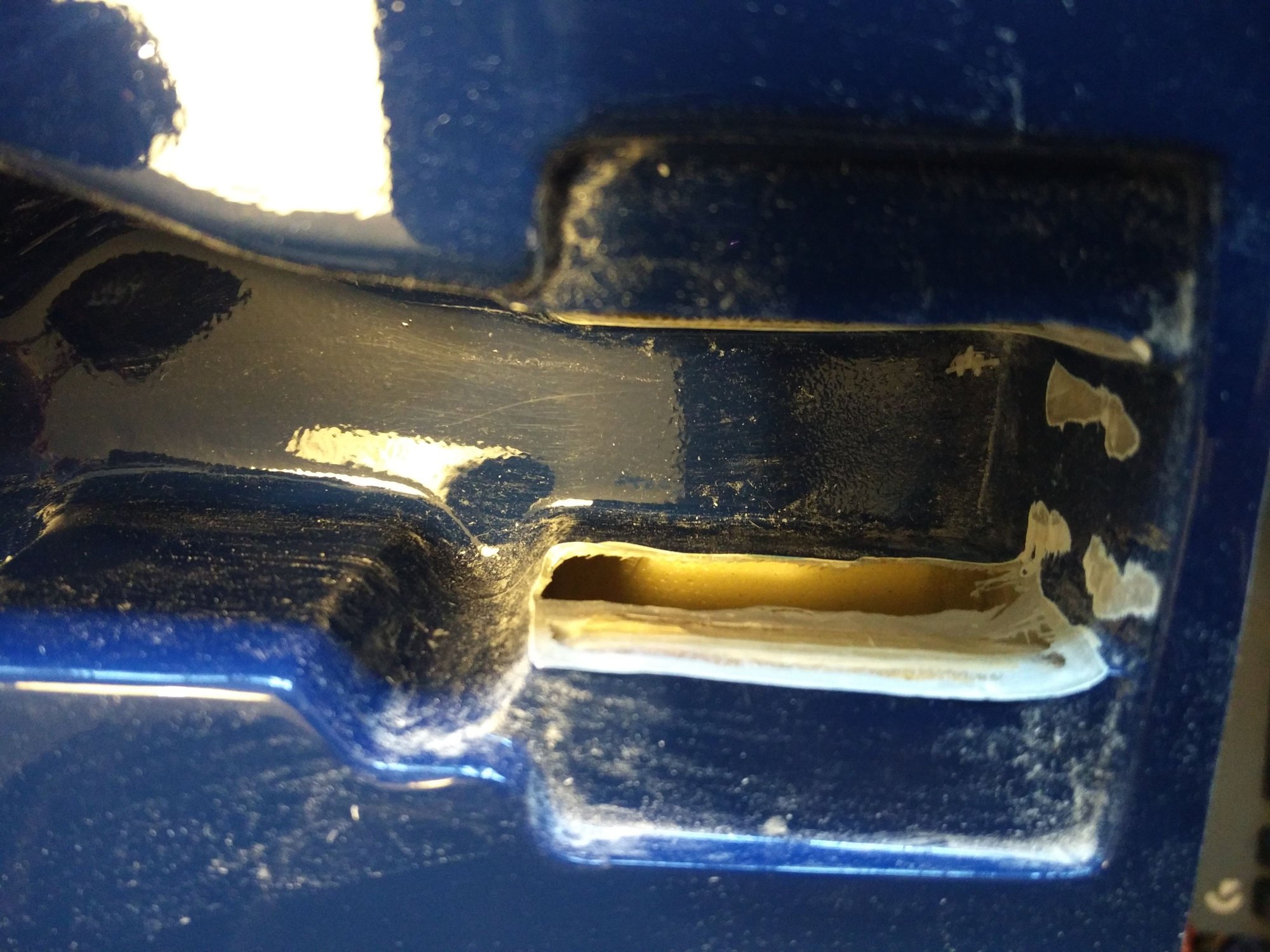

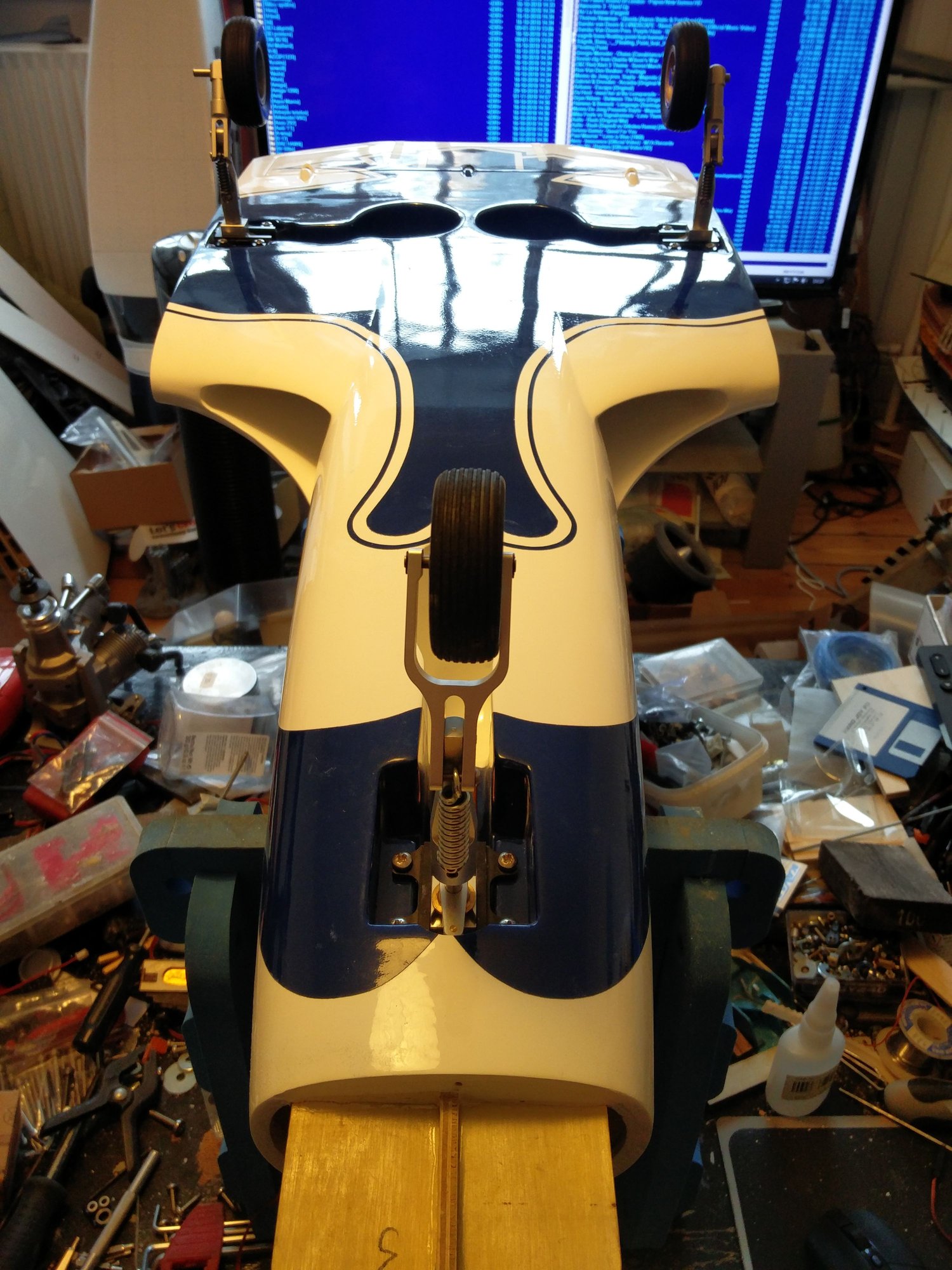

Got my Jet-A1 main retracts today from https://www.jautsch.de/ , so Now I can begin the install.
Im using the original ripmax nosegear. They will be installed in original CYS R2090 retract units :-)
They are 2mm too wide , so I had to dremel out the bays width. The nose gear also has a centering pin, that I had to make room for.
I have removed the original steering system, and have ordered a normal metal horn with 6mm hole in it to fin on the nose leg connecting pin.
