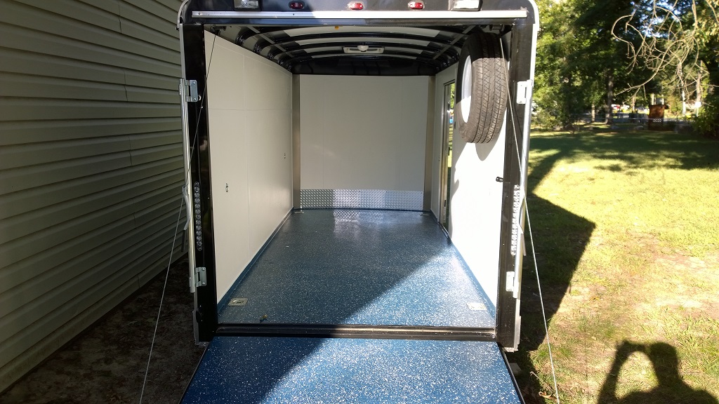

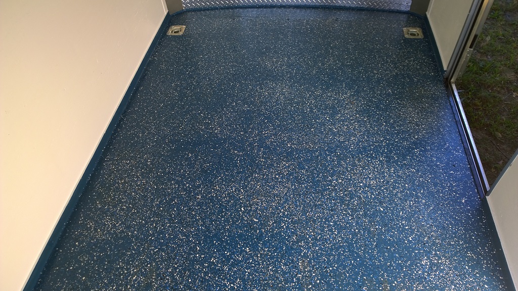

I purchased a 6 x 12 trailer and just finished painting the inside. The walls and ceiling are painted with semi-gloss exterior latex and the floor was finished with garage floor two part epoxy paint and a heavy dusting of paint chips. Then the floor was covered with two coats of semi-gloss polyurethane clear.
I'm looking for ideas on set ups for carrying jets and warbirds. Please show your trailer set ups.

Just looking at the ramp, it looks like it may a little slick when it gets wet.

Thanks Bob. The heavy dusting of paint chips give a rough texture and acts like a non-skid surface.

That's great. The inside looks awesome

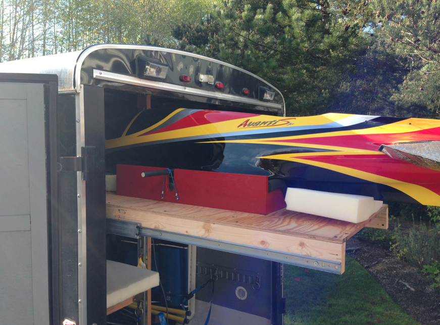

I put a slider on one bunk. I use E-trac and the slop in the bracket that held the slider allowed the teflon runs to get wiped out. I spent ( I think ) around $250 for the 500lb slides and now they're dead. It was nice to slide the plane out, but not worth the added time and weight. Made taking the racks out or adjusting them a total pain. back to simple.

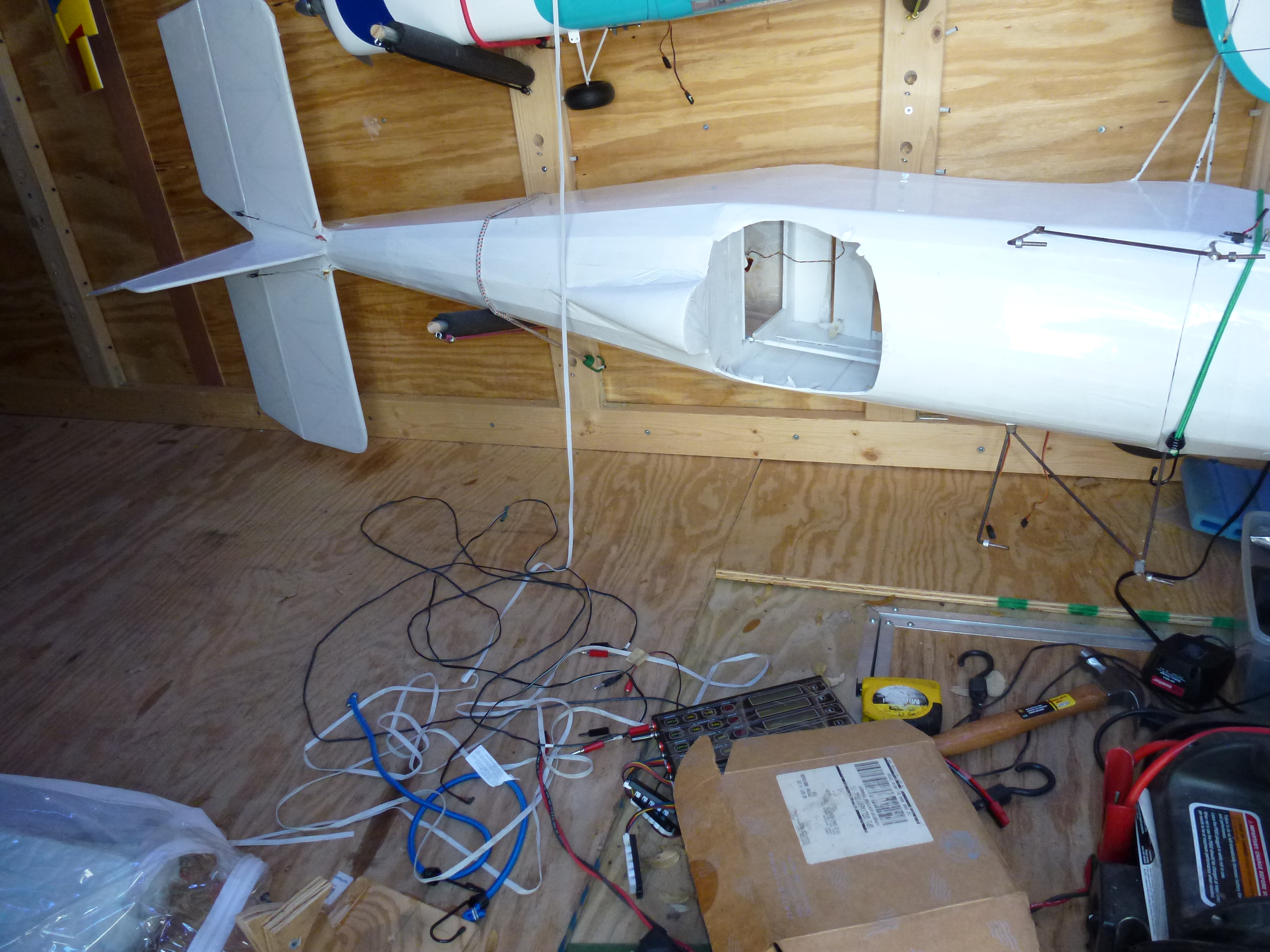

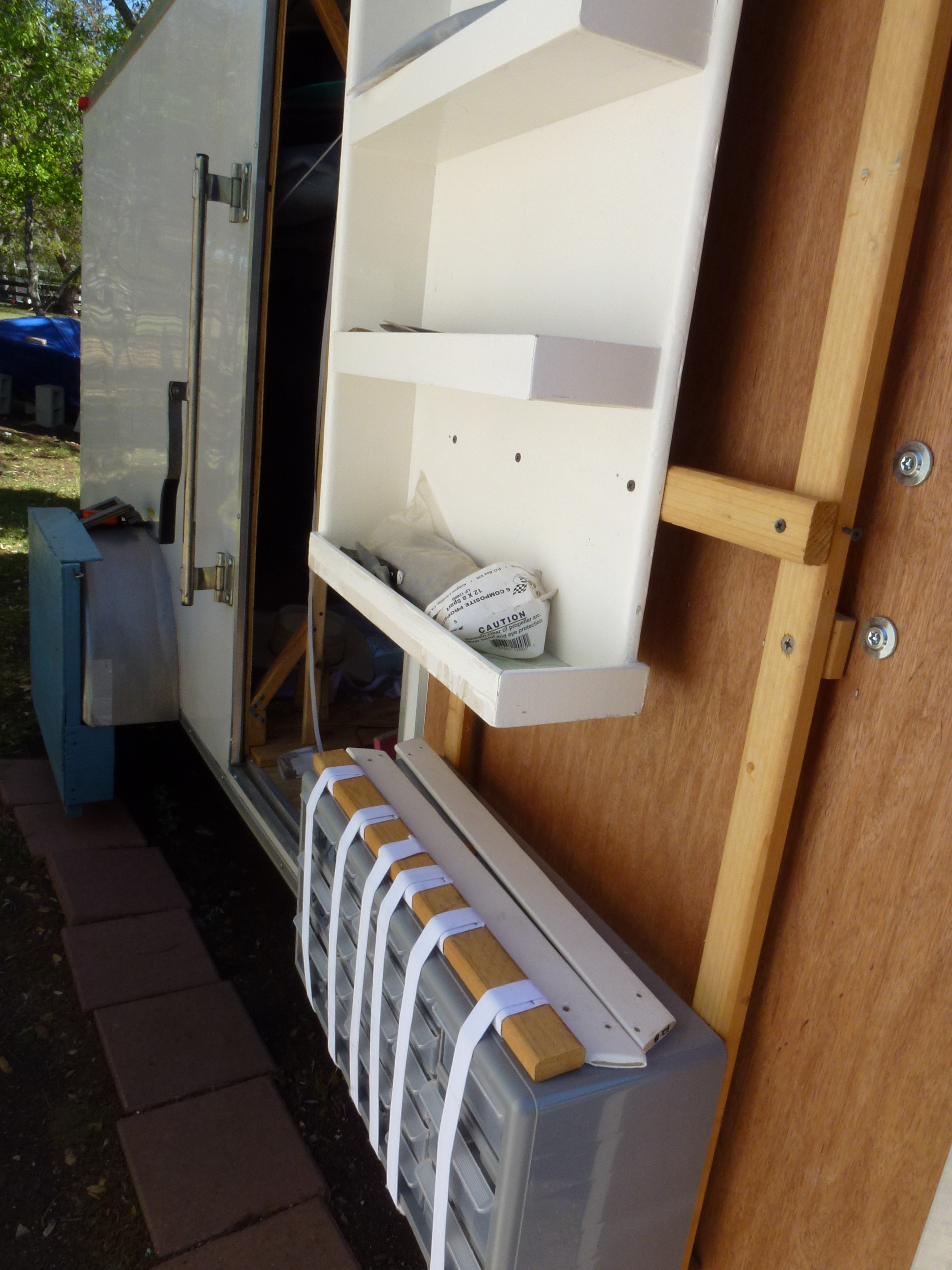

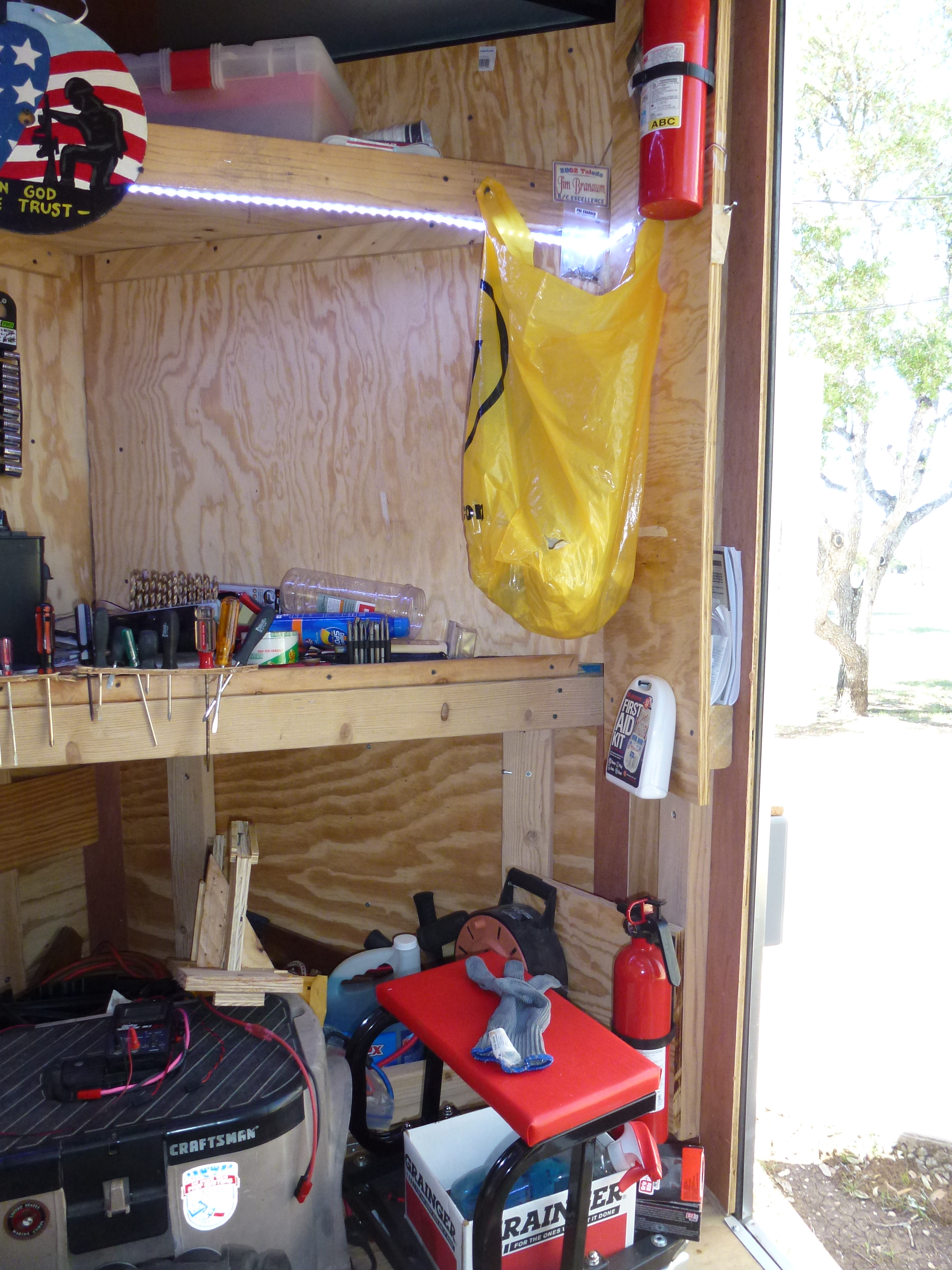

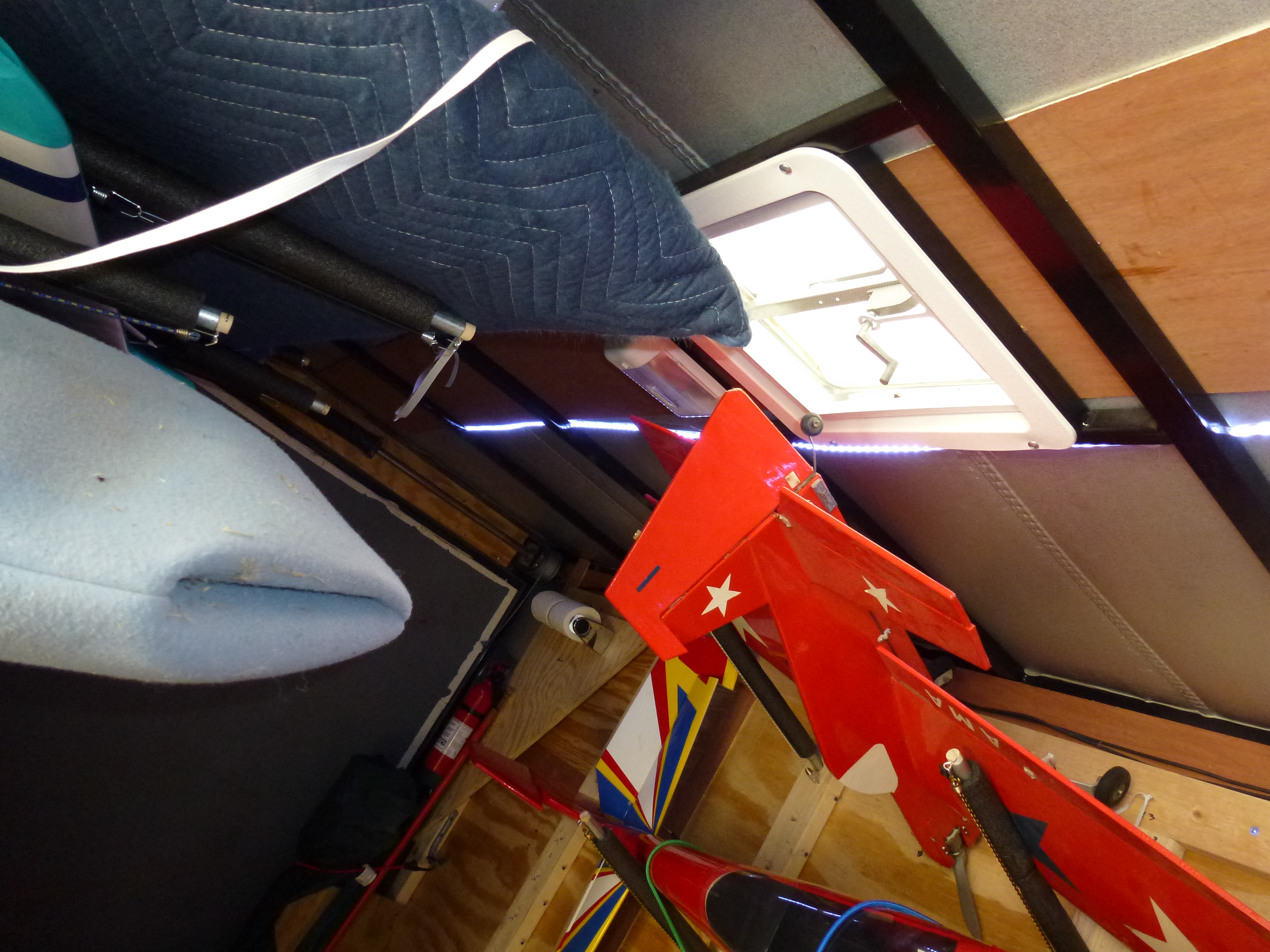

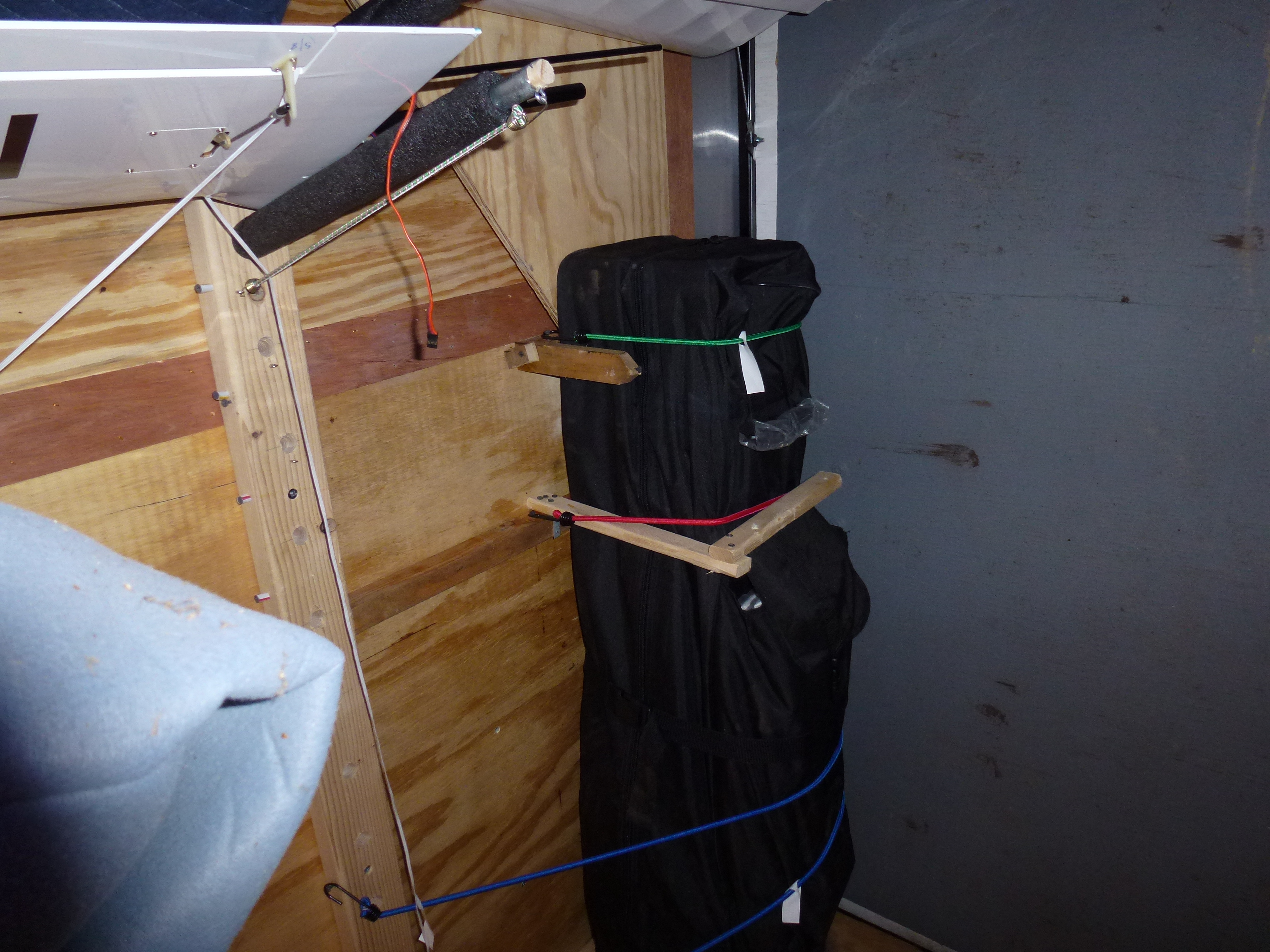

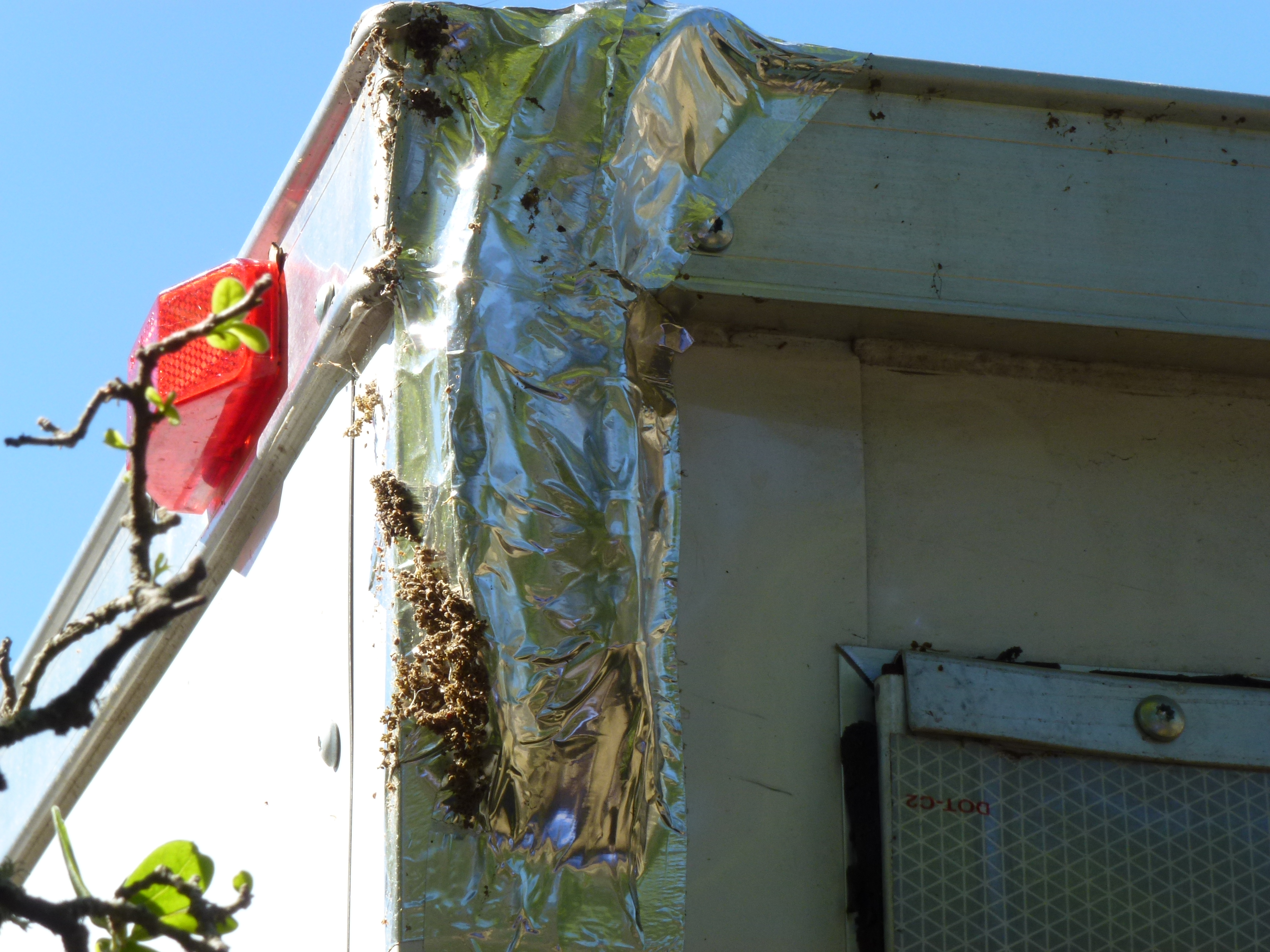

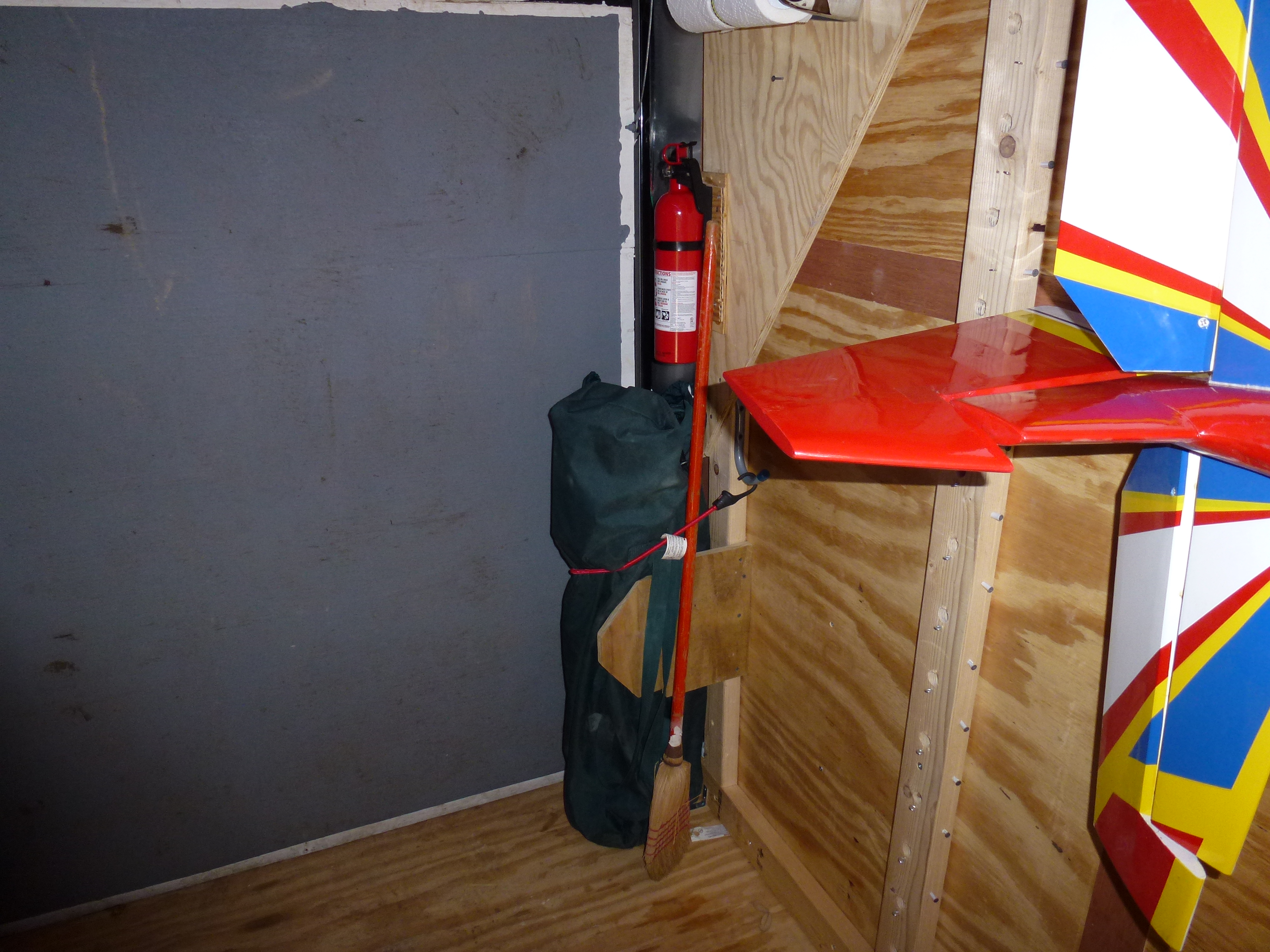

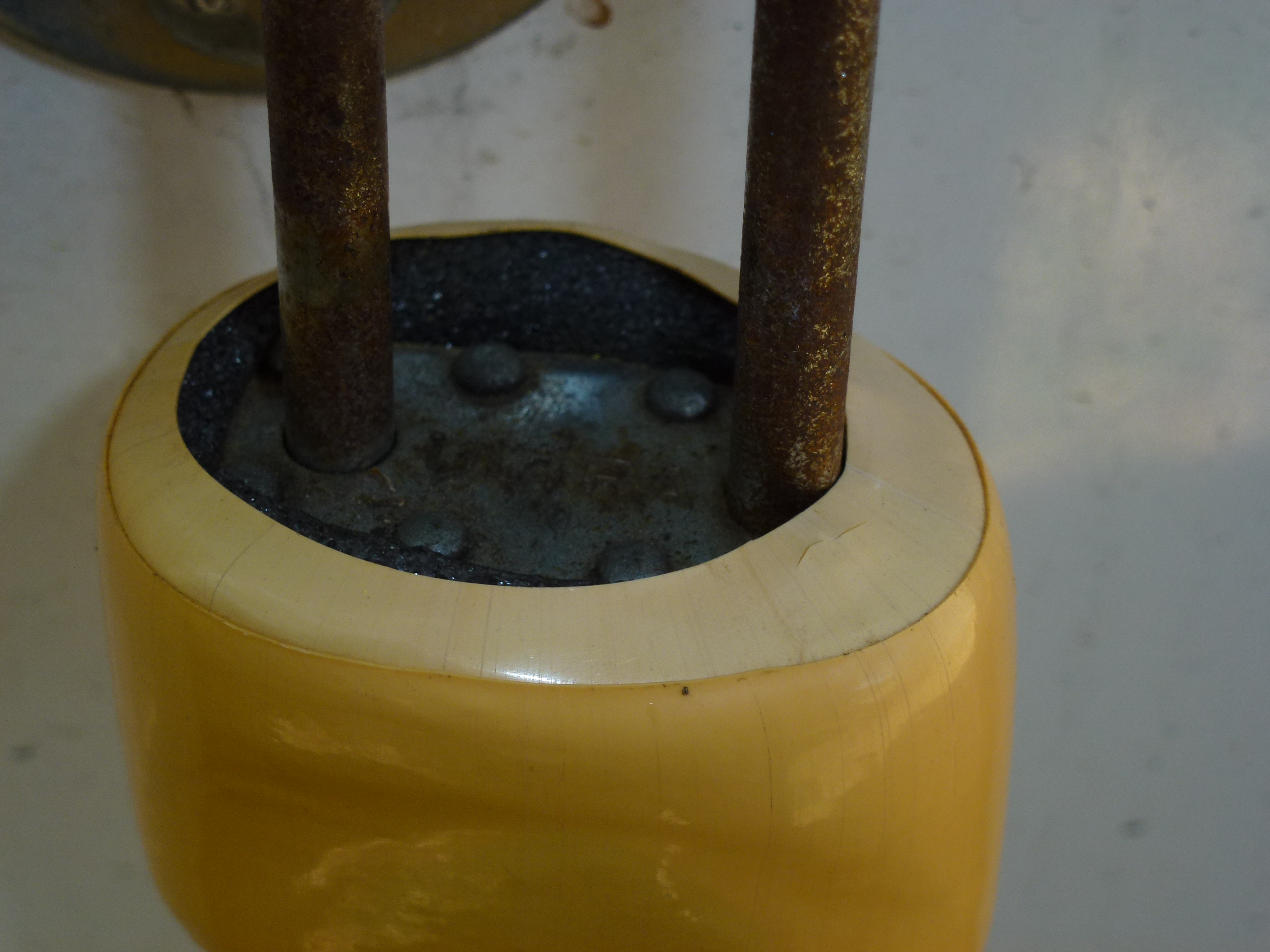

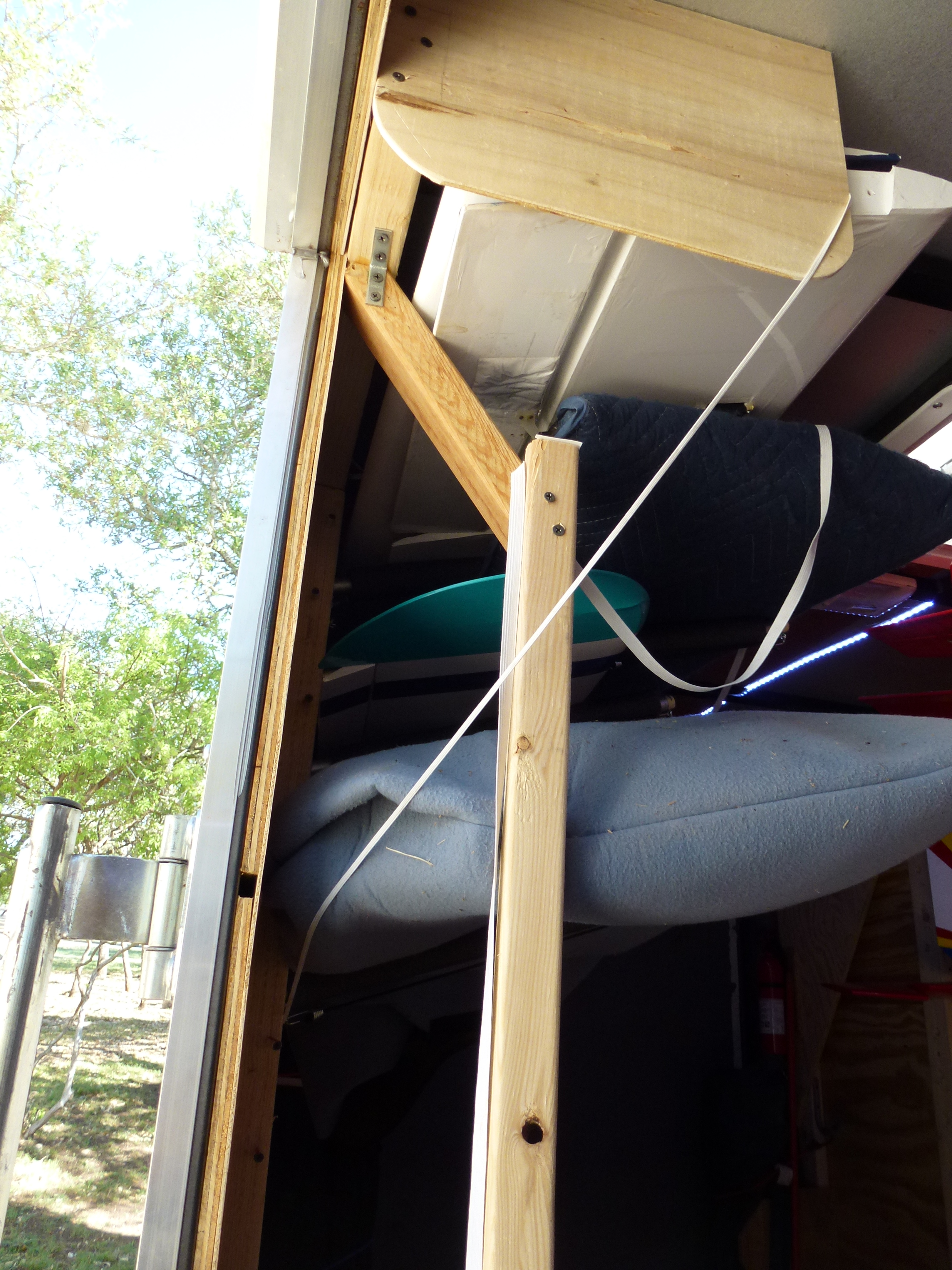

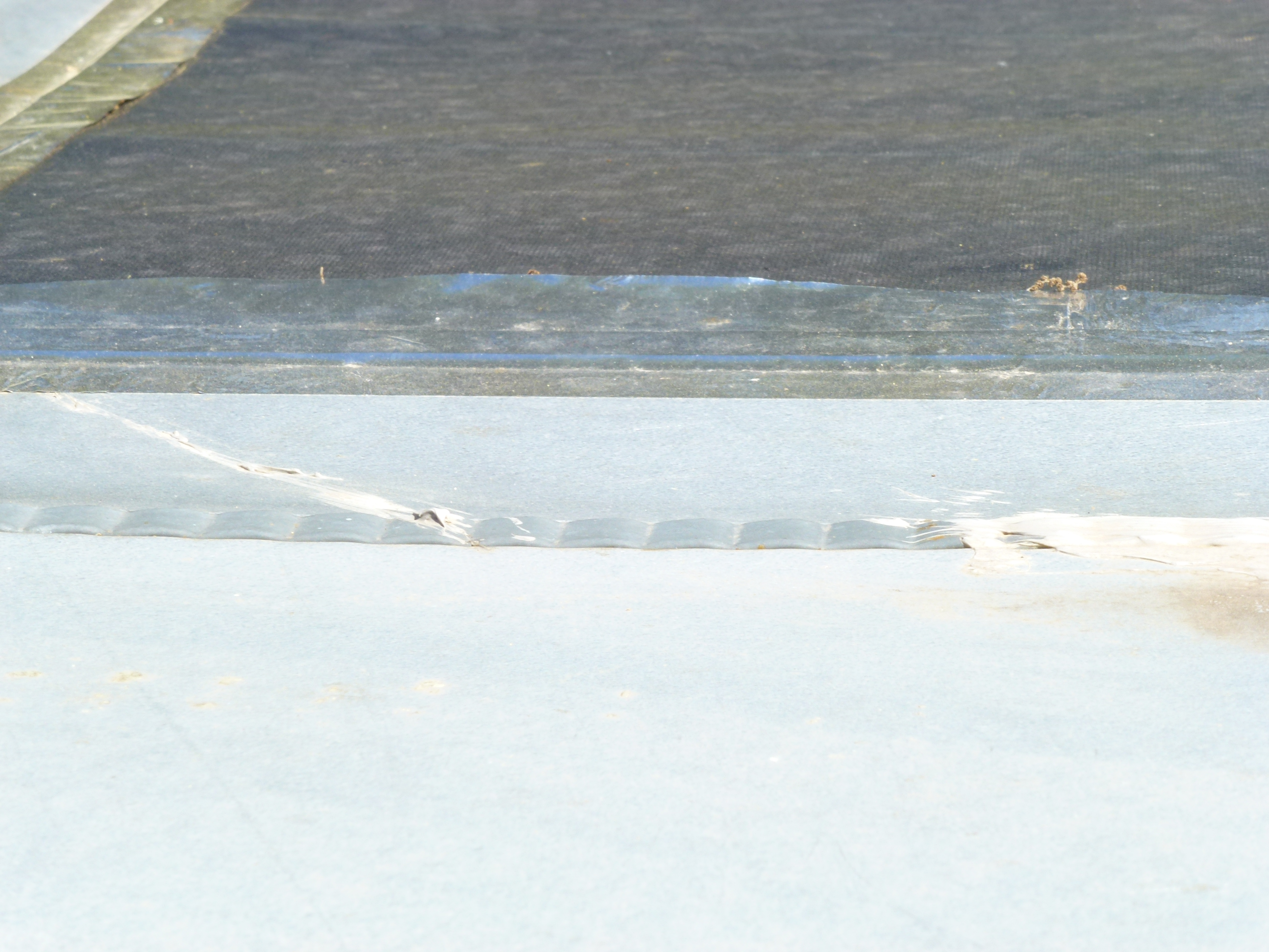

Hmmm...

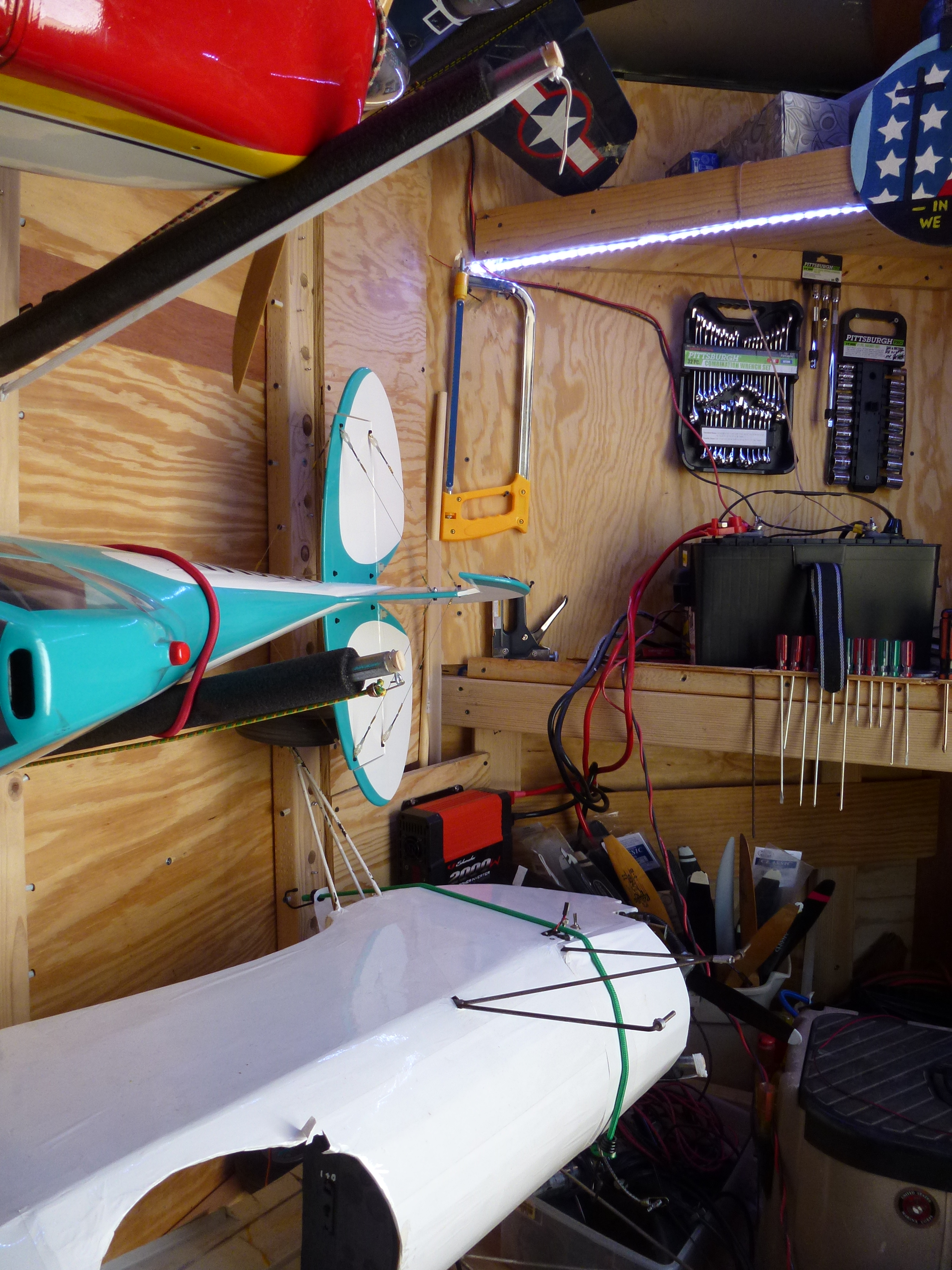

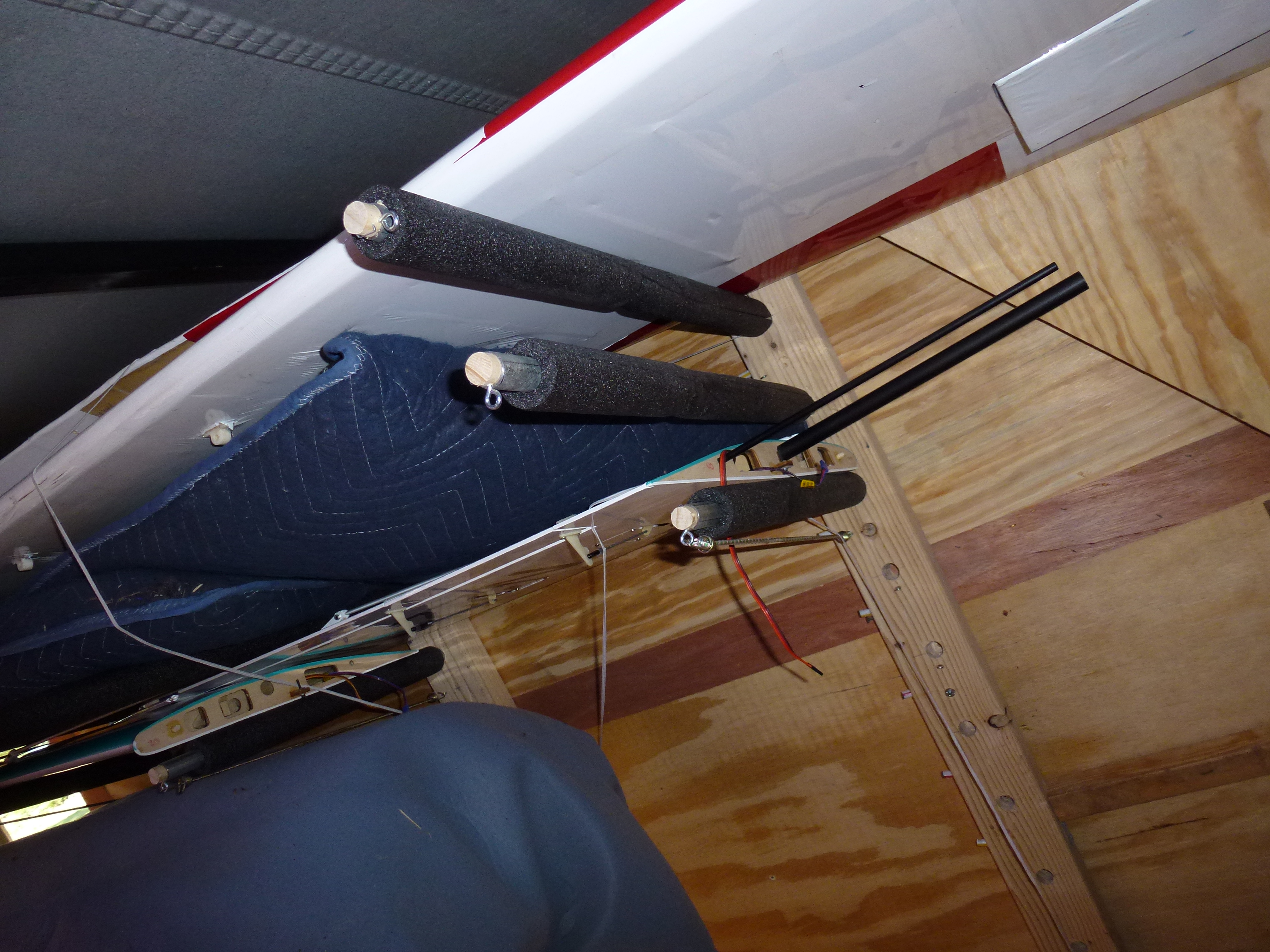

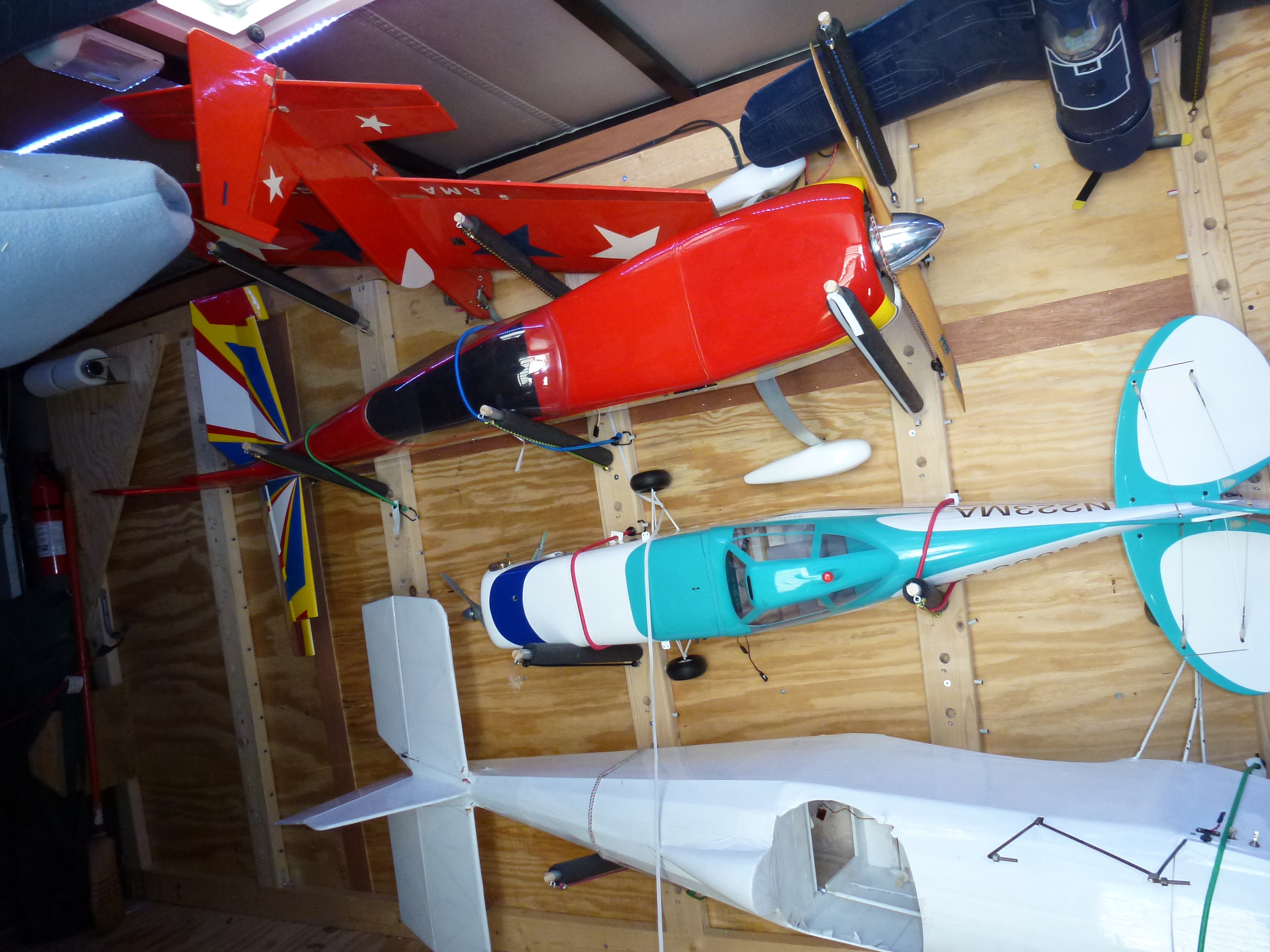

I have a 6X12 V nosed trailer (special built with a torsion axle - got tired of the old one beating my planes up). To start with the wife insisted I do nothing permanent to it, so I spent a lot of money on 1/4-20 screw inserts put in with Gorilla glue. I put a floor covering in that I had intended to screw aircraft down to but discovered that was a mistake and then got fancy.
I put a shelf in the V at around 26 inches, and another at about 4ft 6 inches. The battery goes on the lower shelf because I am not Charles Atlas. I have a friend who put his on the upper shelf!

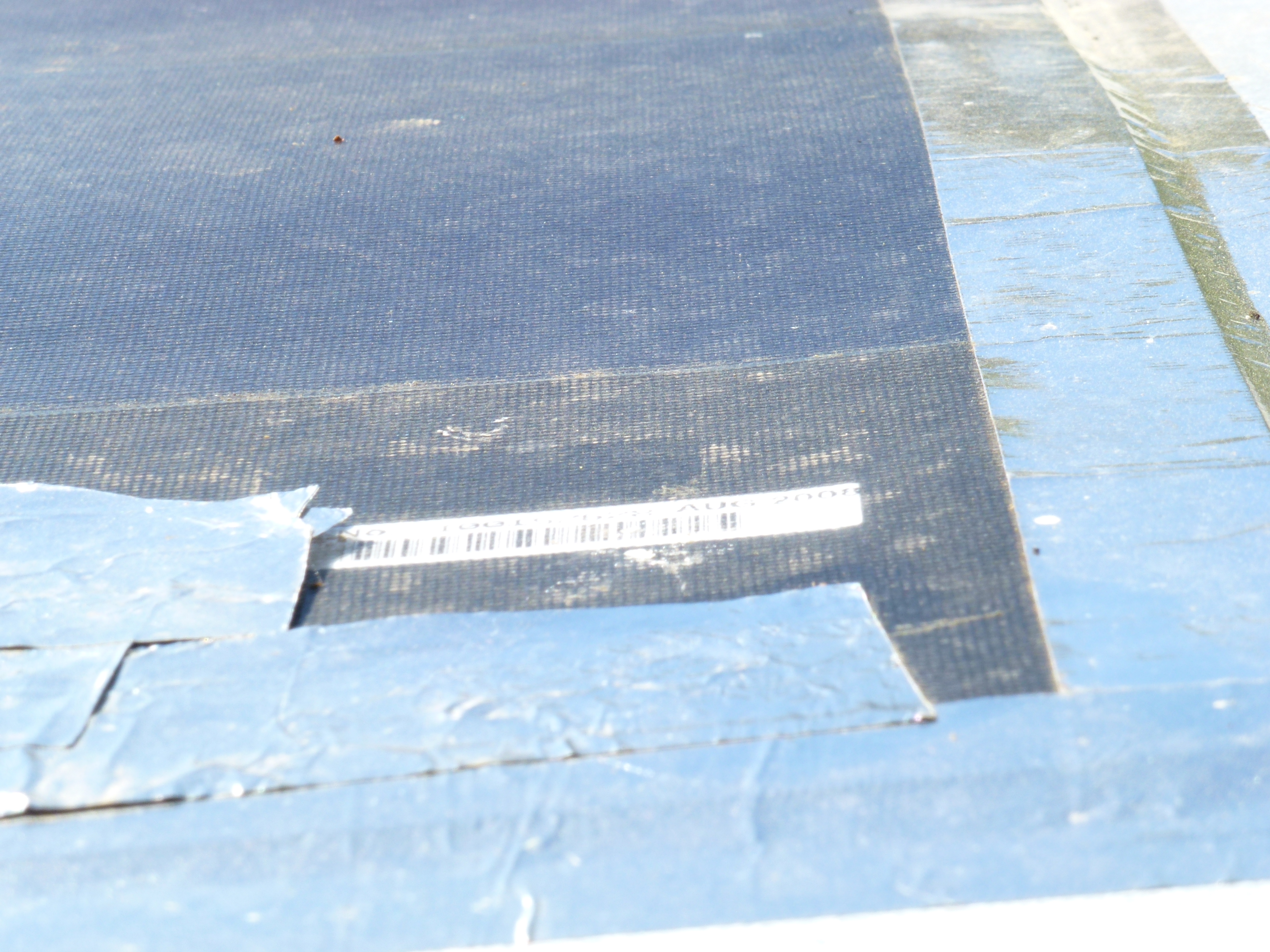

I installed a PV-68 watt peel and stick solar panel on the top to keep the battery up, led lights on the ceiling fed by the battery and a switch for them by the door.
My 2000 watt inverter (the red thing behind the white aircraft nose - a Bud Nosen Gere Sport) went in just below the lower shelf because I want all sparks to be lower than any hydrogen gas released by the battery. If you look closely, you can see a section of the lighting I used.
Then I got 'tricky'.

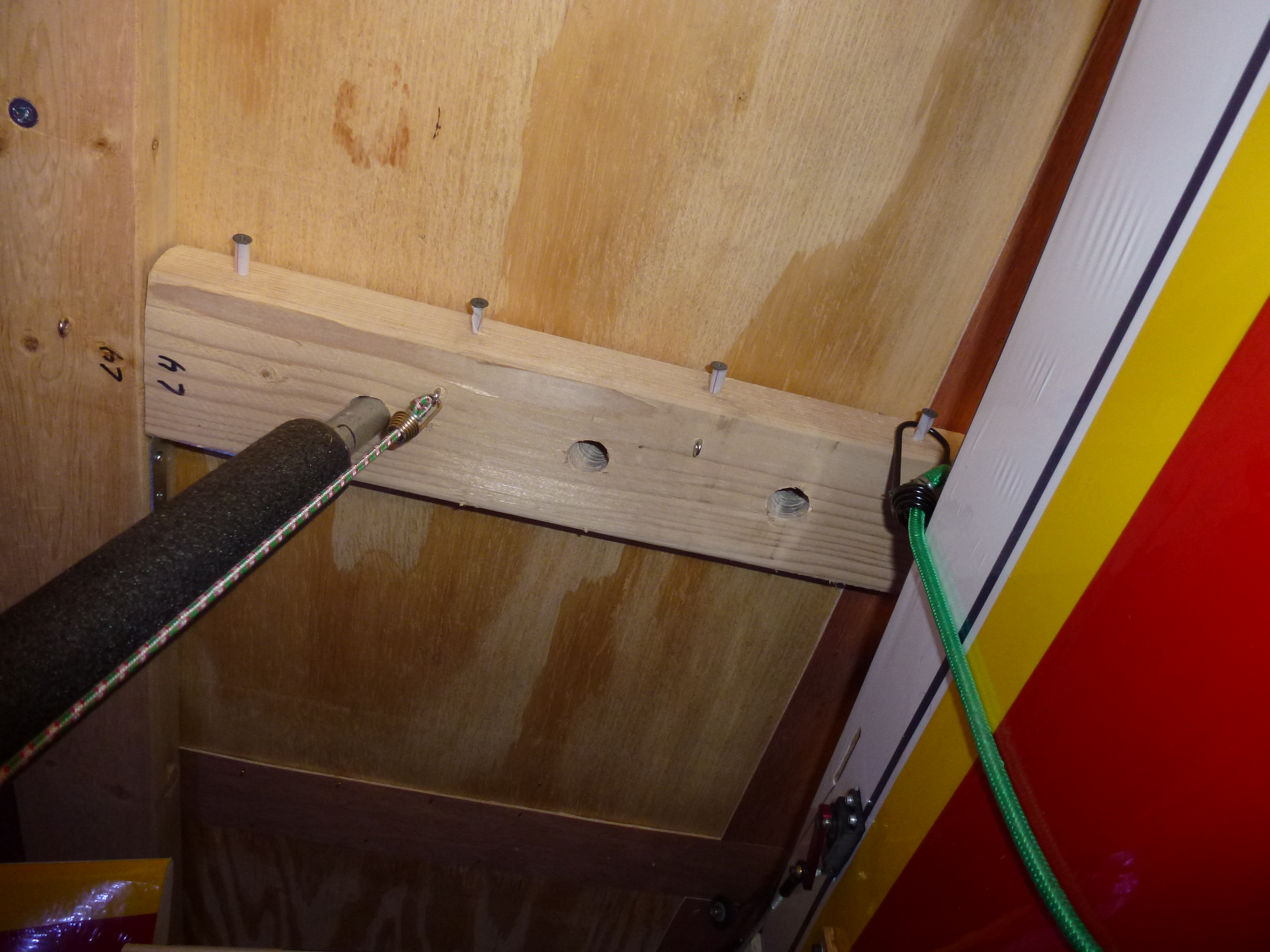

I installed a 2x4 every 2 feet from the front of the box to the back on both sides. Each 2x4 has a 11/16 hole drilled at 15 degrees from horizontal every 2 inches from top to bottom. Those holes are where I put in chunks of 1/2 electrical conduit covered with plumbing foam. Oh I discovered that I needed to use a 1/2 dowel chucked up to a drill and covered in 60 grit sand paper to sand each hole big enough for the conduit to go in. Drilling to 3/4 would have been way too big. The end of each chunk of conduit has a 1/2 dowel plug and an eyelet installed. I use those and small bungee cords to eyelets by each hole in the 2x4 to keep the conduit from wiggling, or falling out. I also went to WalMart and bought a couple cans of racquet balls for the end of the conduit after I cut my head up a couple of times.
On the side of each 2x4 by each hole I put a 1 inch drywall screw with a chunk of straw over it to provide tie down points for aircraft. In the back, I built a stop to hold a pop-up canopy and one on the other side to hold a couple of chairs. Without the stop, that stuff would always come forward in a sudden stop. I put a couple of chunks of PVC behind that stuff for the tent stakes. I also built by the side door a stop to keep my wings from sliding forward. The yellow thing you see is a lock that was enclosed in 3/4 inch plumbing foam and covered in heat shrink. That keeps the lock from banging and the heat shrink protects the foam. The metal (A/C) tape is to insure the solar panel edges are sealed and in the back to keep the holes I drilled sealed and the wires from sun damage. You can also see the storage system for nuts, bolts, and props I built in the side door. The ramp was primed (white) and coated with grit stuff (grey) from the hardware store. I installed more than one fire extinguisher because I worry about needing one someday for whatever.

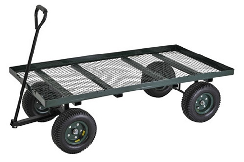

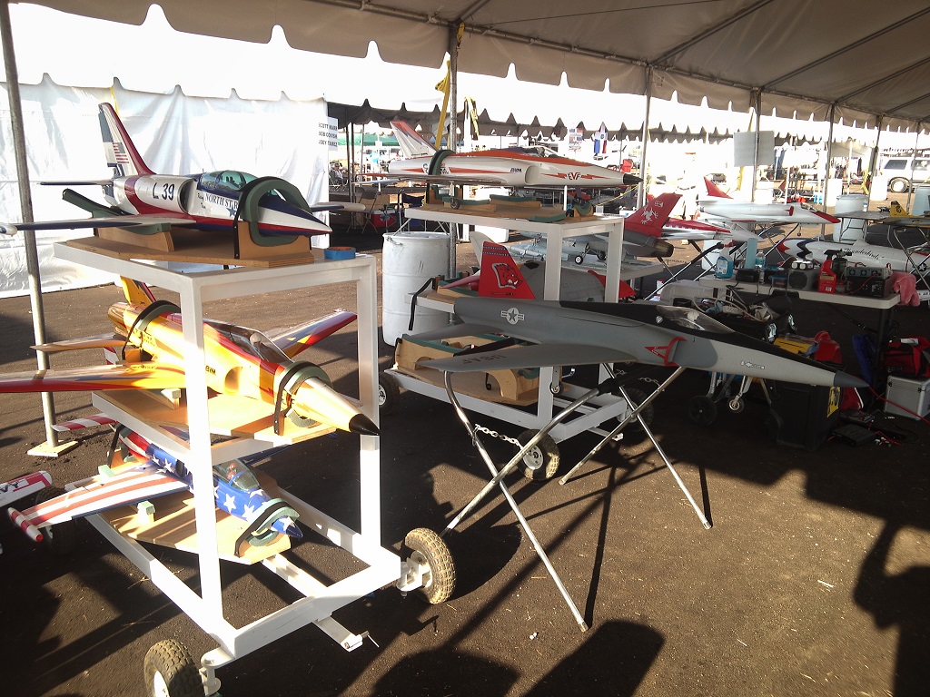

Thanks guys for the photos and links. I want to be able to use trailer for more than just hauling planes so I've decided to set up the inside to make it easy to use the trailer for other purposes. Global Jet Club used to sell the "Jet Transporter" but no longer sells them. This would have been a great solution. Being a modeler that still builds, I've come up with solution to make my own "transporter". I purchased a garden cart and will use it as a base to make a three-tiered transporter. I'll be able to roll in and out of the trailed and the planes can stay on it for storage. I'm going to install some Etrack to secure it in the trailer. Once again, thanks guys for taking the time to respond.

That jet transporter would be childs play to make. One more reason I want to buy a Tig welder!!! Might have to have my dad throw one together for me. He's a retired metal shop teacher, we have a full metal fab shop in the back yard.
