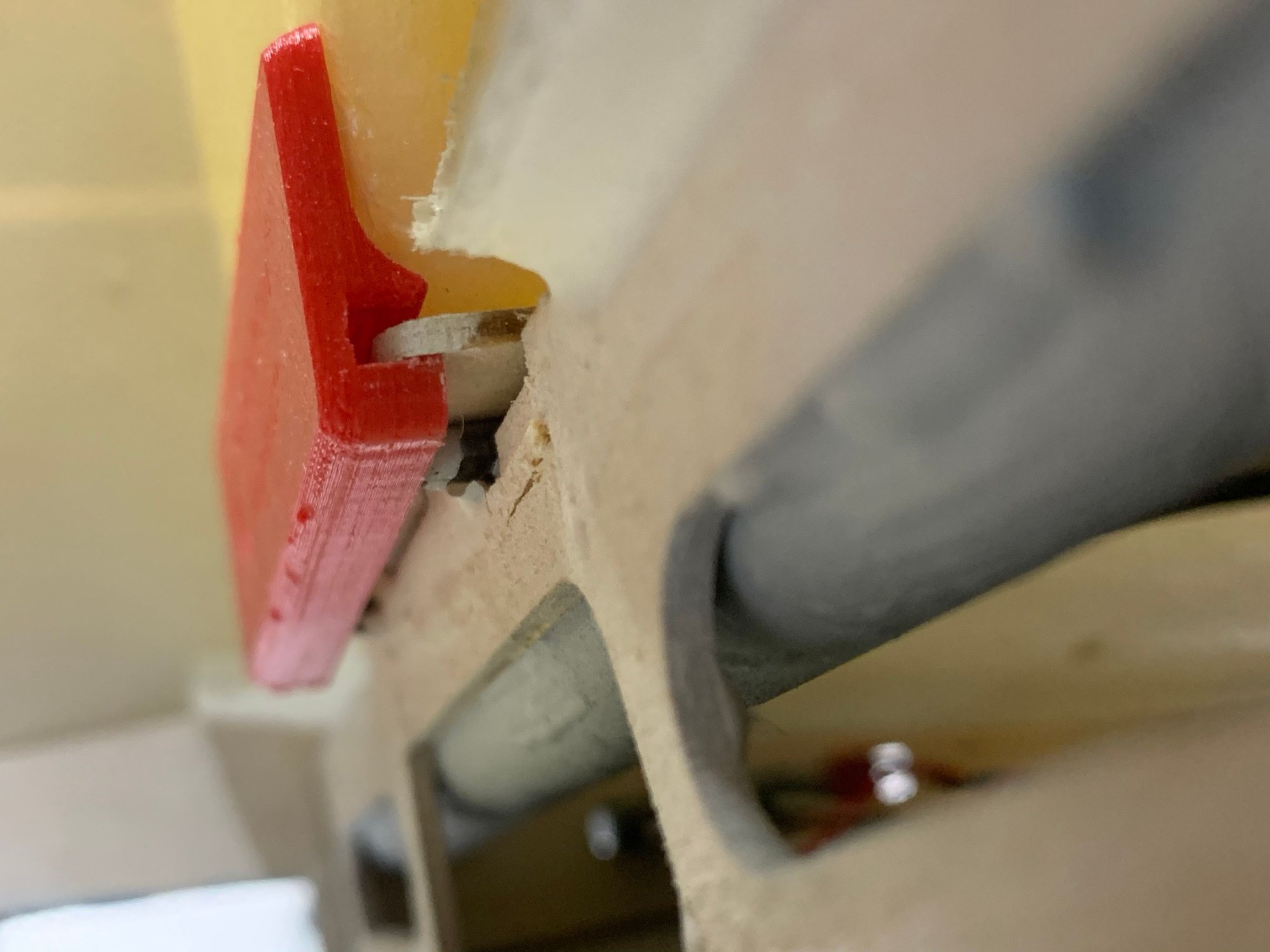

Hello again, new and definitive brackets for Mini AvantiS 1.3L tank. Now the back bracket grip the plywood and make more easy the installation and fit the tank 2cm back.
Special thanks to Valerio Lorenzini for the idea.
I hope you like too.
