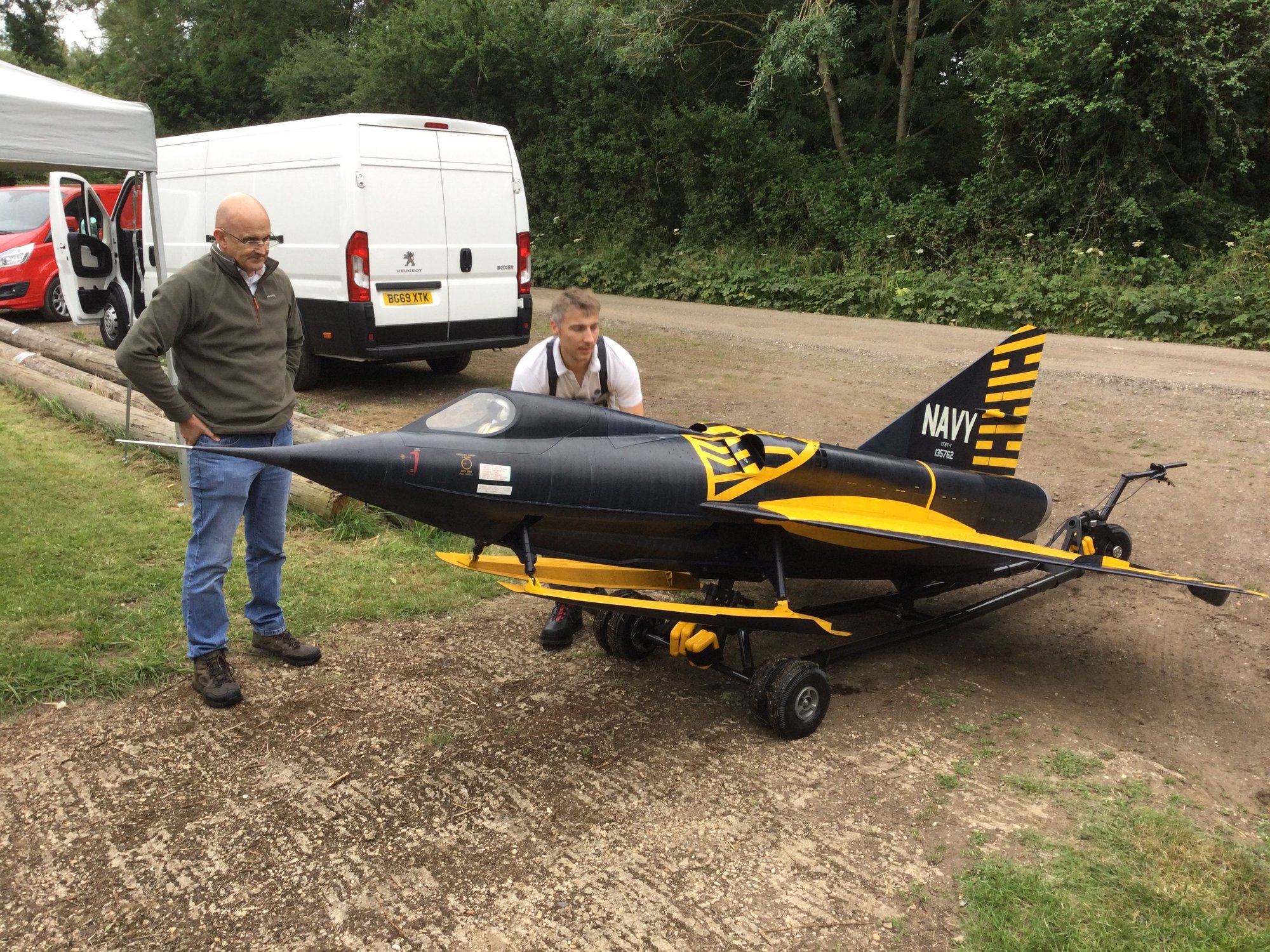

Thanks for the kind words and suggestions guys. There is a small section on our website about the aircraft history and a video filmed at the time of its development which is interesting (to me at least)
https://www.littlejetco.com/sea-dart/history
With the knowledge that model is no longer taking on water at the rear, sitting at the correct water line and we can easily manage the aircraft in the shallows using waders we can move onto the RC boat bit of the test. With Dave in the follow boat along with three others either driving filming or taking photos we set off for 25 minutes of testing the model at slow speeds. Dave will be able to talk in more detail but the handling seemed ok although it was hampered by weed collecting on the ski struts as you can see below.
_DSC7873<script async src="//embedr.flickr.com/assets/client-code.js" charset="utf-8"></script>
The water rudders at the back which are actuated by two big Savox waterproof servos worked well and continued to work even when submerged for over 5 hours. The wind was around 8 knots and the huge vertical stabiliser did hinder things but it was still possible to turn in either direction without assymetric thrust. The full size aircraft used a combination of asymmetric thrust and rudder to turn and in the second test the water rudders were not used but it was still possible to control direction using only asymmetric thrust.

I think the water handling will be fine in a clear lake, also with less wind swirl. If you look at the google earth view Alex posted you can see the lake was surrounded by trees and a bank. The huge fin and side area was affected by the wind, but I think the biggest influence was the debris in the lake, we picked up a branch at one stage on the skis! After each run the weed needed clearing off the struts, so we were unlucky with the flotsam that day, we were sheltered, but there was a storm brewing and the wind was quite strong.
When we had clear water it steered ok using the water rudder, I tried using the elevons to influence the turn with drag, but to be honest this didn’t help. Alex had asymmetric power available, where one turbine could be idled and the other throttled, on the last run ( because he didn’t brief me properly 😉 ) I had the water rudder switched off and the SeaDart could be turned with just asymmetric thrust, so I’m sure that when it comes to it water manoeuvring will be good. We also had a demon speed boat driver that day who could really handle the boat, so some of my initial concern over spearing Alex’s hard work into the bank was reduced-though there was a large wooden buoy/island with magnetic characteristics to avoid too.
We played with ski angles and getting it onto the step, the run before Alex got in the boat with his camera I got it to ‘pop up’ onto the step for a few seconds, but I didn’t know at that time how quickly it decelerates when you drop it back into the water...really fast is the answer. Alex warned that the power needed immediately reapplying as it settled as the bow waved catches up and can go up the tailpipes...something that the full scale suffered with apparently! The two angles on the skis also showed that even with two P-300’s at full power the fully extended ski position creates a huge amount of drag! I think we all learned a great deal that day and the methodical test schedule Alex has planned should mean no water related surprises when it comes to flying it.
Although Alex looked shattered, my overriding memory was of the joy the owner had on his face seeing it finally in its element, he just kept saying isn’t it brilliant 🙂 we are so lucky people like Ben have the desire to push the boundaries way beyond anything that has ever been produced as a model aeroplane before, all the guys involved with this project should be so proud of what they have produced.
