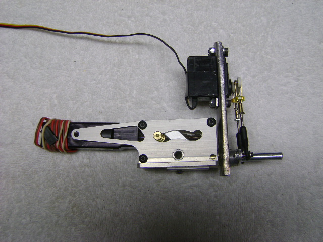

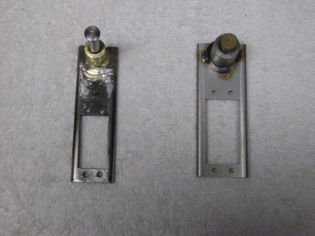

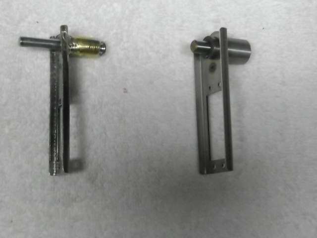

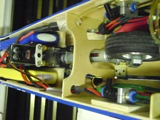

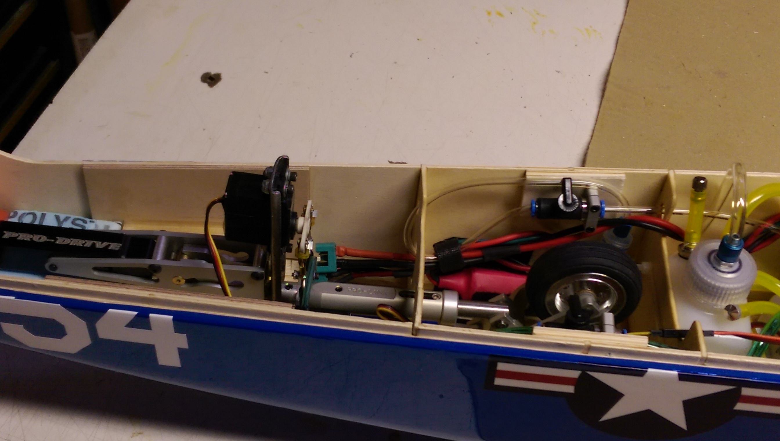

Glad to hear it! I'm sure there are many others out there that dislike cable steering as much as I do.
I came up with a direct drive modification to the Pro-Links on my Reaction 54. I borrowed the idea from my Skymaster F-4 and several other applications that I've seen.
The servo mount on the right is for the F-4; the one on the left is the one I made by brazing a brass spacer to a piece of steel.
Here it is with the servo mounted
And mounted to the retract
Here it is in the Reaction
It's a little crude because it's handmade, but so far it's worked great. I assume that you're working on something similar. You could also offer the mount as an upgrade to existing Pro-Links. The above servo is a Hitec 225MG. I have also used Hitec 645MG on other applications.
Joe

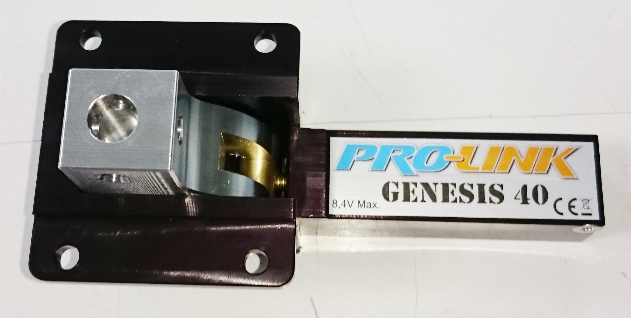

We have used digital MG servos on NG steering for years without issue; although we always disable the steering servo when in the retracted position. Our Pro-Drive LGC12S and LGC13S E-Gear controllers automatically disable the steering servo when retracted. With such a wide array of servos being used for steering, I believe I need to put a bit more thought into making a "standard" servo mount with some sizing flexibility.
Here is a bit more info regarding our latest generation in the Pro-Link lineup, the Genesis series:
The new Pro-Link Genesis series offers an extremely robust two piece CNC frame, sealing the motor and gearbox from the mechanics while eliminating all possibility of friction or binding due to uneven mounting rails. Over-sized T-Bar, beefed up trunion, and a dual bearing supported drive screw assures these retracts remain slop free even after those not-so-perfect landings. Connector plug is integrated into the retract housing, allowing for simple gear installation and removal. One of the most important upgrades to the Genesis Series is position sensing end stops, while retaining current sensing in transit. Travel endpoints are sensor controlled, eliminating all the stresses on the mechanics and drive system typically seen with stall current actuator systems. As an additional safety, we retained the stall current mode while gear are in transit. Gearing specifically selected to provide substantially more torque than our competitors while retaining our quick transit speed.
The Genesis series will be offered as pin mount and clamp lock style trunions in common sizing as well as normal and reversed configurations.
In addition, we have a new sequencing E-Gear controller in development offering a long list of exceptional new features, here are a few highlights: Integrated full color display, independent gear and door programming, steering gyro, numerous braking modes including differential braking! That's all i'll mention for now, More news on this ground breaking controller soon...!
