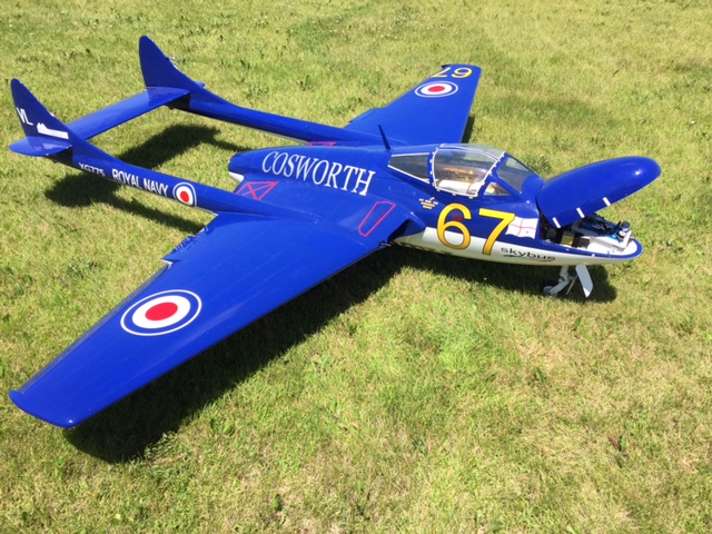

I use A123's in my jets and never remove them from the plane for charging
