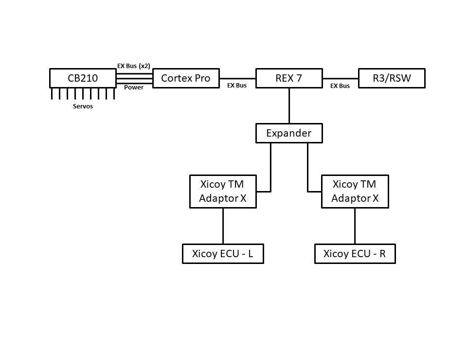

Mark,
Not currently. I have never used a 900, but I have left space for it in my install. See below, where I connect via a Cortex Pro and CB210. The 900 will connect to the Cortex Pro (RX2 input) and then into the CB210.
I would assume that the 900 would connect into the REX, but I don't know if the REX has the ability to do Rx switching. You may need a CBxxx to handle that.
Paul

That appears to be a non-standard set up for a CB210 & Cortex Pro.
I run the main REX into Cortex Pro port B, and the backup Rx to port A. Cortex Pro ports 5 & 6 go in to the receiver ports, 1 & 2 in the CB. The 900 receiver goes in to the 3rd receiver port. The telemetry goes into the EXT ports of the CB.
If you run the 900 directly into the CBxxx 3rd Rx port, you lose any gyro benefit at switch over to 900. The REX and connected R3/RSW provide primary and backup 2.4 RX's, and the Cortex Pro will provide switching to the 900 should it need to.
Note I have not yet installed a 900, so have not fully proven the strategy, but that's my understanding of how it should work.

This true, but the 900 will be there in the unlikely event of the Cortex Pro failing.

I never run my 900 into the CB’s…..the A/C should fly with the gyro…and the 900 (for me) is only to get the jet back on the ground quickly…but not in panic….
Personally the expander would only go in my CB’s….in fact if I need an expander I would go CB320 or 400…..I have both in different jet….
