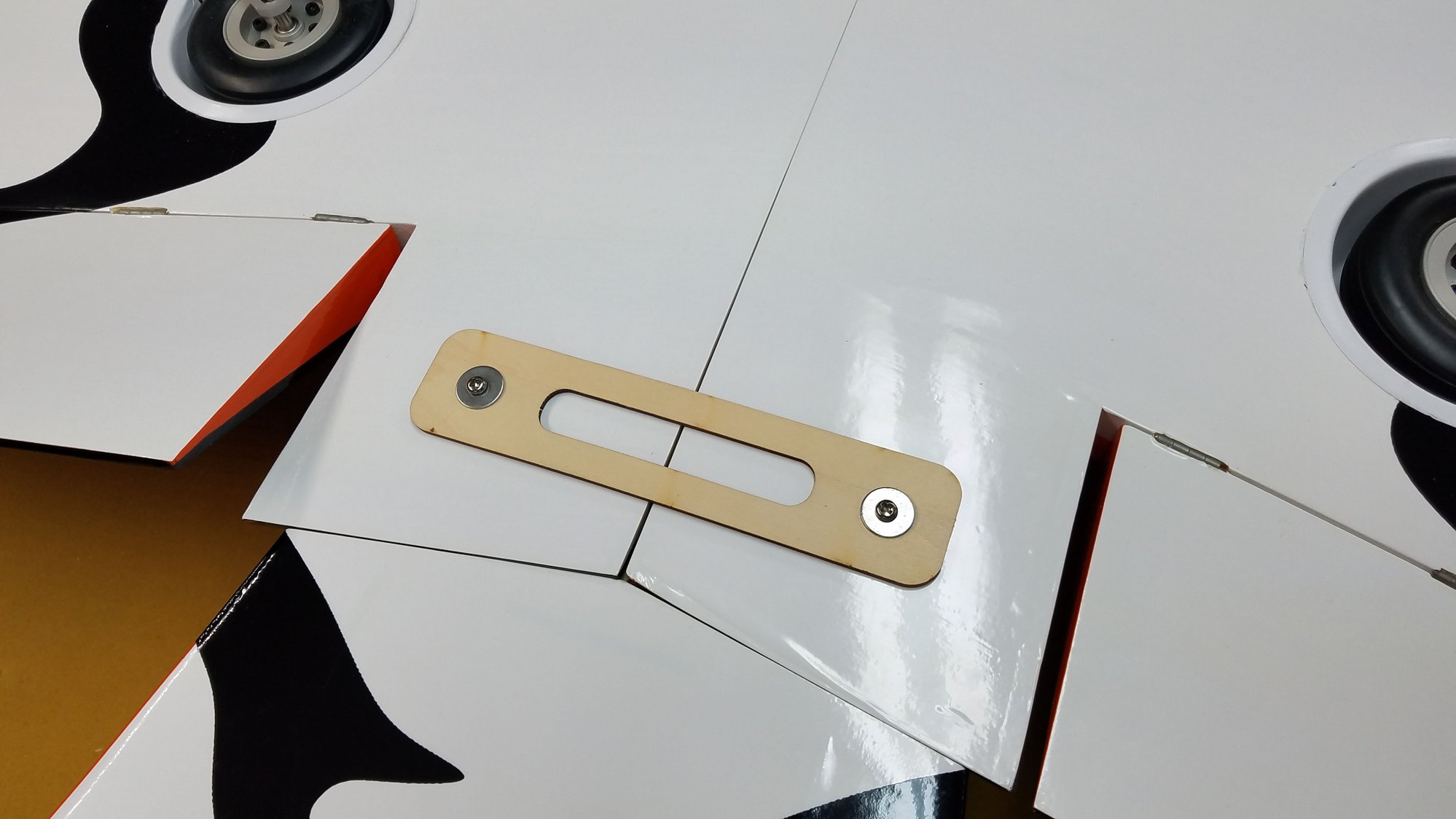

well, i'm nearing the end of my install into the DV8R ARF. i have this piece that came with the kit and i can't find in the instruction manual where it goes. my best guess ,because it fits, is it's a support for the wing bolts so they don't allow the wings to spread apart . any guess's? BTW i'm using a jetcat RXI-b p-160 for power and i'm hauling 124 .oz of fuel .

You guessed right, that's where it goes, I've seen other ask the same question before, if it is bare ply, dress it up with a layer of fiberglass both sides to make sure it last for a long time.
