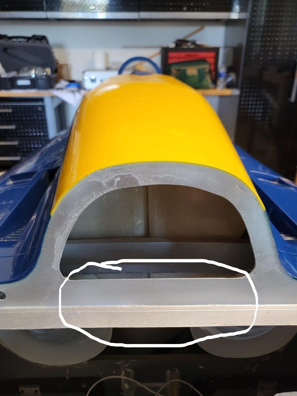

For those of you that have the BVM 1.5 F-18 single turbine version, are you cutting "this" (see pic) to move the big turbine more forward allowing the correct distance between tailcone and pipe? Pictures? I would have to move so far forward (fod screen almost touching tank) to get close to required distance with pipe. I still may have to move pipe back .25.
