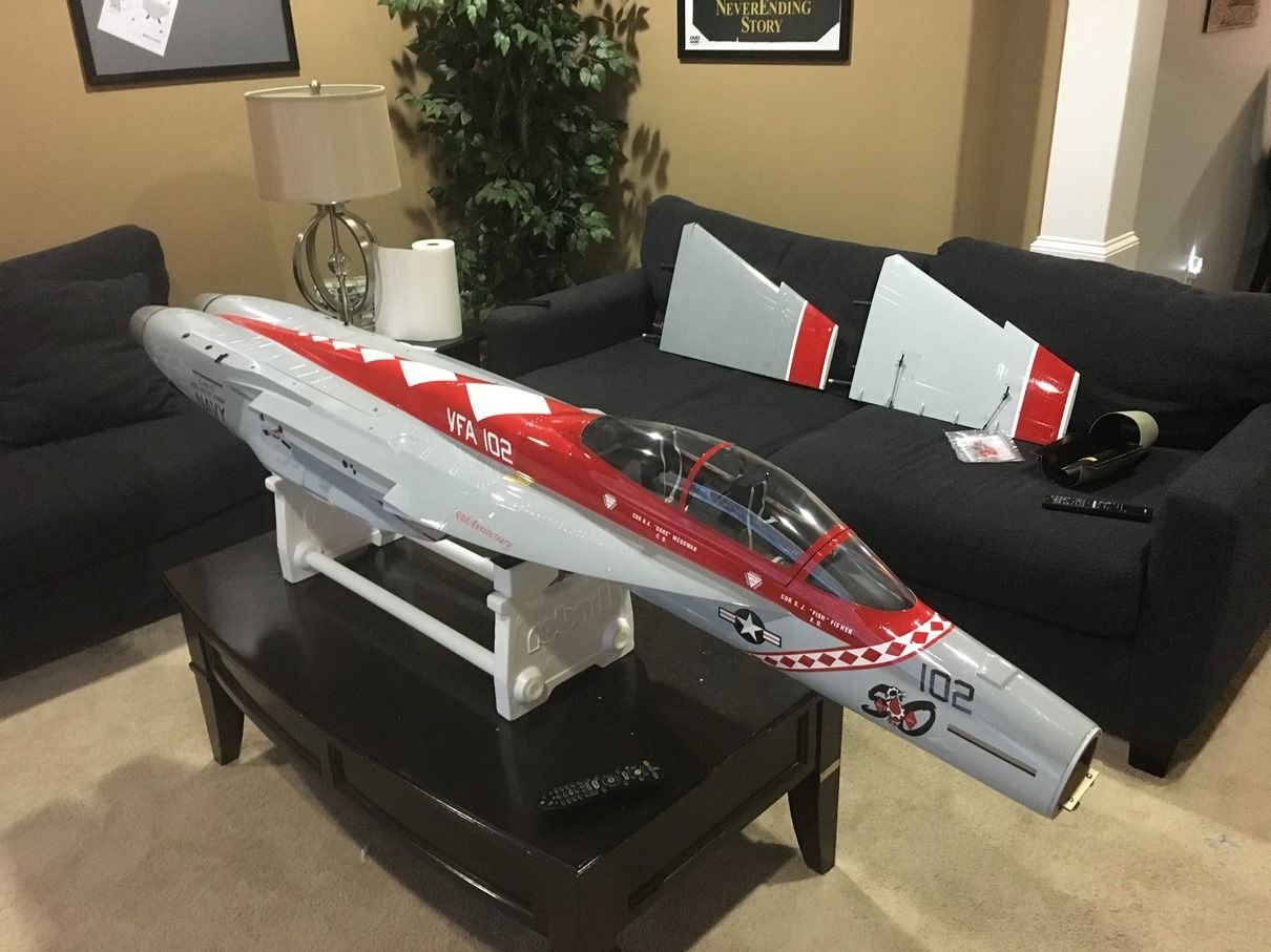

Well I'm happy to report that Patty called on Tuesday to offer another F18 that was close to my original order so I took it and it was delivered two days later (Fast shipping from FL). As you can see in the pics it was well packed. It only was damaged on the left wing root and on the left wing intake (see pics). I look forward to going through her to prep her for her maiden. Also of note, in the BVM manual, they state that you need to buy a UAT since it doesn't come with one. To my surprise, one is already installed (I'm still planning to use a highflow UAT). Enjoy
Light Ply Protection
Damage
Damage

I’m very jealous that yours has arrived, and it’s making me wish I’d ordered that scheme.
apart from the damage, what are your first impressions?

I clearly see that JetLegend hasn't learned the concept of Military Flat colors.

Anyone got a recommended technique to easily take the shine off?
Funny you say that! The one I ordered was a Diamondback with Flat paint but if I wanted that one, I would of had to wait and additional 5 to 6 weeks (its already been 14 weeks). I decided that I would just live with the gloss

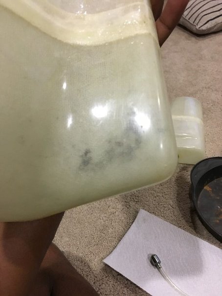

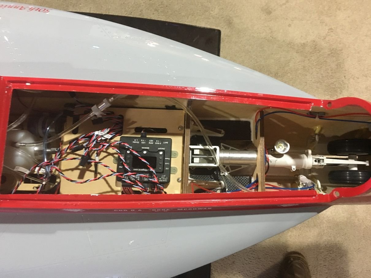

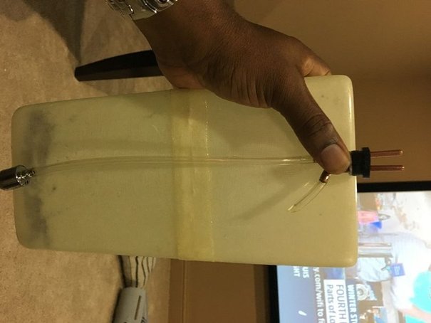

I finally removed the tanks to inspect the install and change the lines and clunks. As you can see, we have two mains and a smoke tank. One item of note was the debris inside the tanks. I'm not sure what it is but the tanks will be well cleaned before they go back in!!!! Also note the lenght of the line, I personally feel that this current setup could easily get caught in the front of the tank and cause issues.
Easy enough to just give it a coat of flat clear..

Really fine sand paper or scuff pads on gloss will dull it from what I hear. I would def add a piece of aluminum tubing to the clunk line to prevent the clunk getting stuck forward.

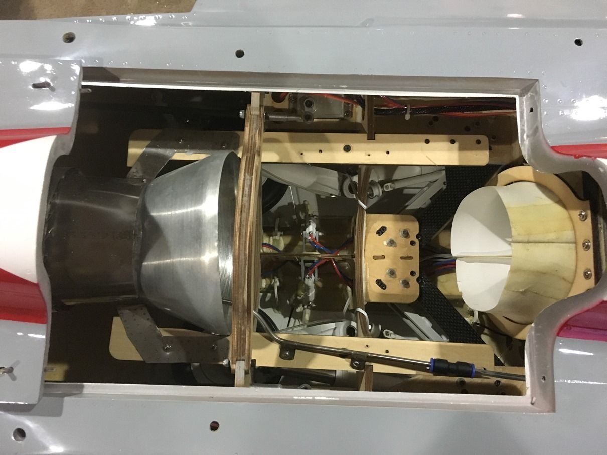

The exhaust is to my belief not suited for 200N thrust . The outlet diameter is quite small .. we suspect at 200N it will eventually fail . Reason for that is due to relatively small outlets the excess energy will turn into heat build up.
keep in mind the exhaust made by Tam for the yellow aircraft twin F-18 has a 65mm inner diameter for a 200N thrust turbine VS a 50mm inner diameter for a 160N thrust turbine...

Default F-18f pnp bvm
Here are photos of the Y/A twin 200N pipe compared to the PNP F-18F pipe ...
