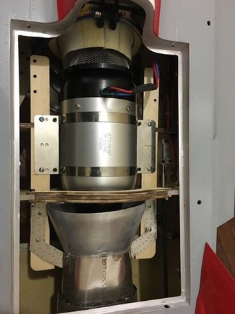

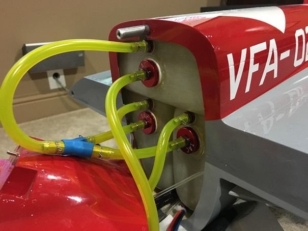

For those of you who are interested, the capacities of the three tanks are are : Saddle = 1,680 ml each (total of 3,110 ml) and the Hopper / Smoke = 1,840 ml.

How difficult was it to remove the tanks?

Fairly easy. You first remove the intakes (Held in place by a wooden ring) and then slide them straight back and out. For plumbing, I'll separate the fuse halves so I can safety wire everything (That a total of 4 bolts to separate the fuse halves).

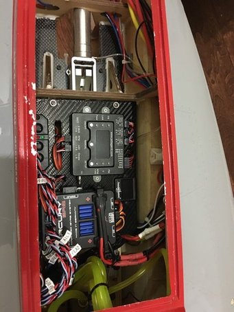

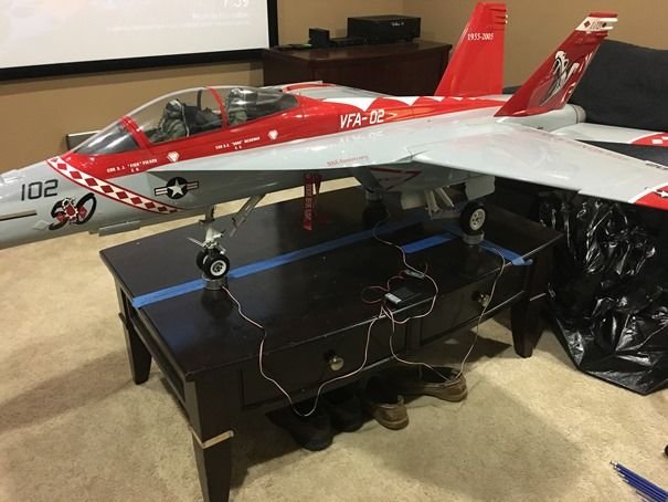

Lots of progress made! After having to wait for parts due to an ordering error, all tank parts came in, were installed and leak tested. I've also installed the turbine and completed the first start. Fuel system was preforming fine and no issues (again, the Merlin is tuned down to around 170N). Balance wise, I believe the setup came out great, with my three batts (LiFe 3s 3800 and 2 lipo 2s 2600's) she didn't need any weight added to balance at the recommended spot. For those of you who are interested, she came in at 33.5 lbs dry (only UAT Full).

No detuning the 180. The plane handled it fine. I did two laps at full throttle, but no high G maneuvers. I have been playing with the CG. I am still moving it back. Right now I have all 3 batteries in the nose. I did not weight the plane, but I have not added anything. I am running just the saddle tanks for fuel, the hopper/smoke tank was empty. The control throws in the manual are wrong. I used .75 up and down on the ailerons, it was plenty. Much less flap than called for, and a lot less up elevator with flaps than they call for.

I finally got around to getting the AUW so here it its: 43.00 lbs (19.5kg) AUW and 33.5 lbs (15.2kg) dry (only UAT Full). These weights are with all three tanks converted to fuel and full cockpit.

Originally Posted by JoelP View Post
What tank fittings are those you used?
The tank fittings are interairco and the high flow felt clunks are from nexusmodels.co.uk and are the "HI FLOW BRASS & FELT CLUNK TANK FILTER with Viton O Ring - LARGE".

So I took my tanks apart. There was no debris in the tanks, however, the cluck pickups were 1" too short on the saddle tanks. Almost a pint of usable fuel...at least 1 go around .
Great examples of why you should always check key systems on any build other than your own!
Were they not touching the bottom of the tank? They don't need to be at the very back of the tank.
