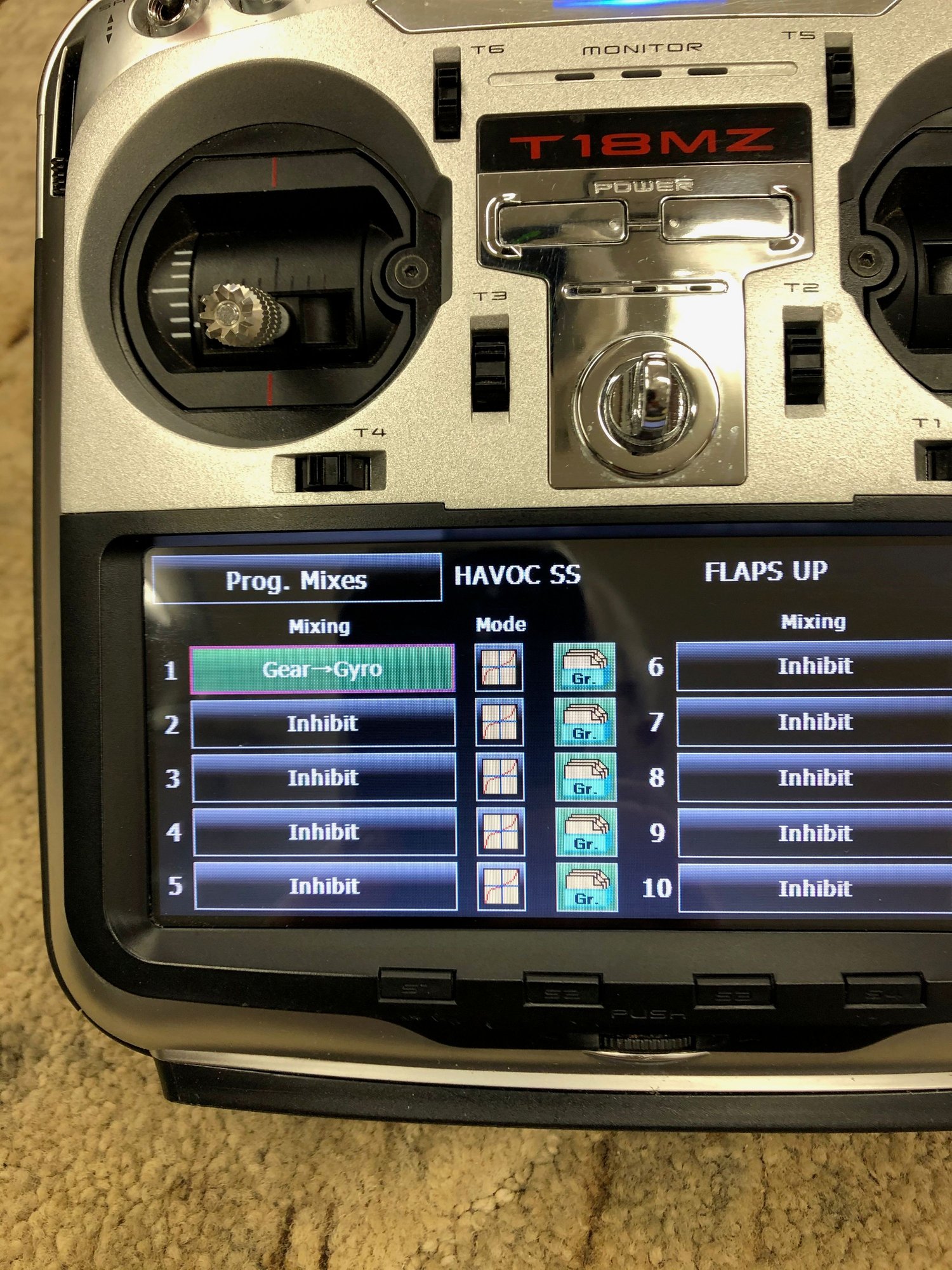

Originally Posted by DAN AVILLA View Post
Matthew I have been using the cortex's on my jets for years with futaba. I use program mix's instead of futaba's gyro setting. It allows you to stay away from heading hold side of the gyro. Heading hold will crash the plane . The real advantage with program mix is you can have a switch to turn it off and set up the volume control on one of you dials to increase and decrease the sensitivity to get it were you like it. Then lock it in. I use my gear switch as a master. My normal rate I start with is 50% gear down and 30% gear up. Most of the time it works fine. Dan
You gear switch changes the gain from 30-50%? I would like to see your mix setup. Can you post pics of the steps?
Old 04-16-2020, 09:54 AM
  #803
DAN AVILLA
My Feedback: (12)
DAN AVILLA's Avatar
Join Date: Dec 2001
Location: Prescott, AZ CA
Posts: 693
Yes I use 30 gear up 50 gear down. On the program mix page you can see I assigned SB as a switch . Any unused switch will work. I use this as a way to turn the gyro off if I ever have a problem with it. The fine tuning section is real cool. This allows me to increase or decrease my 30/50 settings while I'm doing my first test flights. Once I happy with it I will change the mix and disable the fine tuning.

Dan are you using the default values that come set in the Cortex Pro?
Old 04-16-2020, 10:03 AM
  #805
DAN AVILLA
My Feedback: (12)
DAN AVILLA's Avatar
Join Date: Dec 2001
Posts: 693
Yes on jets I have not found that I needed to change them. Dan

I see where you assigned fine tuning to the right dial, thanks,
