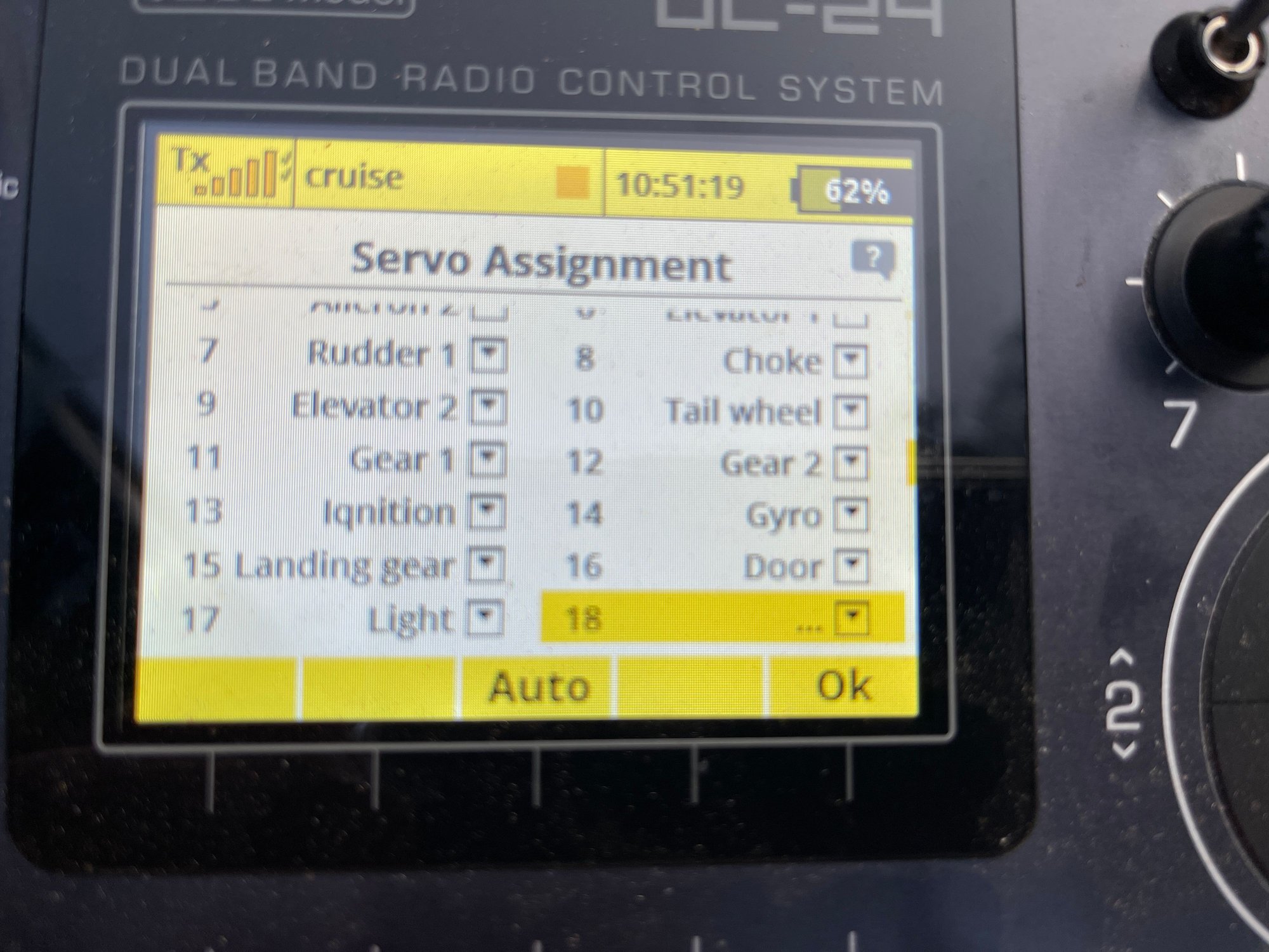

Having some difficulty setting up mu Cortex Pro
I am using CB 400
Jeti DC 24
i went to function assignment and set up P7 (knob on right side) as Gyro Sens.
then, i went to dual rate Gyro Sens, and set up a switch SG to kill the gyro, so it is at 100%, and when I flip to Zero and position 3, the dual rate is set to 0%, 0%
in device explorer, i see:
Rx1>>>>
Switch>>>>
I then turn system on, insert plug, the cortex pro recognizes the 2 receivers.
then, i turn off the system''
then, I will turn on system with bind plug in, and go thru the training
I've got it memorized since I ve done it, probably 50 times!! LOL
bump right aileron
bump left aileron
bump push elevator
bump pull elevator
bump right rudder
bump left rudder
2 bump, i release the left rudder to center then turn the knob (P7)
and I never get the green lights***********************
anyone seen this before?

figured out the problem.
it is not the GYRO.
it is an issue with the CB 400 and the assigned output slots.
this model has 17 different plug ins, including the gyro
so i am using the CB 400
but for some reason, when I assign gyro to any channel above 16, it will not recognize it.
so i have this light.
I reassigned the light to slot 17
and I placed the gyro on slot 14
and now, it immediately recognized it and all is good
now, I have to see if slot 17 works for the light!!!

The gyro must be in channels 1-16 its in the manual.
