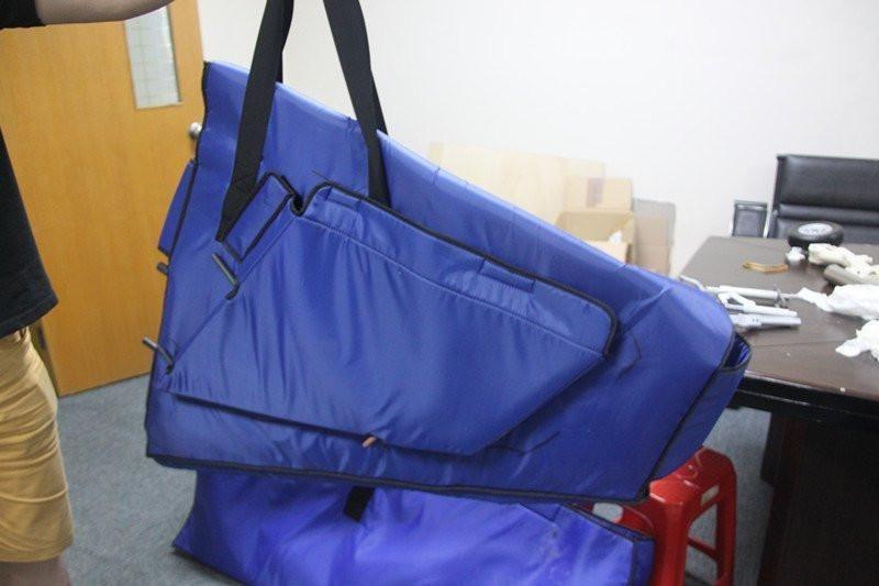

I'm using a Skymaster 1/5 F-16 wing bag. Had one for my SM and it was too convenient. It holds both wings, both stabs, both ventrals, and the vertical fin. Only had to mod it for the front vertical fin post to fit. Got the first one from Skymaster, got this one from Dirk at Pacific RC Jets.

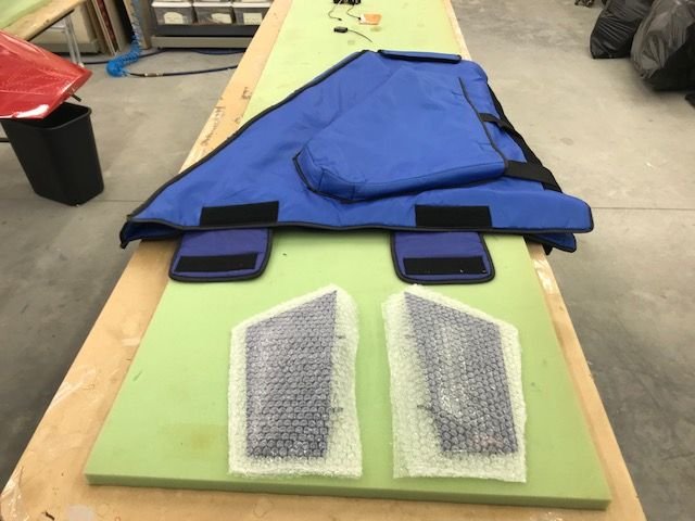

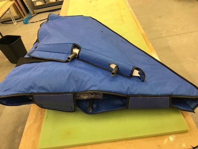

Bill,
Photos of my SM wing bag. Everything in one bag.
Here is my SM wing bag and the bubble wrap and hot glue bags for the ventrals. The ventrals slide between the wing roots in the bag and the velcro closures hold them in place. I remove my tip rails and missiles for transport also.
Had to make a hole for the forward vertical fin post to fit the BVM fin. All else fits good.

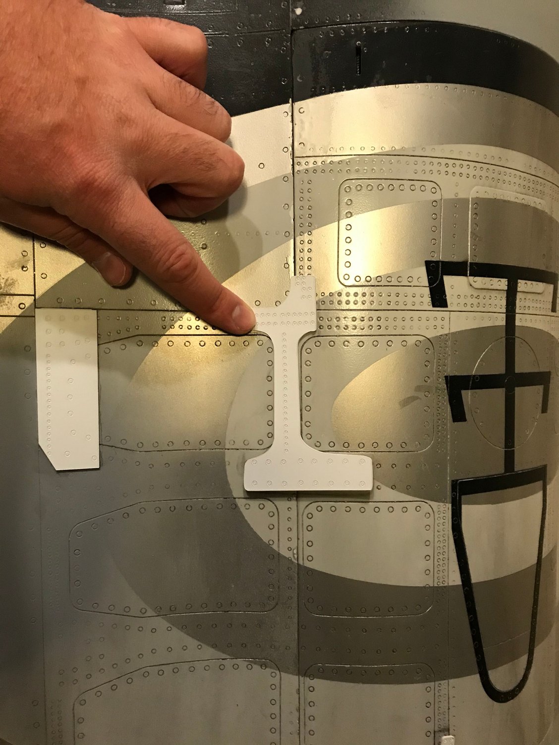

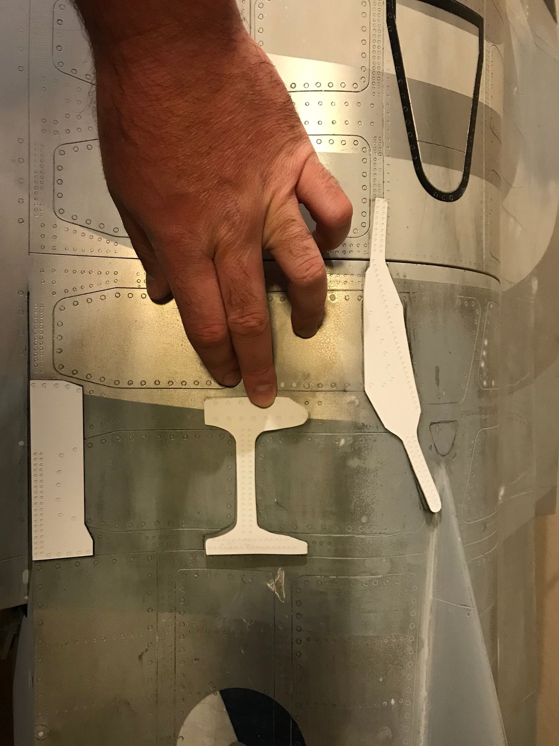

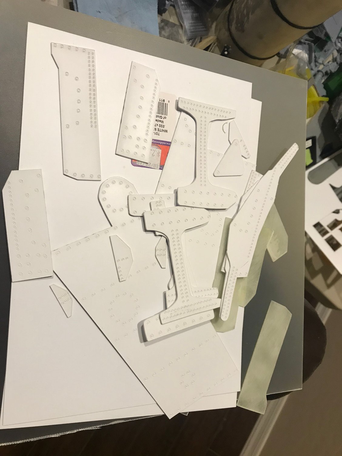

Hey guys- ive been scaling out my F-16 (SM) and shes getting ready for a military paint job. I made cad files of all the reinforcement plates with rivets- laser cut and laser riveted. Modeled after yours truly crawling around on the full scale with tape measure in hand! Includes beef up plates for the top of the wing as well! $45 shipped for 1/5th scale, PM me if interested.
