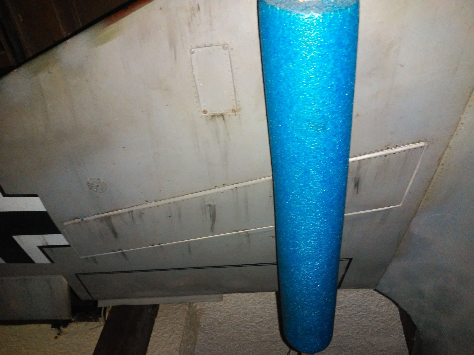

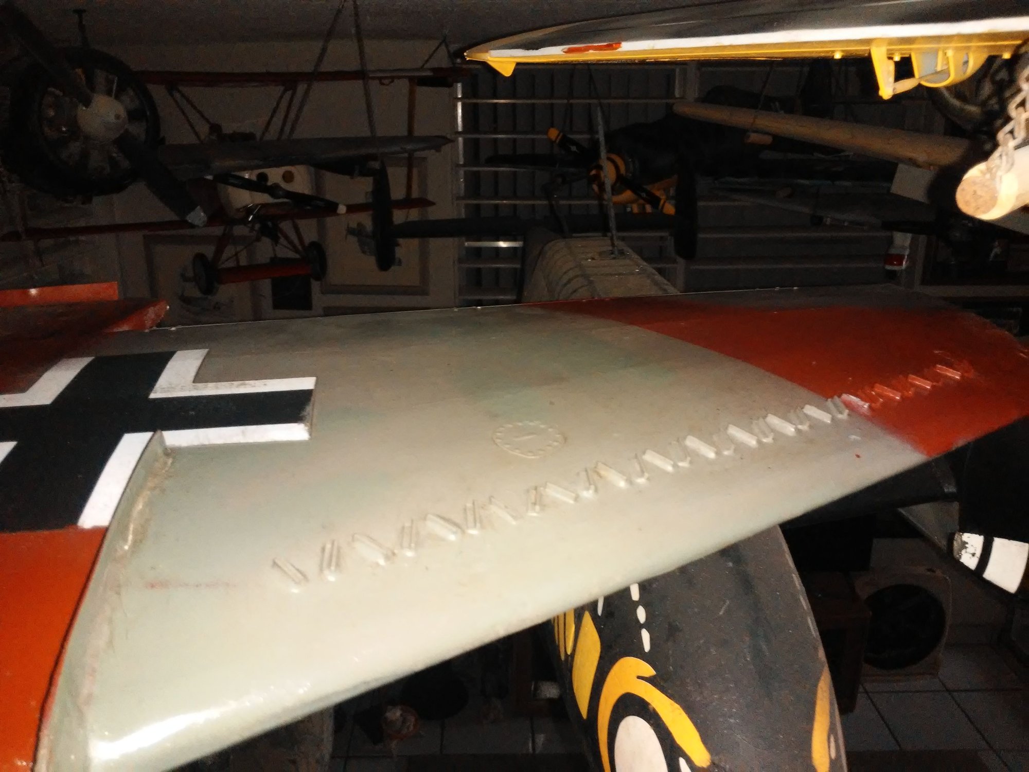

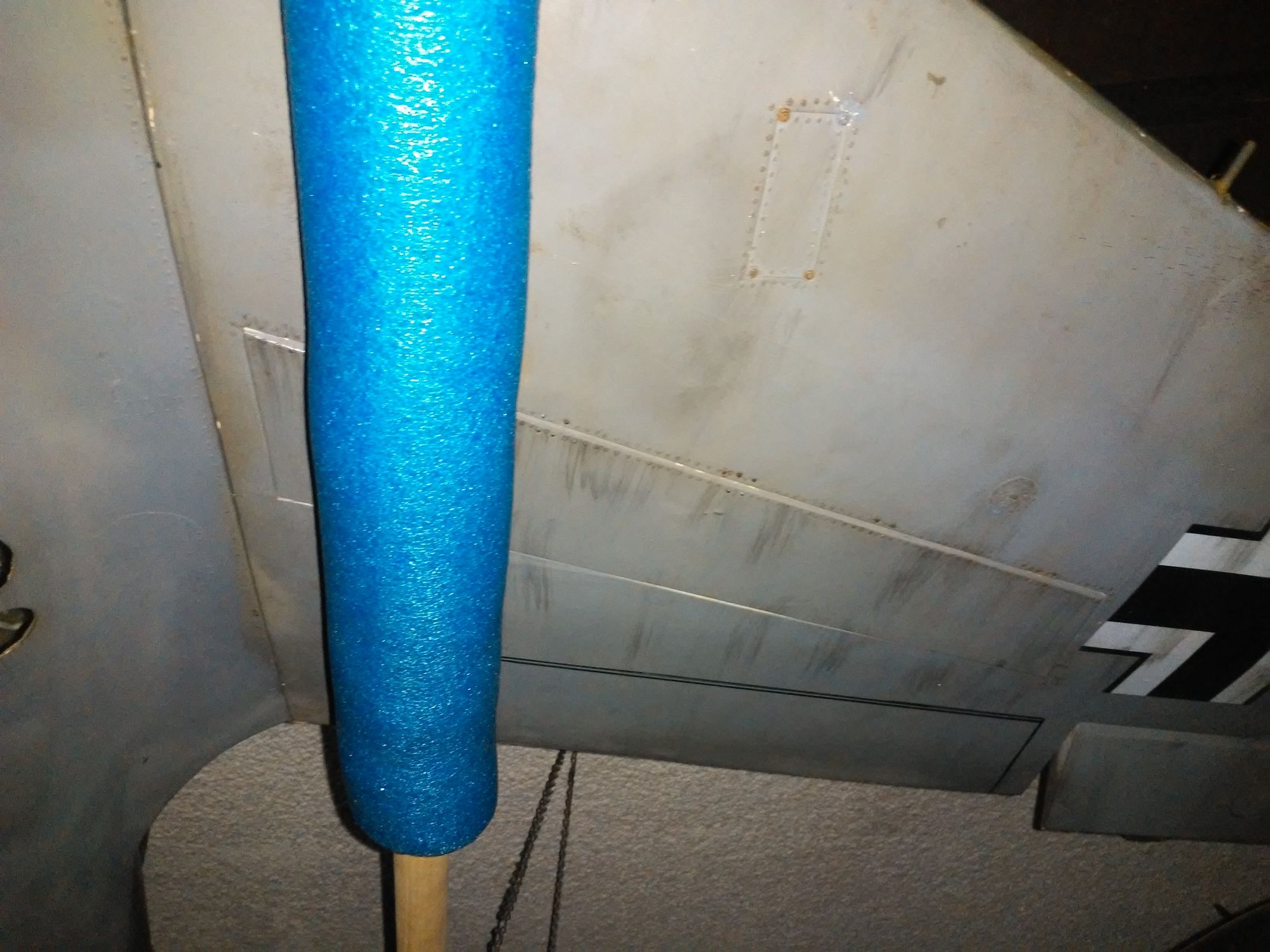

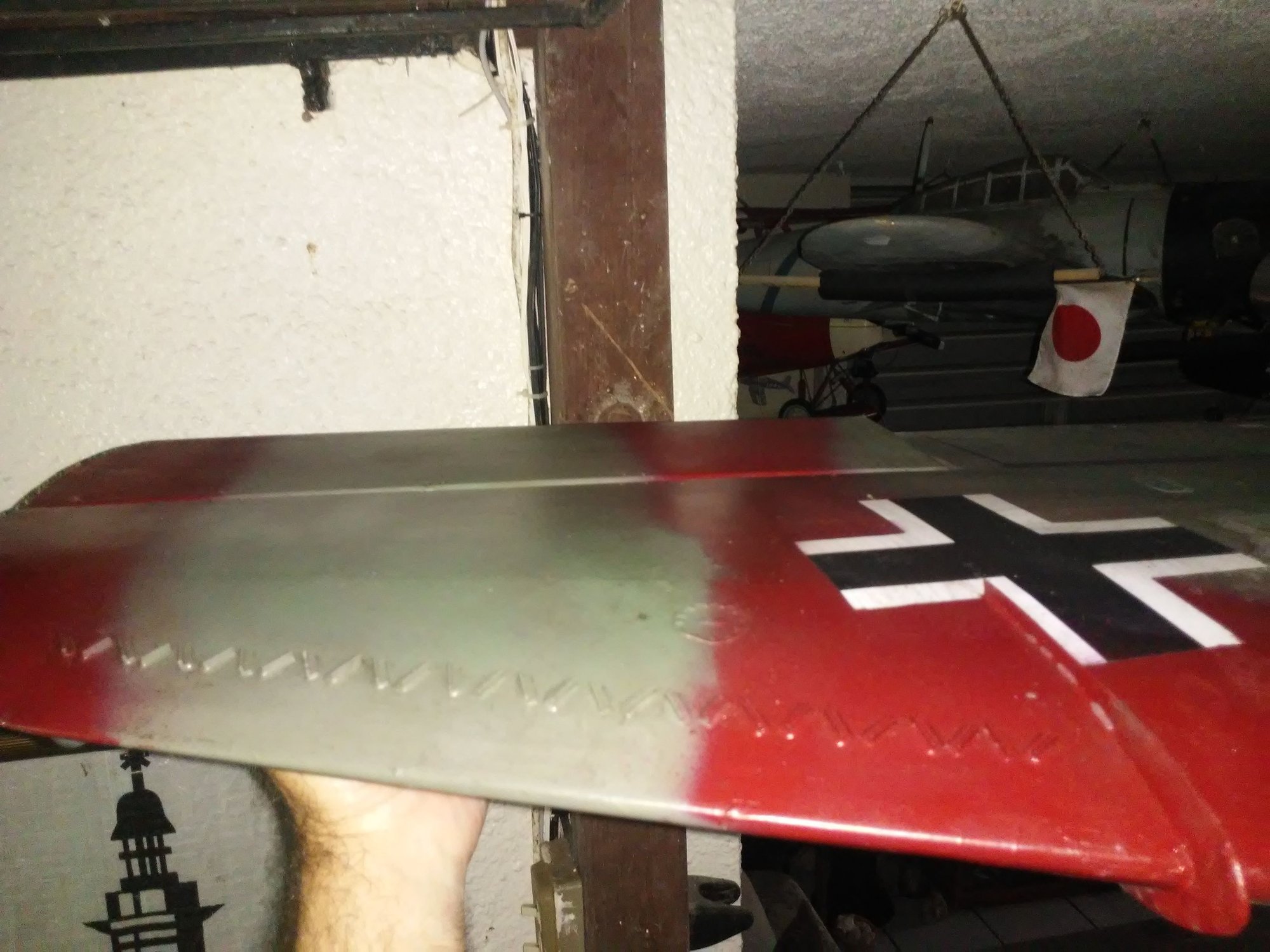

DW I did not build in the wings the slats. I did install a fence fence in the wing lead edge right in the line were the elevons start. I did this to direct the air flow at slow speeds thru the elevons. They do a fanstactic job.
I also installed Vortex generators in the wing lead edge between the wing tip and the fence.This vortex generators are excellent to increase lift in the area behind them and so tip stalls are very improbable at slow speeds. I instaled the Vortex generators after the maiden flight and after a very strong snap during take off which would have destroyed any airplane, Due to the very fast roll rate of the ME 163B, I was able to complete the roll which the snap had initieted and continue the take off. This occured at a height of not more than 4 feet. The snap occured due to a high up elevon input in take off at a not so fast speed. This was with the original Super Bee turbine.
The flaps are located in the exact place as the full size plane. Thet are alos of the exact dimension. No mix for elevon is required when deployed at mid throttle to low. Not made for full throttle deployment in the full size plane either.
Any more questions I will answer for you. Love this plane and the way it looks and flies. It has won three Jet contests in my club mainly due to the "weirdness" of the plane and it Take off and landing process. It also flies superb and it will never, never, never even if you try to do it, spin.
These are photos of both features Fence and Vortex Generators
Right wing Fence and Vortex generators
Lefty Wing Fence and Vortex Generators
Left wing Flap, located in the exact position and size of full scale ME 163B. Near the lead edge ids the servo hatch for access.
Right wing Flap, located in the exact position and size of full scale ME 163B
