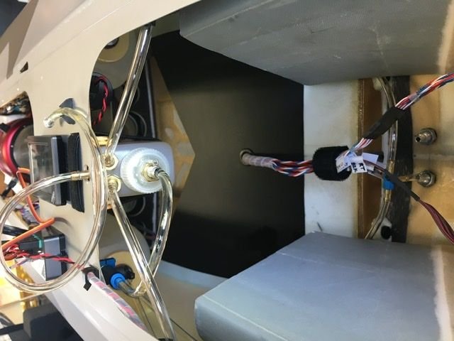

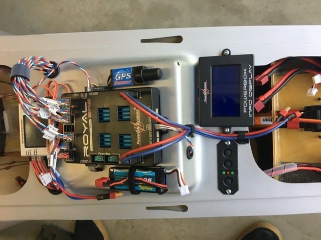

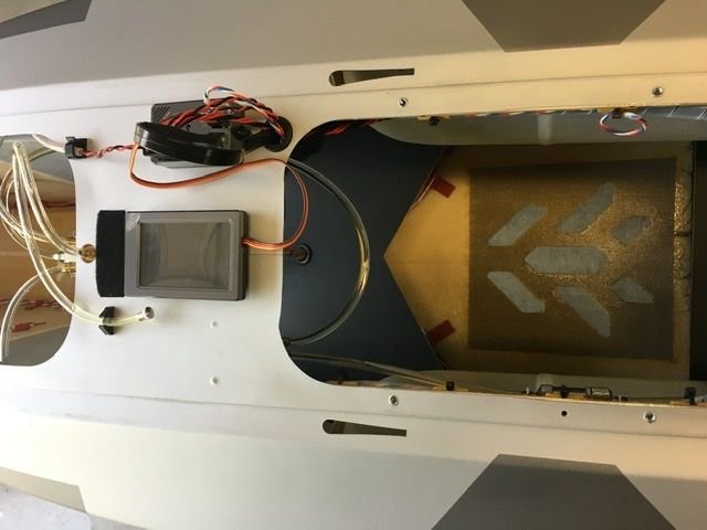

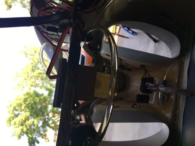

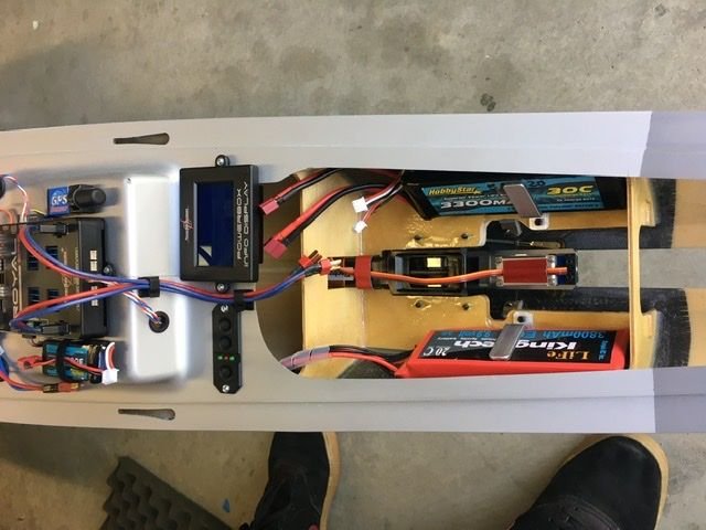

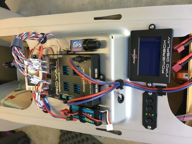

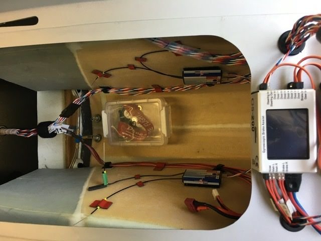

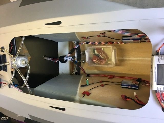

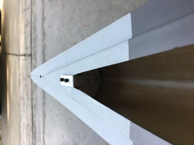

Here are some pictures of my “build”.
ASHLOK connectors, Powerbox heavy gauge wiring.

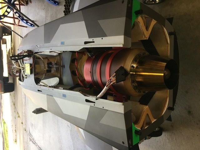

KT320 is a sweet engine. Dual tanks, seven minutes with ample reserves.

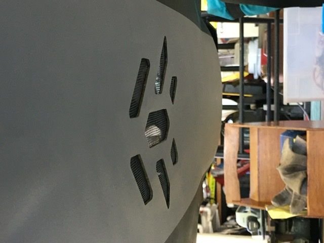

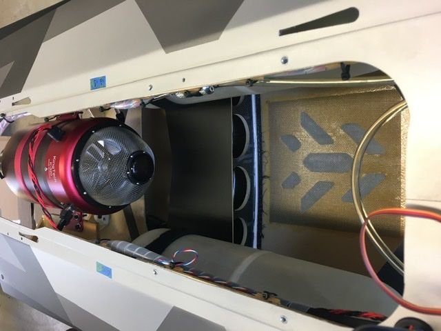

ZivBit mod of course. KT320 stuff, pump and valve under shelf. Smoke not installed but self contained unit.
Dual flow MAP, all 6mm Festo lines, no issues with flow.

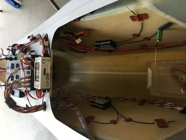

Powerbox Rx, Electron GS-200.
Not much surface area for mounting things in the V2, but enough.

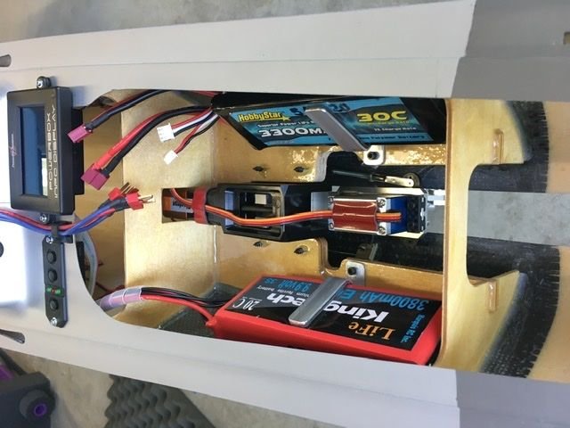

Dual 3300 Rx packs and ECU battery up front.
Still needed about 6 oz in the nose. Admittedly nose heavy on purpose. Just until tail will not stay on ground.
Keep fasteners in box, don't fly until the box is empty.
Beast mode.
You can get creative here!

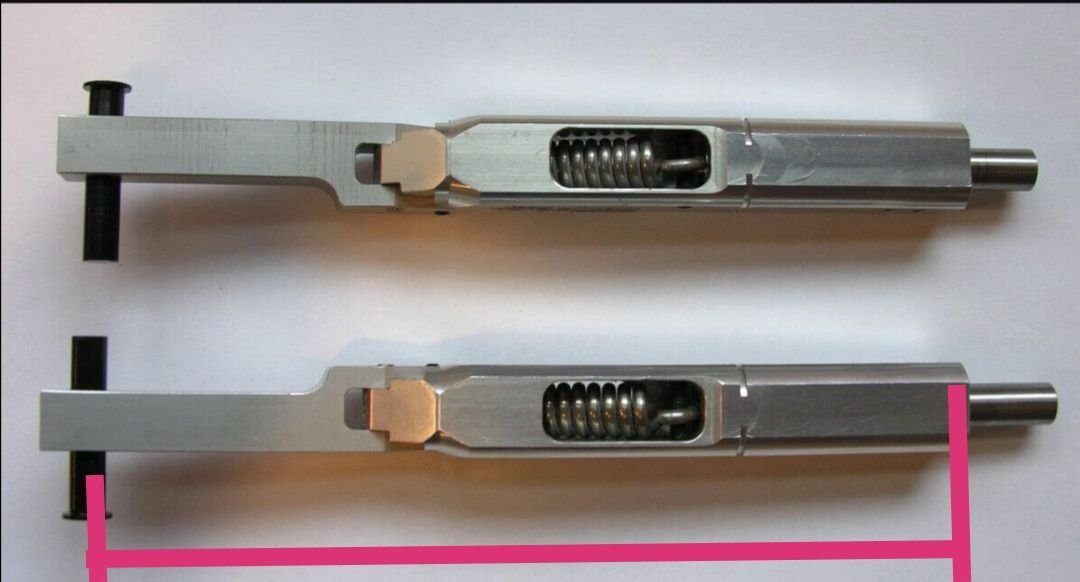

About the gear I'm asking some measurements because I'm designing a 3d printed model of the gear while I'm waiting mine that might take quite long time due to the covid19 delays.
So couple of requests more.
Could you gave me the measure of the main leg and nose leg please. Like I indicate in the picture
Old 06-01-2020, 06:32 PM
  #647
husafreak
husafreak's Avatar
Join Date: Dec 2004
Location: Livermore, CA
Posts: 897
Received 9 Likes on 8 Posts
With a flip of a switch you could go to a basic flight set up and then is is a sweet flying, precise, and easy to land airplane.
I did a quick check approximately 225mm plus the steering arm on the nose and 185mm on the main. Maybe someone who hasn't mounted their gear yet can give you a picture or more precise measurements. I can't be very precise without cycling the gear or removing the covers. My measurements are on an angle to the axle as well.
