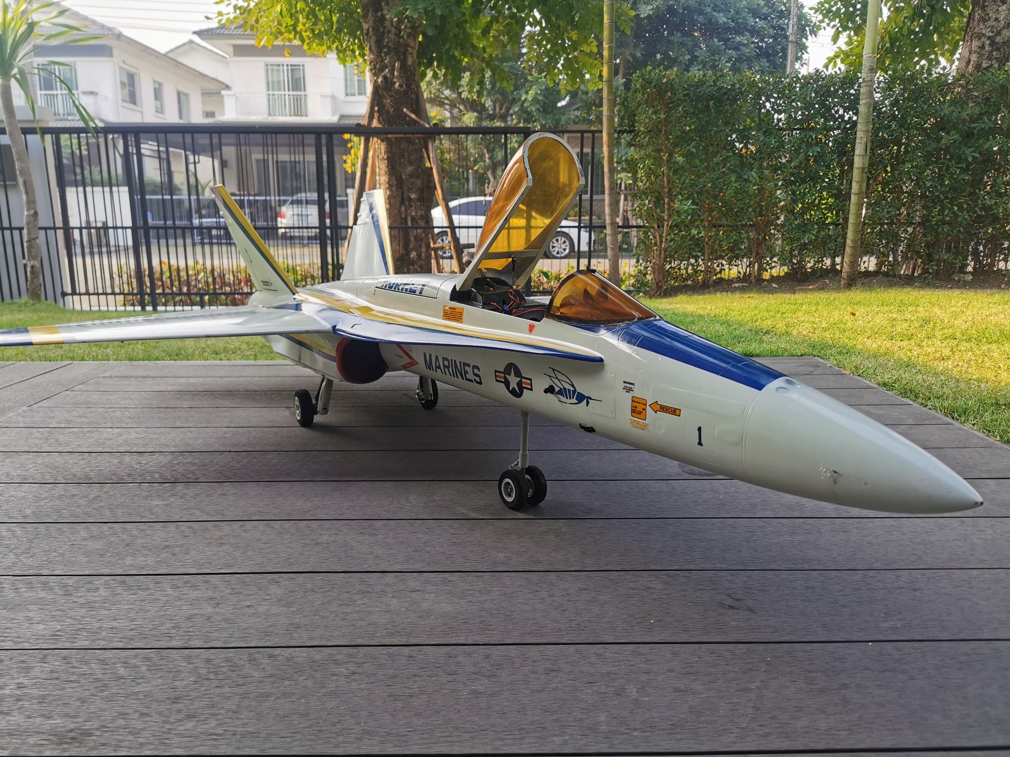

Hi, glad to know someone is still flying nitro ducted fan. Here is my OS.91 VF on Ramtech ducted fan unit in F-18. Unfortunately, one blade was broken recently. Still searching for it's replacement part.
Werachat C.

Would it be possible to use the fan from an electric unit if you can find one of the correct diameter?
Don

I see them on E-bay from time to time.

I may still have some Ramtec parts stashed away. Iíll take a look and let you know if I have what you need.
Werachat,
PM me your address and I'll send you some replacement blades

Werachat
I didn't count the blades in your fan. That is a Dynamax fan (11 blades) and not a Ramtech.(9 blades)
You can still get Dynamax parts from Tom Cook @ Jet Model Products.
DYNAMAX DUCTED FAN UNIT (jetmodelproducts.com)

I searched all the most likely spots in my shop yesterday and didnít find any old fan parts. There are still a few other less likely hiding (storage) places that I can look, but at this point Iím not very confident that I have any of that stuff left. Iíll take another look over the weekend and let you know if I find anything.

Oh, really?
A guy who sold this to me told this is Ramtec. If it is Dynamax, I will find spare parts much easier.
Thank you so much sit
Werachat. C.
