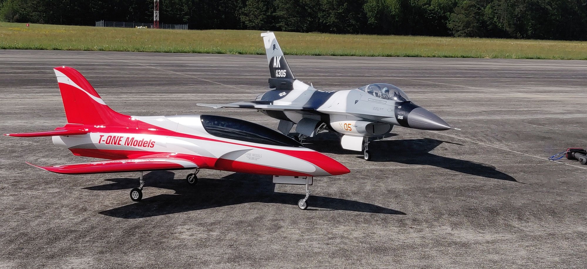

Finally got my maiden in today along with my F-16. The Mini flew great although I found the recommended throws a bit too sensitive. I also found the stock brakes with Xicoy LG-15 controller to work fine. Came to a smooth straight stop. Hopefully get a few more flights in tomorrow.

Three more flights today. Tried out the smoke. W as a bit windy but mostly down the runway. Going to enjoy this plane.

Congrats! I have the same color scheme and I really like the way it looks in the air. I didnít do smoke on mine but the pics you posted makes me wish I had.

Thanks. Yes, with my not so great vision I picked the red as I have a Mini Avanti EDF in red and I can see that well. If I could see better, I probably would have went with the blue or Red Bull schemes. Been flying for about twenty four years and this is my first plane with smoke. They made it easy having the two tanks in the plane and although I've only had four flights so far, it looks like I can do an easy seven minutes with enough for a few go arounds and that's plenty of time for me.
