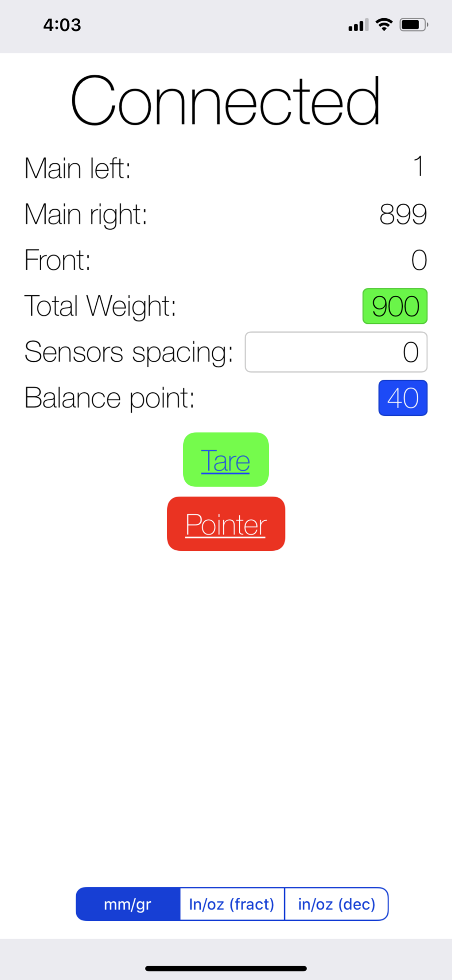

With all this talk about weights I was curious how accurate my own scales really are. I primarily use the Digitech CG Wizard but also have one of the earlier sets of Xicoy scales. Using a trio of 300g calibrated weights that we use for servicing the CG Wizards I did a comparison between it, the Xicoy, and couple of digital scales we typically use for mixing resin. As you can see they are all pretty close.
Since 900g is not nearly the typical jet weight I also did a cross check using a 50 lb shot bag. For this I used our shipping scale as well as an old bathroom scale. As you can see the results are pretty consistent at the higher weights too.
I repeated these tests 4 times each and every time the results were within a few grams on the low end and 50 grams on the high end. Certainly accurate enough for our models. Iíd boil for tea with any of them
tsk tsk tsk the Xicoy is off ;-)..
