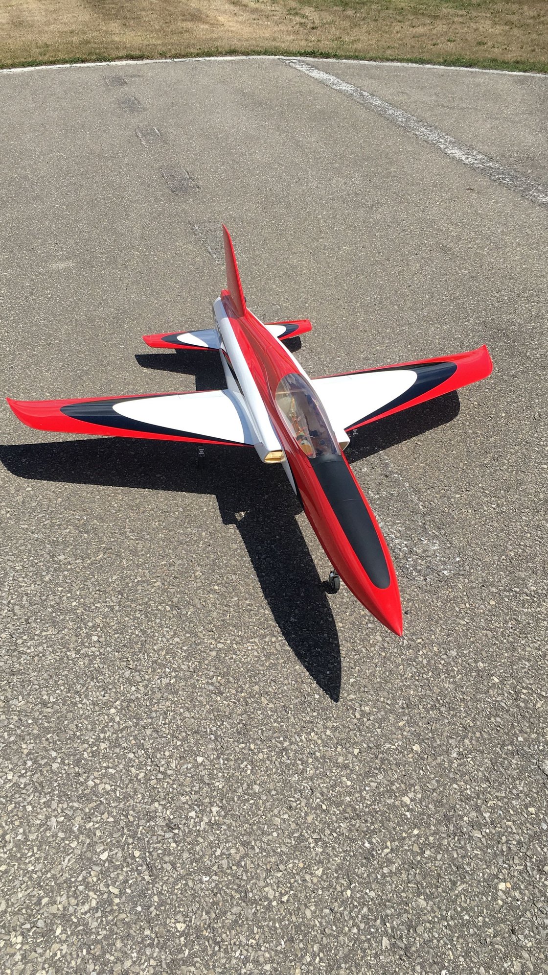

Hi all,
it's with great happiness that 10 days ago I've finally test flown my Carf red scheme, JetCat P-100 Rx my case.
I love this sport jet, top quality, it flies beautifully, it's elegant and nice to see on the rwy, flying low and fast as well as doing elegant aerobatics!
My CG at 175mm with UAT full + 2cm of fuel in the main tank.
First flight little bit "twitchy" and sensible, for sure little bit nose heavy for the first 2-3 mins, after that much better. Some up trim needed.
From 2nd fly on I readuced throws and set the exp to my needs and all great, then flight after flight I'm getting better and better with handling and flying in general.
The jet flies so well, it really needs little "touchings" of thrust to keep it flying and keeping its necessary energy, extremely efficient jet, at the point that with some good aerobatics and nice flying I can fly 7+ mins no problems with more that 1/3 of fuel left in the main tank after touch down and even this really impressed me!
I can fly fast, I can fly quite slow and always with good stability feeling but readyness to react at the controls, a thing I love. Model's light and robust, I love those wing tips litfed up "almost-winglet-like" and I'm pretty convinced all that sensibly contribuites to model general efficiency.
Full flap landings, once understood correct attitude and approach speed, are a kiss.
It's a great sport jet even while on the ground, very practical and clever to be transported and mounted at the field, 2 M4 screws for main wing (I love single piece robust main wing), 2 M3 for the nose cose (3 LiPo packs there inside my case so super easy to charge the packs, just need the nose cone with with me!), refuel and fly!
Last but not least, my model(s) (and myself!) would not fly so well without Dave Wilshere priceless support and patience, always present and there to clarify my (often stupid) questions or doubts, this including live support few days ago on my Joker's JetCat new pump presetting of some ancillary parameters to make the starts reliable and perfect...and this happened while I was on my field rwy in Italy with model ready to be started up and flown and him being in UK...absolutely top quaity priceless support, based on Dave's wide huge and long time experience and expertise on the Joker, jets and rc modeling in general!. So, one more time, a big sincere thank you to you my friend Dave!
I wish you all to enjoy your Joker at least as much as I do!
Denis

Denis
So great to meet someone so excited about this brilliant hobby. You do with each model win 1st prize for most emails per build, but one day you will have all my knowledge and it will be silent again 😄
Your journey with the Joker is just beginning, you have so much more to discover about its good qualities, there is a sweet spot for balance and elevator expo, so do not be frightened of experimentation.
Last, your dog must ‘cook’ in Northern Italy heat!!
Dave

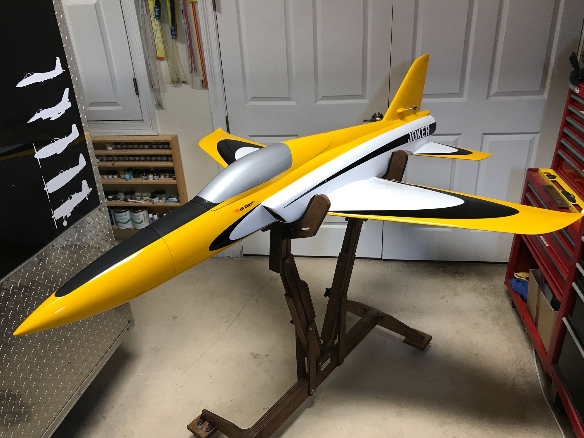

I put a cockpit together. I made a Balsa floor that I glassed then added a vacuum formed tub and a pilot.
I still want to spray the canopy with a light coat of Tamiya clear orange.

Looks like a BVM Electra tub!
