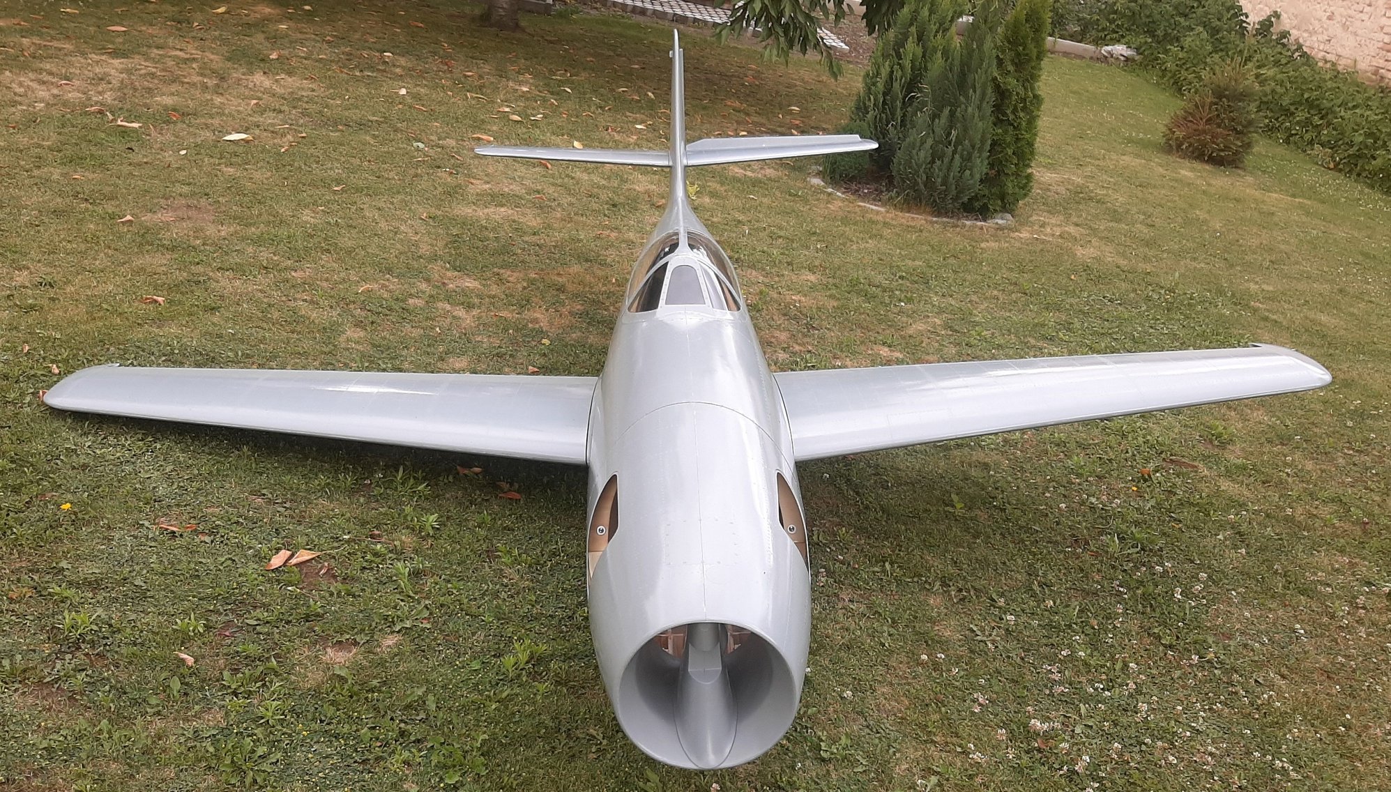

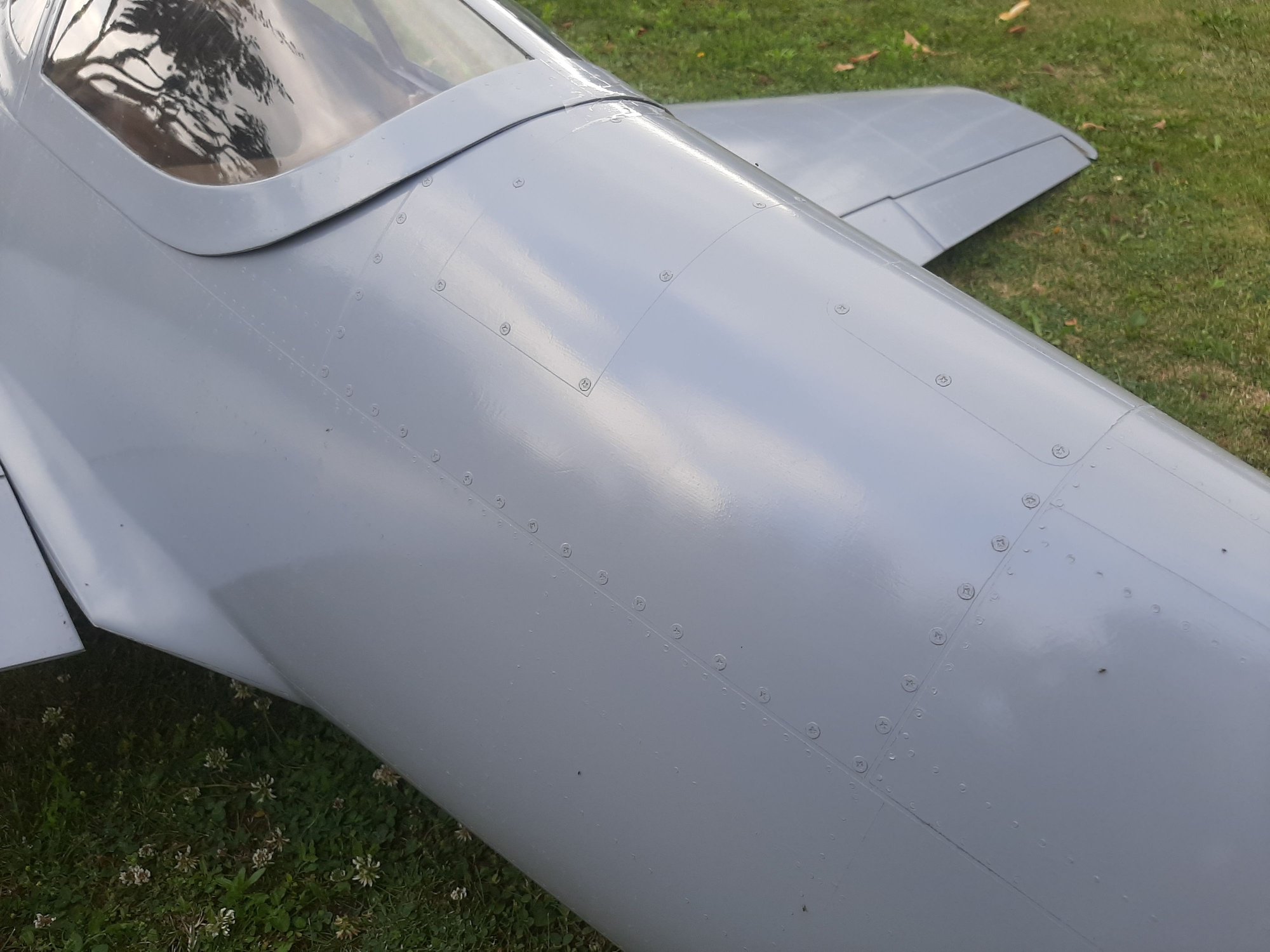

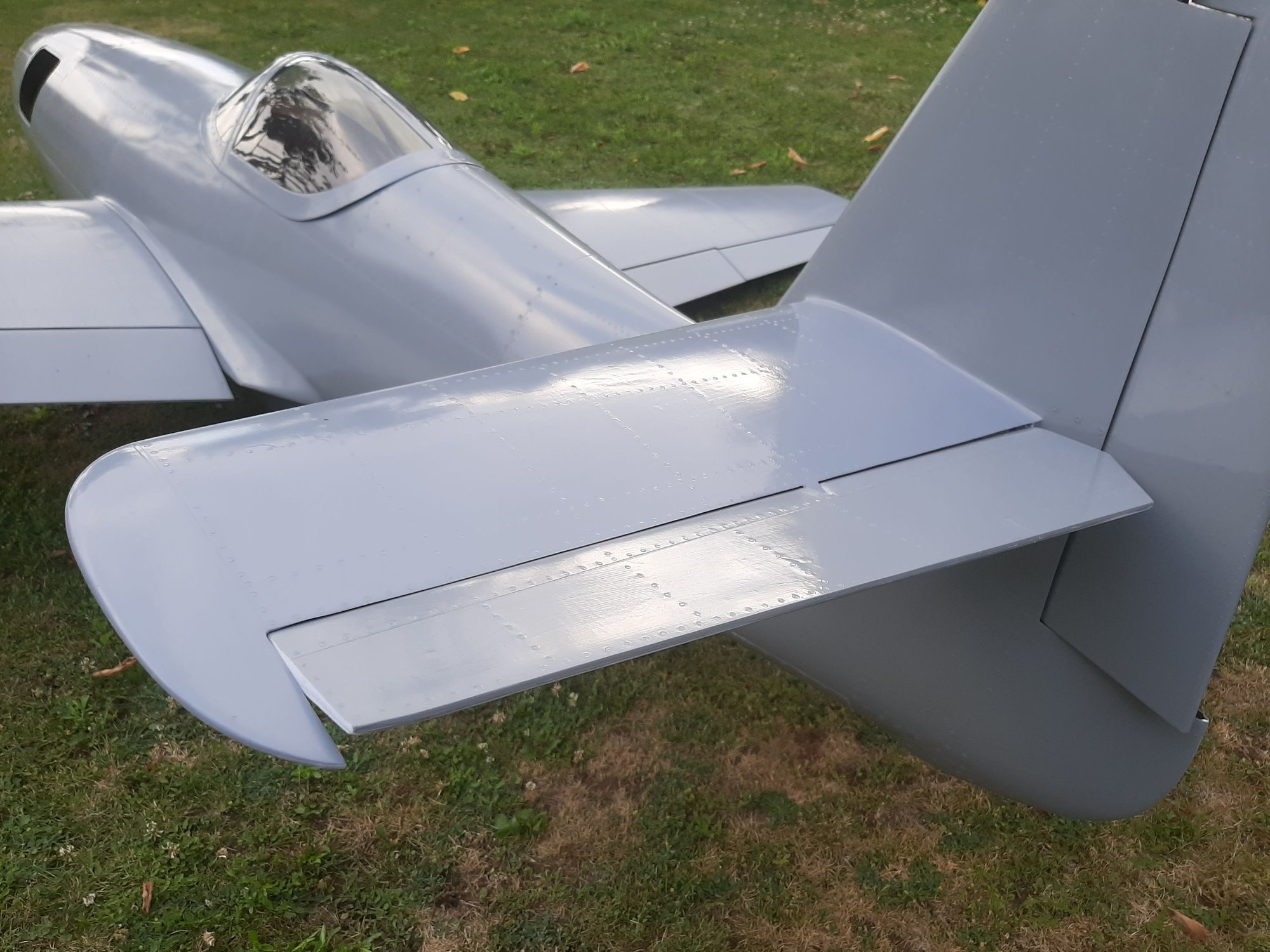

We plan to produce a full-scale model:
- Aluminum foil coating with imitation of riveting
- Imitation of the screw with 3D printing

Originally Posted by Mugu View Post
wow,is beautyful!!! what aluminiu you use?
Hi, aluminium foil with thickness 0,050 mm.

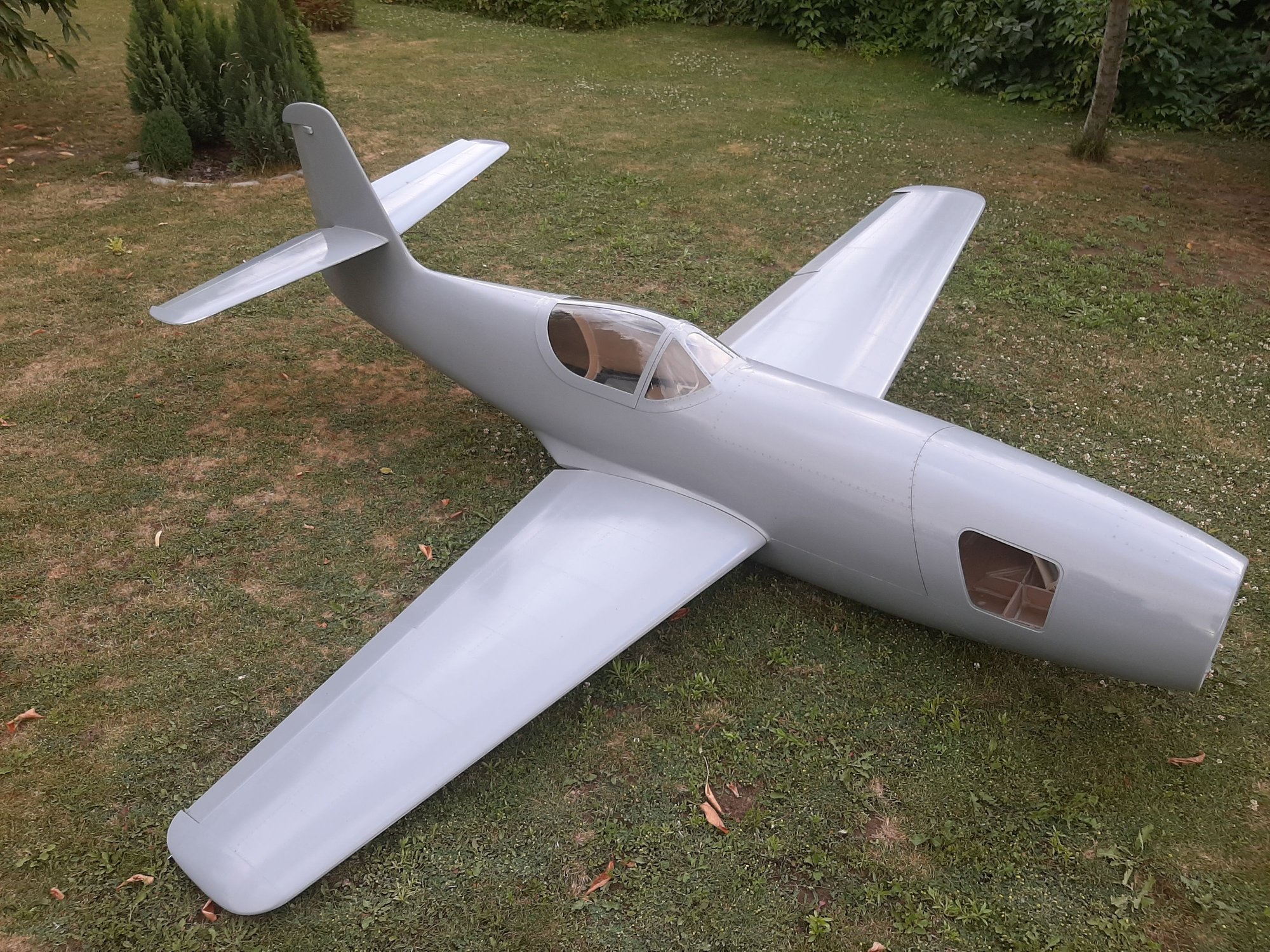

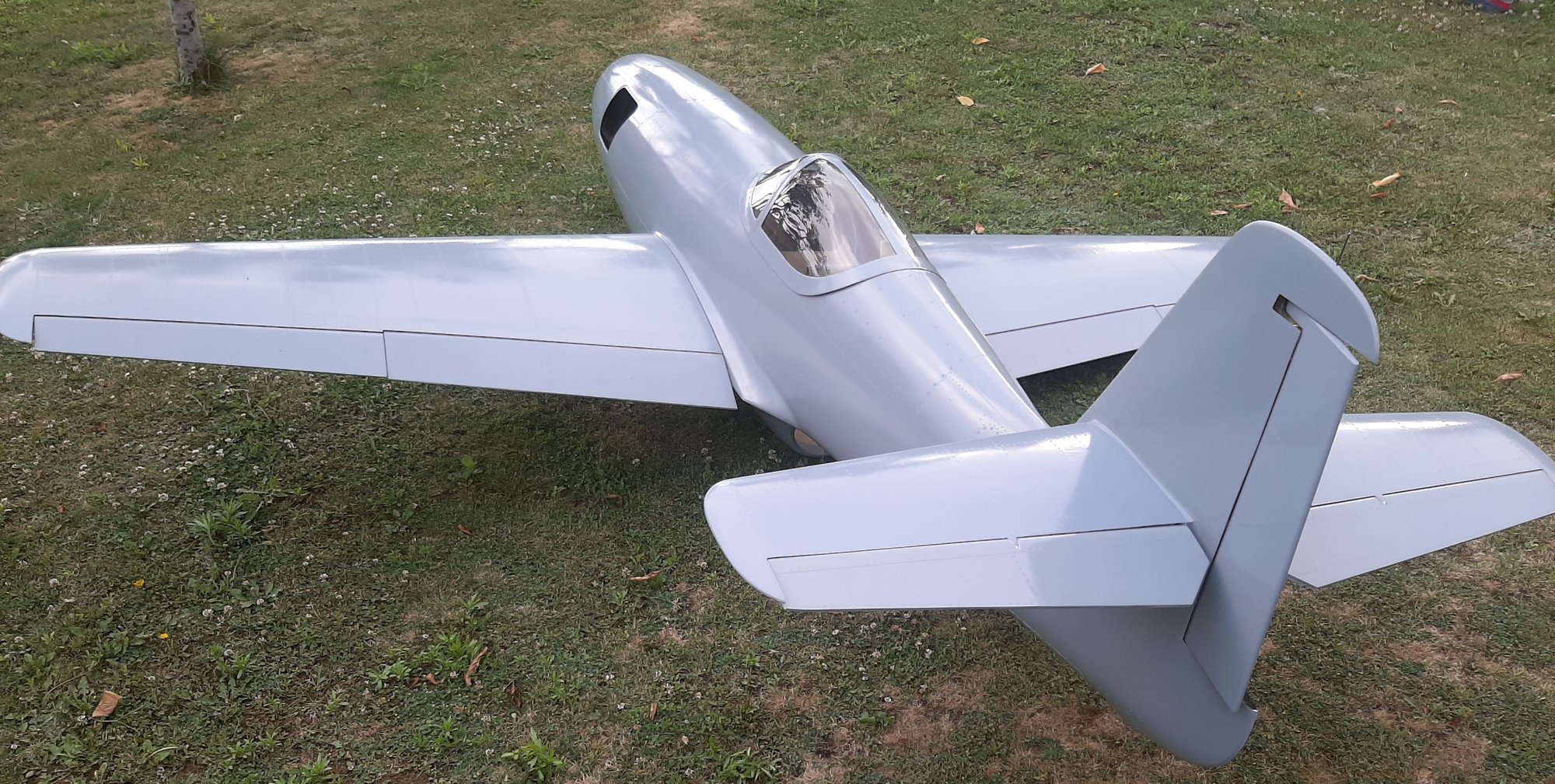

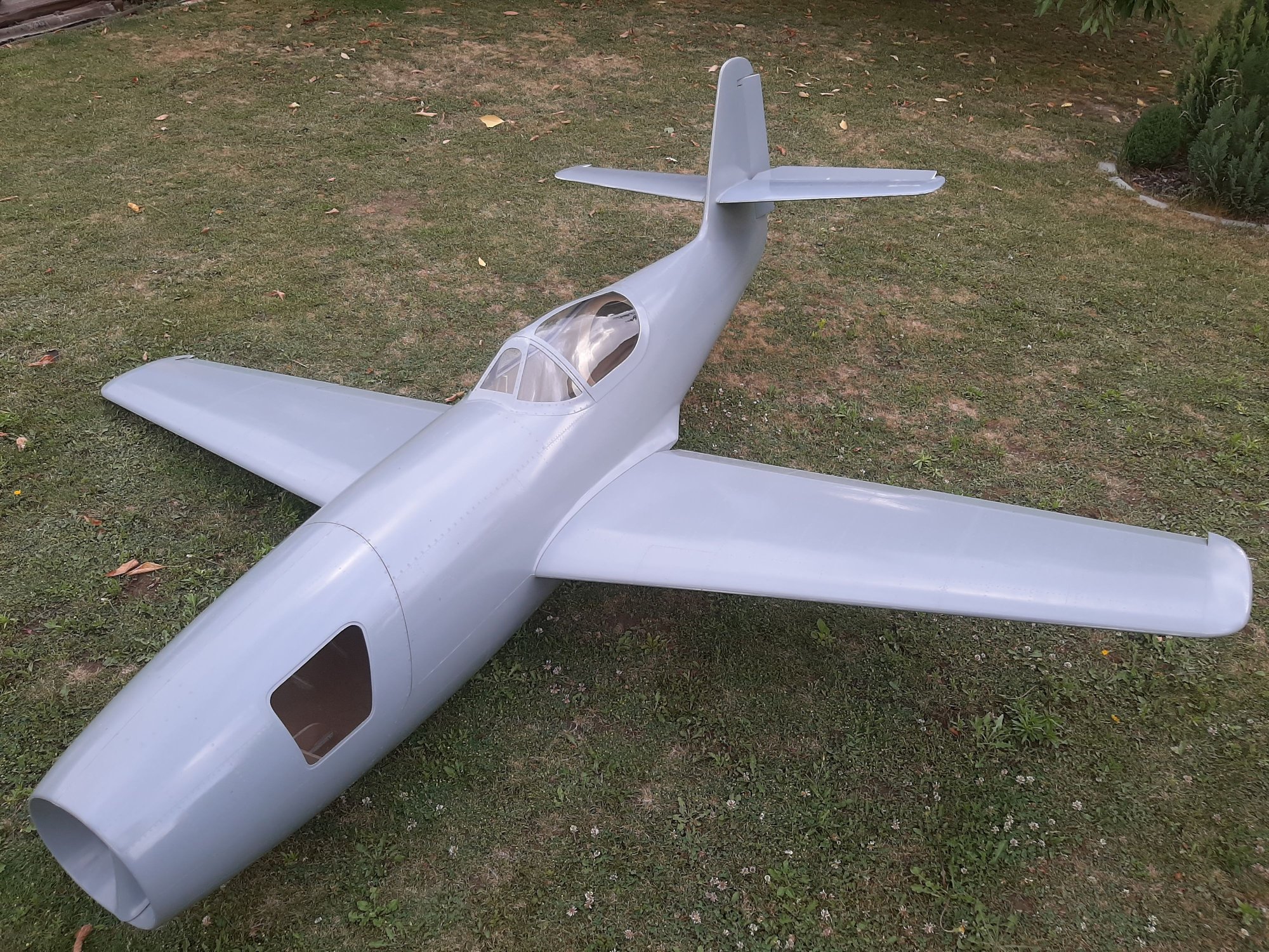

Posts: 44
Received 6 Likes on 5 Posts
Beauty was born. Soon the front part will be ready soon

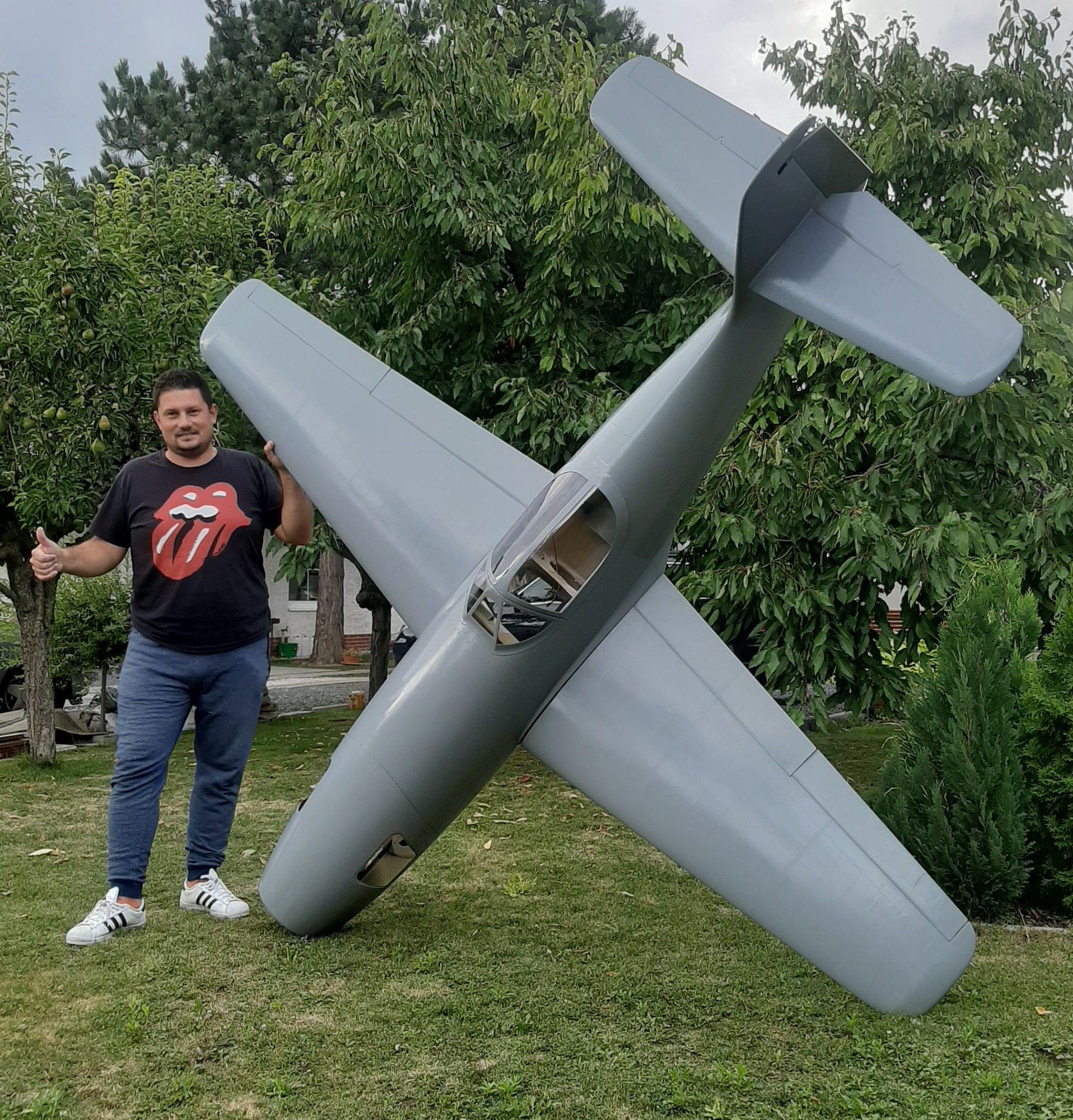

Old 08-03-2020, 04:53 AM
FilipDucker
Join Date: Nov 2014
Location: Slovakia
Posts: 44
We continue on Yak-23, actual weight 9,8 Kg with fully equipped sevos. Estimated flight weight 19,5 Kg. The prototype chasis aleredy in production. First flight coming soon.
