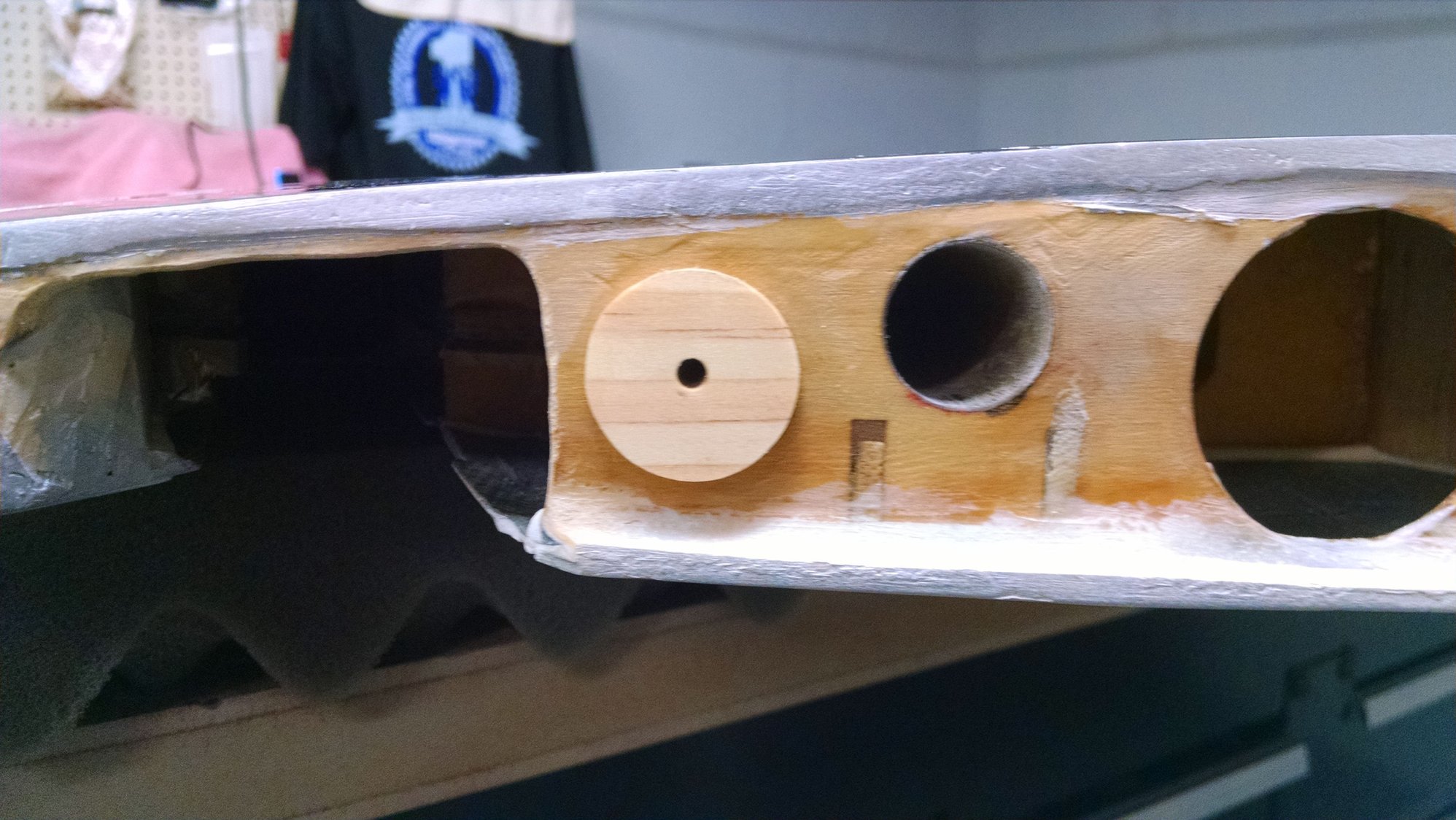

Before I could begin work on mounting the retract, I needed to have the wing firmly bolted in place so that I had accurate centering for the wheel. There is a 4mm bolt that runs through the fuse and into the wing root. Since there is a gap between the wing and the fuse, over tightening this bolt could cause the wing root rib to crack. To prevent this, I shaped and glued in a basswood wedge. Now you can tighten up that bolt as much as you like and it draws the wing in nice and tight.
Old 12-08-2018, 04:21 PM
  #106
MaJ. Woody
My Feedback: (28)
MaJ. Woody's Avatar
Join Date: Apr 2003
Location: Rochester, NY
Posts: 5,125
Received 7 Likes on 6 Posts
Up front the wing is held in place with an aluminum tab that mates up with a plywood block in the fuse. The threads in my tab were poorly tapped so I ran a 4mm tap through it and cleaned up the threads. H
ere is what it looks like with the provided 4mm cap screw.

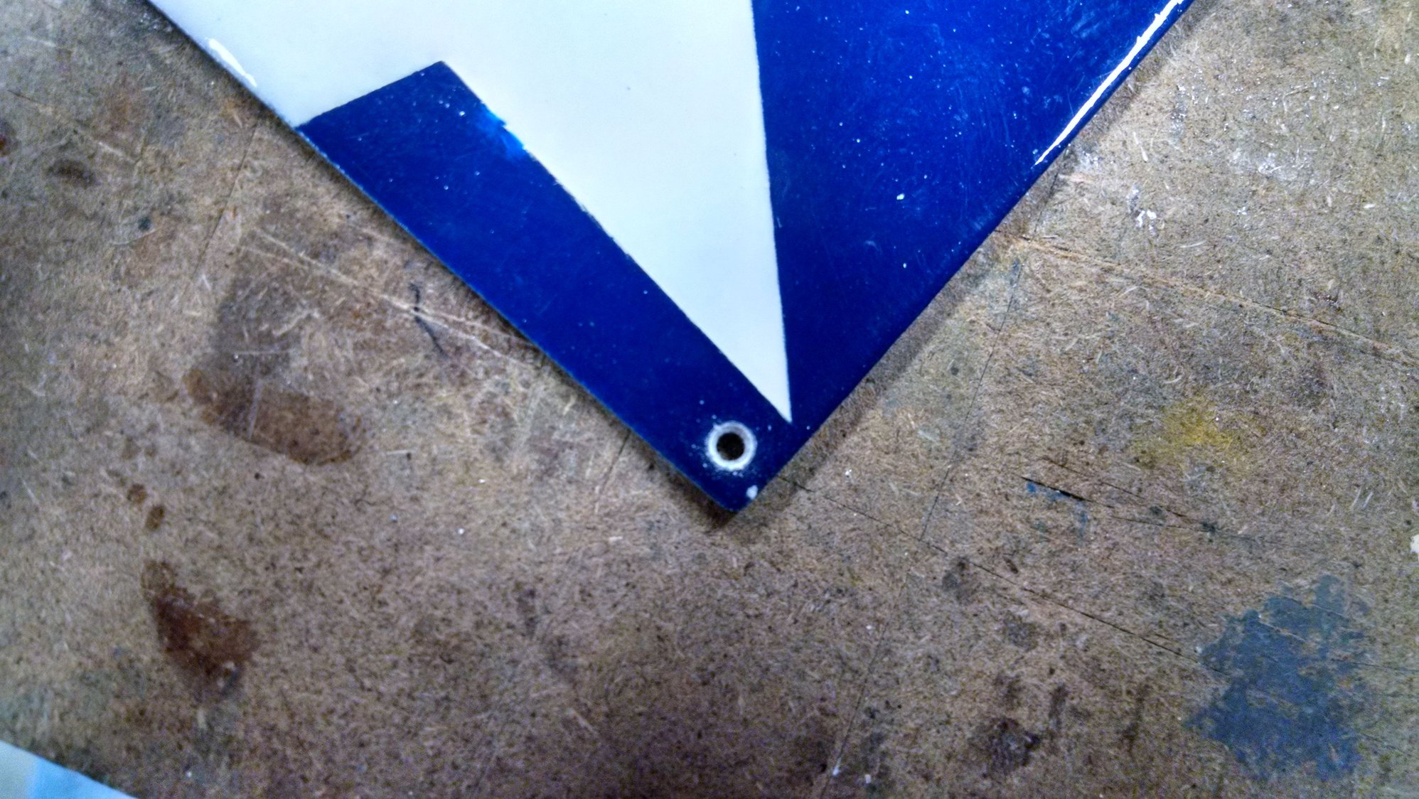

The LE Slats are operated by two Futaba 9155 servos. They are installed the same way as the other servos. Once installed, I marked the location of the servo horn on the wing and then transferred these marks to the slat. I then cut the openings in the wing LE using the dimensions listed in the plans. Some milling will need to take place inside the flap box to create clearance for the slat pushrod.

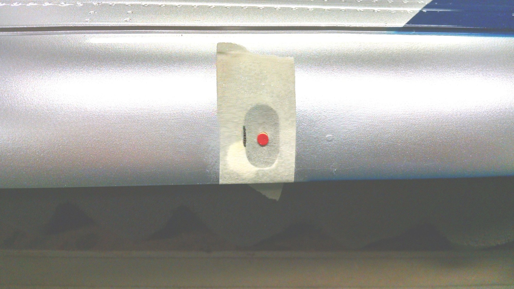

Next I needed to transfer the location of the push rod to the slat. I covered the opening with masking take and inserted a dowel in the center of the opening. A bit of red paint on the dowel allowed the transfer to the slat.

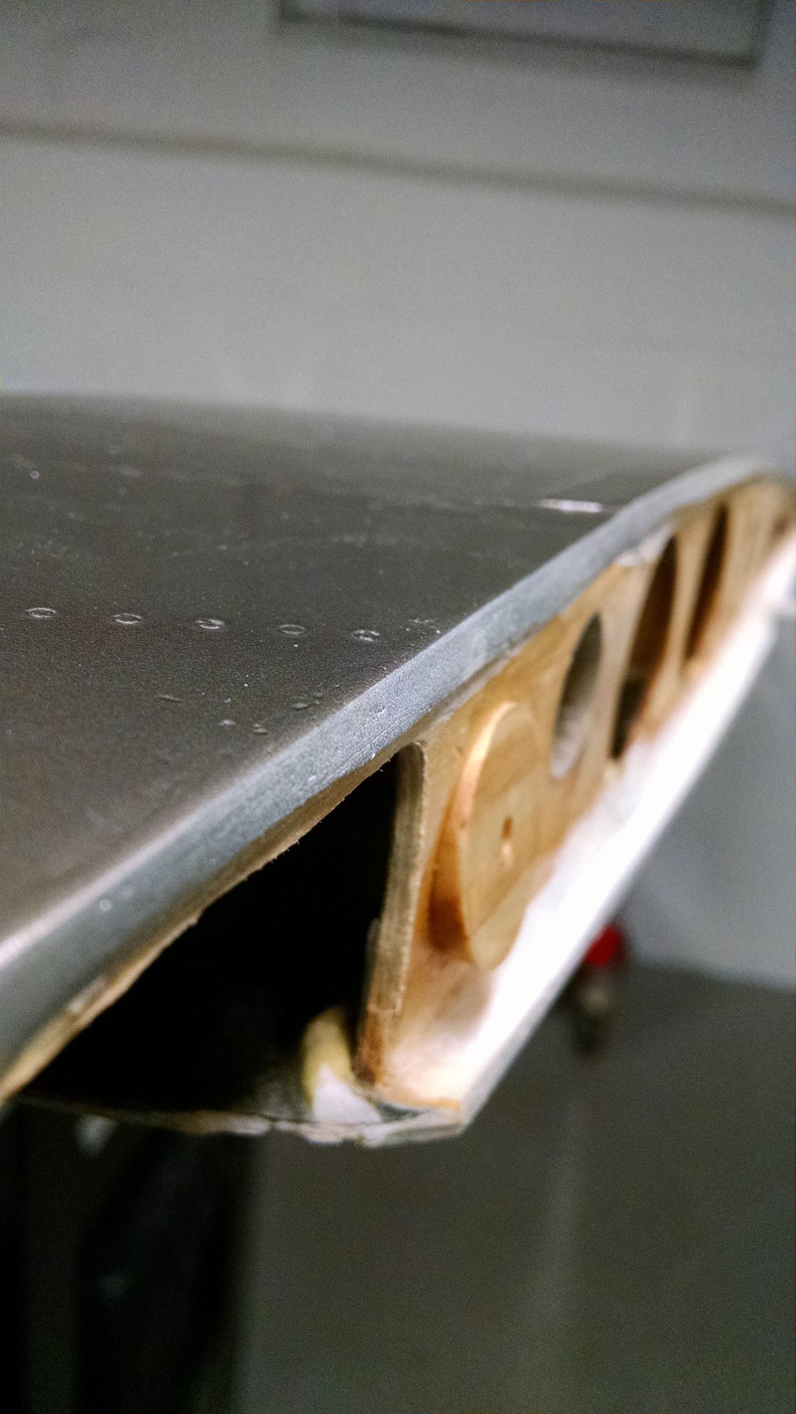

From here I was able to precisely measure the location of the slot I needed to cut in the slat for the control horn. Note that the control horn needs to be positioned at the top of the opening when the slat is closed.
