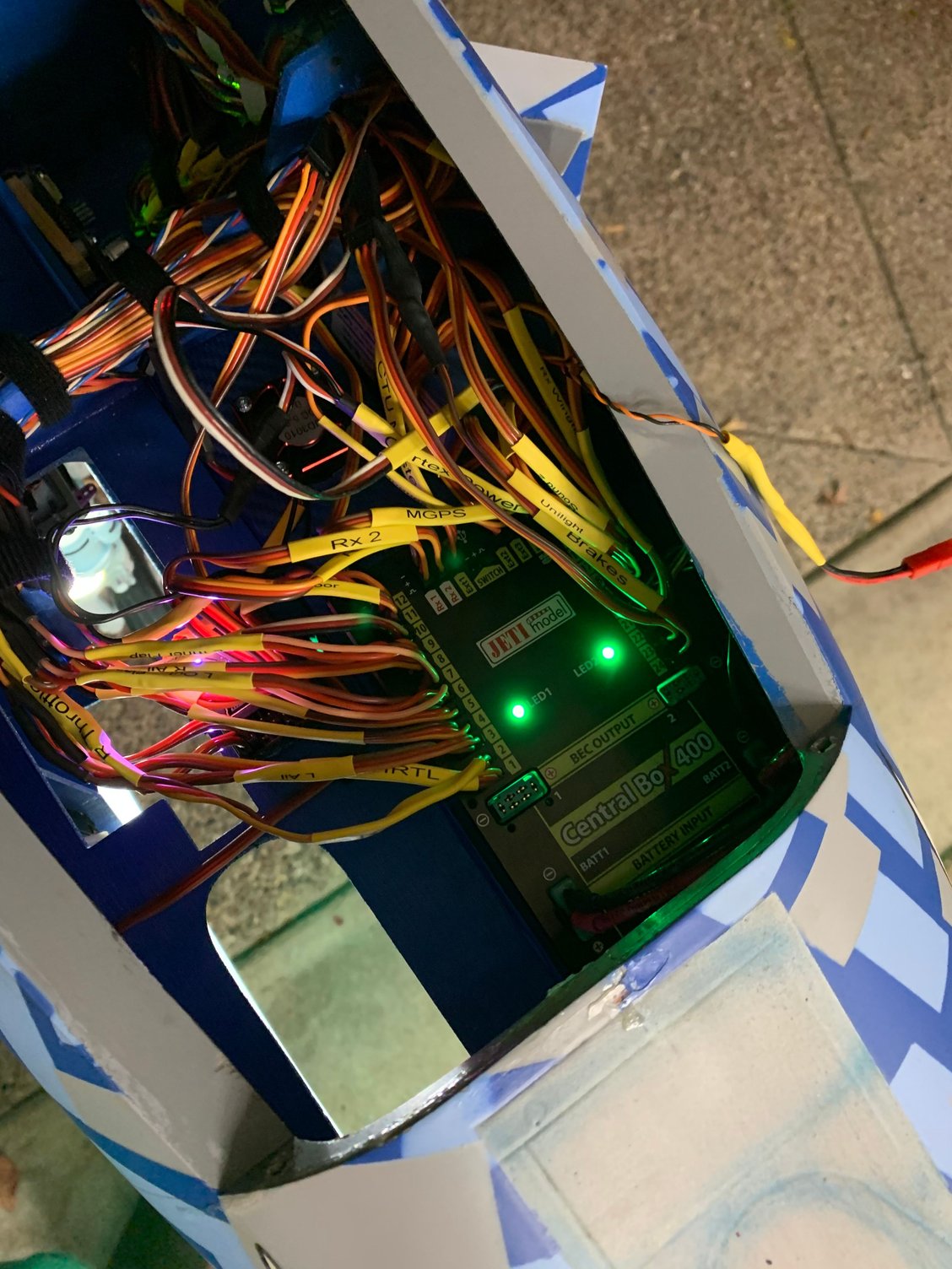

Well, maiden date is unknown now. My CB 400 is out for repair for an unknown amount of time and I am going to attempt installing a BoomaRC ARXL.
In reality, I bought the ARXL 3 months ago to install in this A-10, but the ARXL was back ordered indefinitely, so I used a brand new CB 400 I had laying around.
The ARXL showed up a few days ago!
Now, it's off to learn a new "central box" thingy in the ARXL! Yay!

Aaaannnnddd, I lied. I overnighted a new CB 400 while my original one gets fixed. A CB 400 will be plug and play in my Mibo. It will be the least steep learning curve to pursue.

New CB 400 in!
I was noticing a few drop outs of my slave CTU and getting some unreliable telemetry even with this new CB 400.
So I went on fakebook and looked up Sandor (the creater!) and he suggested I remove the MGPS from the CB 400. And wouldn’t you know it, it worked like a champ!!
No more telemetry drop outs, my LUA works EVERYTIME!
Apparently, the MGPS takes up a big chunk of band width on the telemetry bus and can slow things down! I say it can cripple!!
My last CB 400 I had to send in to Jeti (where it still is) as I was never able to have it communicate with my Jeti studio. This new CB 400 hooks up like a champ and it has the newest firmware.
This equipment hiccup has set me back a week or so.
I need to fine tune some more “radio stuff” and then I can finally CG this bad boy!

Originally Posted by ravill
New CB 400 in!
thanks for the nice words.
however the creatorof the CTU is Carsten Groen , im just the guy who does some troubleshooting and gets all the flack shot at him ;-).
but yes the mgps is a pretty old sensor , and the data yelled out is kinda overwhelming when you have more sensors in line.
this is a nice project ,if in any doubt or questions jeti or Digitech related stuff just ask ;-)
br Sandor & Carsten

I had something similar with a CB200 when I first installed the CTU and I was told by Danny to move the ExBus directly to a RX which was fine in my case since it was connected to the CortexPro and the CP had an extra power lead....the fixes the issued no more drop of the CTU. I don’t used the Mgps, but had other devices on ExBus and older telemetry protocol.
Old 10-26-2020, 04:48 AM
  #470
digitech
My Feedback: (10)
digitech's Avatar
Join Date: Aug 2004
Location: klimmenlimburg, NETHERLANDS
Posts: 3,653
Received 10 Likes on 10 Posts
he cant , he has a R3 and has no EX or sensor ports on the receiver only one im afraid.
its not the CTU the CTU throttles back the data and sends only what needed and does it pretty slow , this was done on purpose.
only thing is to get Real airspeed and use a Digitech IAS and connect directly on the CYTU free EX port.
another option he can try since the CTU limits the data send to the ex bus (anti flood) is to connect the Mgps directly onto the CTU that could slow down the mgps a bit.
many more ways to Rome with Jeti...

Carsten Groen
Carsten Groen's Avatar
Join Date: Nov 2004
Location: Denmark
Posts: 1,803
Received 12 Likes on 9 Posts
Correct what Sandor writes regarding the CTU and "throttle" of telemetry values. I made the CTU (and also the SB-EXP2+2 as well as all of my other Jeti-enabled devices) so that it requests telemetry data "on turn" on the downstream EX Bus ports. The CTU can have up to 2 EX Bus ports (where you can connect other EX Bus sensors), and at the same time it also has to send its own telemetry data to the receiver. In order to "squeeze" telemetry data from both the 2 EX Bus ports and the CTU itself, it requests telemetry data on a round-robin fashion. The SB-EXP2+2 does not have its own telemetry values to send, so it just asks the (up to) 2 EX Bus ports is has one at a time for telemetry data.
On another note, all the devices I have developed, does some "throttling" of the telemetry data, there is no need to send the current fuel percentage left in the fueltank 50 times pr second
My SB-IAS (airspeed sensor) sends the data rather often, we found that when using the airspeed for landing purposes (which is used by a LOT of people), it is nice to have it react pretty quickly.
